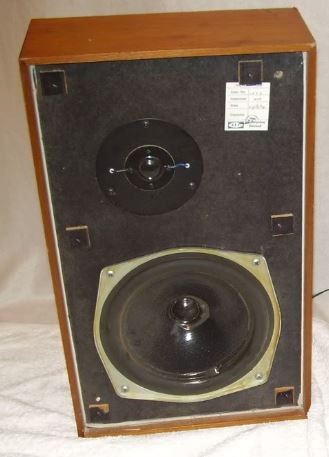

The vintage KEF104 series loud speakers still command a lot of respect today despite its age and simplicity in design. They have been many music lovers’ favorite speakers, and will continue to be much loved.
These 70s speakers have come of age and parts are no longer supported by KEF. If the speakers have spent time in humid conditions, it would require a complete overhaul for sure, after 30years in service. The crossover needs to be checked for component accuracy. And the drivers need to be checked for the correct mechanical and electrical properties.

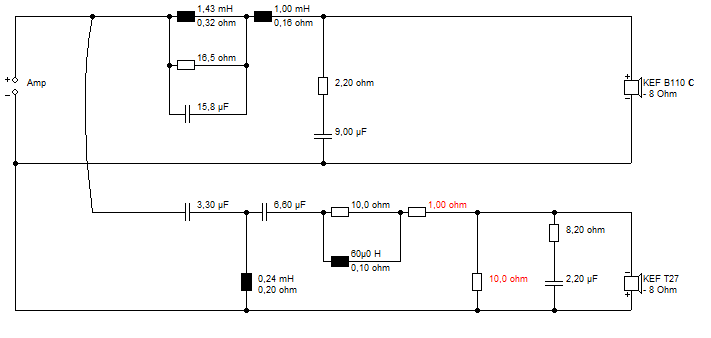

This is the KEF 104aB crossover.
The introduction of a 0.6uf MKT type cap at the high pass, will result in a snubbing effect at the 1.1khz region, thereby attenuates the natural resonances of the T27 driver. The T27 will start to exhibit a falling SPL above the 10khz region, so the introduction of a paralleled 10uf with 3R combo will boost the output above 10khz, and flatten the resultant measured SPL.
As modern caps have lower series resistance (low ESR), this can be compensated by a very small series R, so 3R in the high pass section can be selected to measure 3.1R or 3.2R to retain that damping effect. The value printed on the component may not be the actual value of the component.
The 0.3m inductor is realized by an air cored inductor with only 0.3R dc. The original ferrite core measured 0.55R dc. The resistance of the inductor determines how deep the attenuation of the 1.1khz notch would go. At 0R the attenuation will be close to full attenuation, ie, a short circuit. However, in a real component, there is always some resistance present. It is good to use MKT type for the 0.6uf cap that has a certain series resistance.
The choice of series inductance 2.7mH needs a low series resistance and low magnetic hysteresis. Ideally, an air cored inductor will have the least distortion as there is no core saturation. However, it is hard to find one air core inductor that gives 2.7mH and lower than 0.5R in resistance. The Mundorff Alconit or ferrite series offers a coil at 0.38R with much lower distortion at high current (high current wire).
The 0.6mH is bypassed by a 10R resistor. An air core unit with 0.1R is good choice.
The simulation of the 104aB voltages with consideration of parasitic properties of the components is as follows.
At ~1.1kHz, the voltage is snubbed and prevent the T27a from seeing the offending frequency. Due to the drivers own SPL responses, anything below 1.5khz will have very little output.
At 3kHz the knee kink as in the case of 104, is removed and the transition smoothed. This would make the speaker sound less intrusive.
The B200 transition is also smoothed near the 2-2.5kHz region. The 2.5kHz region determines the perceived sound quality of the speakers.
At 2.5khz, the summed voltages appear to be smooth and no exaggeration between the 2.5khz to above 3khz. This is a marked improvement over the 104 crossover.
The boost above 10khz for the T27 remains. The output is similar to the 104 crossover.
The analysis shows that the KEF 104aB crossover is tweaked to suit the T27a characteristics. KEF's acoustic Butterworth article might not had elaborated much in these technical details. The snubbing effect appears to be a KEF special. This same designs appears in later KEF models such as the Carlton series.
As such, it is not advisable to replace the T27a with any other driver without due consideration of the high pass circuit design. It would be better to source for a pair of used T27a (measured at 6.5ohms dc resistance) than to put in a pair of Seas or Vifa unit (resonant points can be anywhere from 900Hz to 1.2kHz, and different response curves).

104aB Tweeter leg
The 3.3µF 0.3mH 10µF is a classical third order high pass filter (The 104 filter) to that the 0.6µF cap was added to tame the hump at 1 kHz and the 3Ohm/10µF combo to boost the range above 10 kHz. How does this work with slightly different components in the crossover and a tweeter with 40 year old material?
For the tweeter section I have three question
1. What does the 0.6µF do for the crossover?
2. Does the 3Ohm/10µF do anything or can I remove it.
3. Can the 0.6µF be replaced by a parallell resistor in the 15-33-47 ohm range
Measurements Dayton Omnimic 0.2 m distance on axis.
The tweeter is flat on top of a baffle that is not flush mounted, just adding some masking tape around the edge of the tweeter removes the dip at 6-7 kHz so there is gains to be made.
A steep slope of 30 dB octave below 3.5 kHz
The 0.6µF cap does help to keep the slope steep removing it (Yellow) shows this
Orange line shows the effect of removing the CR booster.
Booster effect with a more expanded scale
Perhaps to some extent, however it also boost the >10 kHz a couple of dB a good thing. It also boosts the 3-4 kHz range 2dB that may be a good thing or not depending on the integration with the bassdriver.
the 0.6uF cap , and other results ...
nimo_jon and DrBoar ,
did you use an actual 0.6uF cap for the aB modification ?
or one of the commonly available 0.56uF or 0.68uF caps ?
If you used a 0.6uF cap , please post where you obtained these from ?
I am thinking of using two 1.2uF caps connected in Series , as that reduces to 0.6uF.

I used 0.22µF caps, three in parallell, that was as close as I could get.
Second graph shows
Black standard 104aB crossover
Yellow with the 0.66µF removed and a more shallow slope below 2 kHz.
Orange is with the10µF/3Ohm removed and it does nothing in my measurement as the black and orange is tracking each other well.

Hello DrBoar ,
There are 0.15uF Polypropylene caps available in some brands ,
and four in Parallel would sum to 0.6uF ,
though I'll probably use two of 1.2uF in Series to reduce to 0.6uF.
In your Graph 3 in #5 , the Expanded Scale does show sufficient difference in the lower treble to be audible.
My question was about Graph 4 in #5 ,
which resistor is the the Yellow plot and which resistor is the Red plot ?
For SEAS H087 , I would measure its Frequency Response and compare it to the KEF SP1014.
I think the SEAS will be higher output in the low treble than the SP1014 in its midrange will be after a crossover to the SP1014.
Next I would calculate an L-Pad pair of resistors for around the H087 to reduce its output ,
then I would connect a capacitor in Parallel with the Series resistor of the L-pad , in a chosen capacitance to allow the upper treble through unattenuated.
That could leave sufficient treble above 10kHz from the H087 for similar output with its lower treble.
You may get an almost flat response , and if may match the output of the SP1014 after crossover.
Then you will not need a super-tweeter
Are your plots in #7 for the SP1014 with no filter in Black ?
and with filter in Red ?
or is the Red an Off-Axis plot ?

In my book it works as advertised even with 3x0.22 as it gives far better tracking to the 18 dB slope
As it really does not sort out the big difference in output levels in the two octaves 5-10 kHz and 10-20 kHz, minor changes does not interest me.
My bad, the red one is with a 10 Ohm resistor and the yellow one with a 10 Ohm resistor and the 0.6µF cap removed. (15 and 47 Ohms gave smaller changes than the 10 Ohm did so they are not included)

Red no filter on axis, Black with filter on axis. At the very bottom of the graph well below the main panel there is a legend of sorts. The naming of the lines is a bit condensed and cryptic (With Omnimic you save each measurement as a separate graph file. After emasurements you open an empty graph and import as many graph curves as you want, the curves are named according the the name of the file containing the original curve. In my case as I run the program on Macbook typing names is hard as things like = -+ is different on a win keyboard than the mac keybord so my filenames and hence curve legends tends to be very short and cryptic)

Hi there!
I found ONE speaker of this KEF Model 104aB (without the tweeter!) at the street and took it home (picture below):
I'd like to recap it using your x-over design, but also I need to know if the original tweeter is a 8 ohms.
I have a couple of tweeters. One is a Vifa 8 ohms of 95mm diameter, and the other is a Visaton 8 ohms of 104mm diameter.
The Visaton seems to be stronger, but the Vifa is, to my ears, nicer.
So, can one of them be used or replace the original one?
And VERY IMPORTANT, too: the value of the fuse and max DCv of capacitors!
Thank you very much and great thread!

Gooodemorrgen
The impedance of the tweeter is not just a series R, you need to consider the L and C. More importantly, you need to know the sensitivity of the tweeter.
I used a Seas 22TAF to replace the fabric dome tweeter.
http://www.diyaudio.com/forums/multi-way/192077-kef-carlton-iii-resurrection-seas-22t-af.html
In theory, you can use an R-R attenuation to match any tweeter that is more sensitive to use on the original cross over. But this needs some investigation both on calculation as well as listening.
Please read the Carlton mod first. I do not know the tweeters you listed, but will be good if you find out their specifications first? Sensitivity is key.

I have acquired another pair of KEF 104aB. The set was in a very sorry state. Cabinet disintegrated with some location turned in powder. One T27 fried. Two B200 surrounds started to flatten at various locations. Voice coils rubbing against magnet housing. The humid weather in Singapore was eating the speakers up.
What I am doing now:
1. Restoring the poor cabinet with putty, wood and new layer of real-wood veneer. Added brace behind the front panel for the woofers. Ready end July 18
2. Replaced the voice coils in both T27 with new replacement coils from France (EvilBay) and refill with new ferrofluid.
3. Replacing the B200 with new replacement rubber surround from Simply Speakers. Realign the voice coil to center. (I may replace the other B200 as well)
4. NO MORE PASSIVE CROSS OVERS @@!
I will be trying out a new Linkwitz–Riley active cross over. The Butterworth crossovers have a +3dB peak at 3kHz crossover frequency. Linkwitz–Riley will be flat, and less interferences at on axis listening positions. I am using a cross over board to feed two class D amplifiers (can adjust gain for the tweeters). The active cross overs are really cheap (USD$50) from Evilbay.
Should complete by end of July 18. Stay tuned

- KEF 104 to KEF 104aB mkII with SPICE
