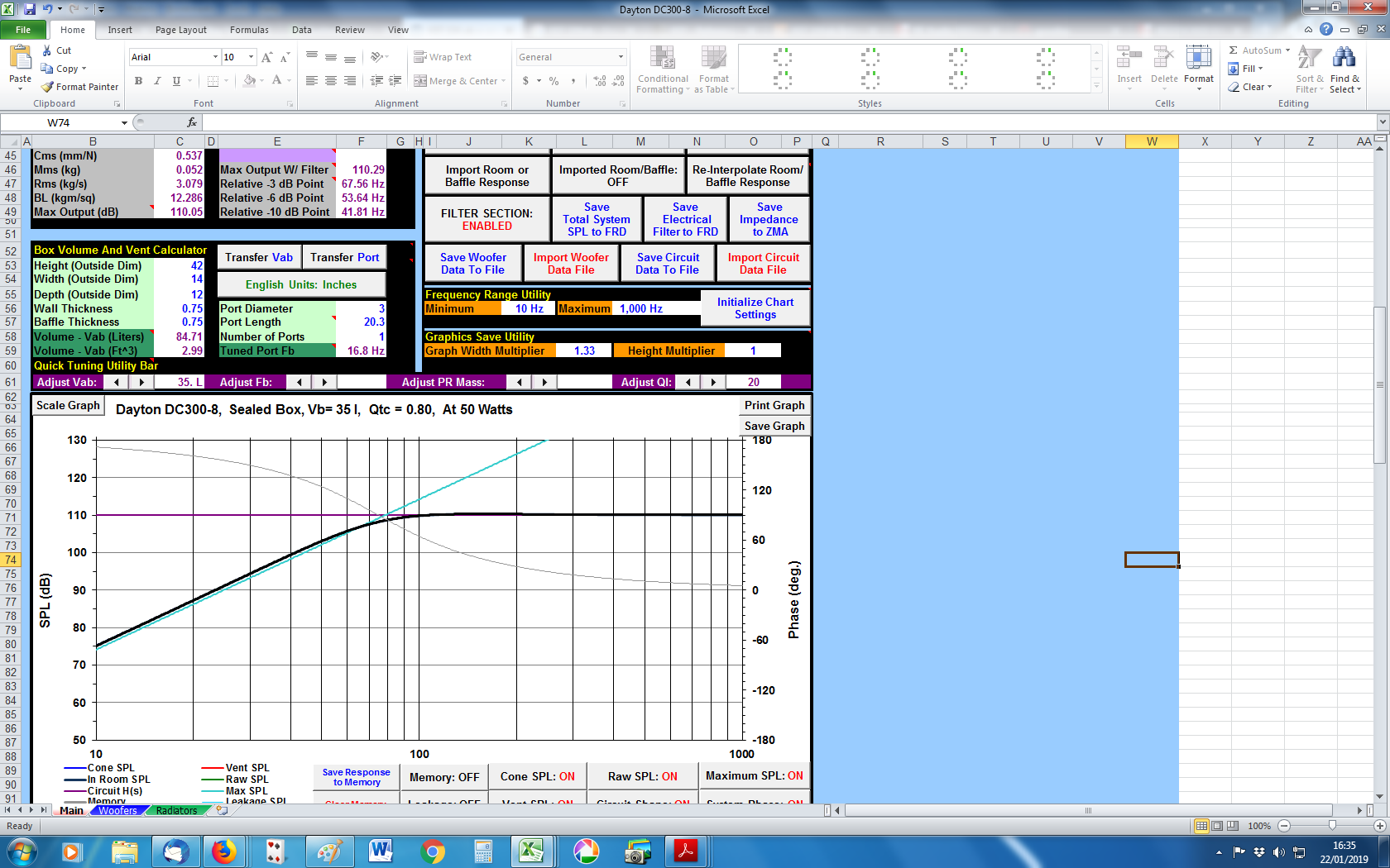

A pair of 12 inch woofers in small sealed boxes would be the way to proceed. Can you split the feed from the Dayton plate amplifier to 2 separate speakers?
A small separate enclosure for the amp perhaps? There is a small Dayton woofer I really like that should work
I was playing with it this morning as I have a quad of them on hand for a frugalphile project

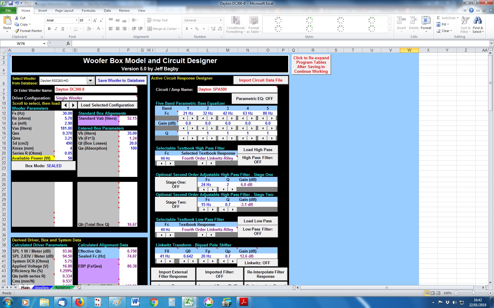

55 watts in a 35 litre sealed box looks reasonable although I would stuff with FG as a matter of course
