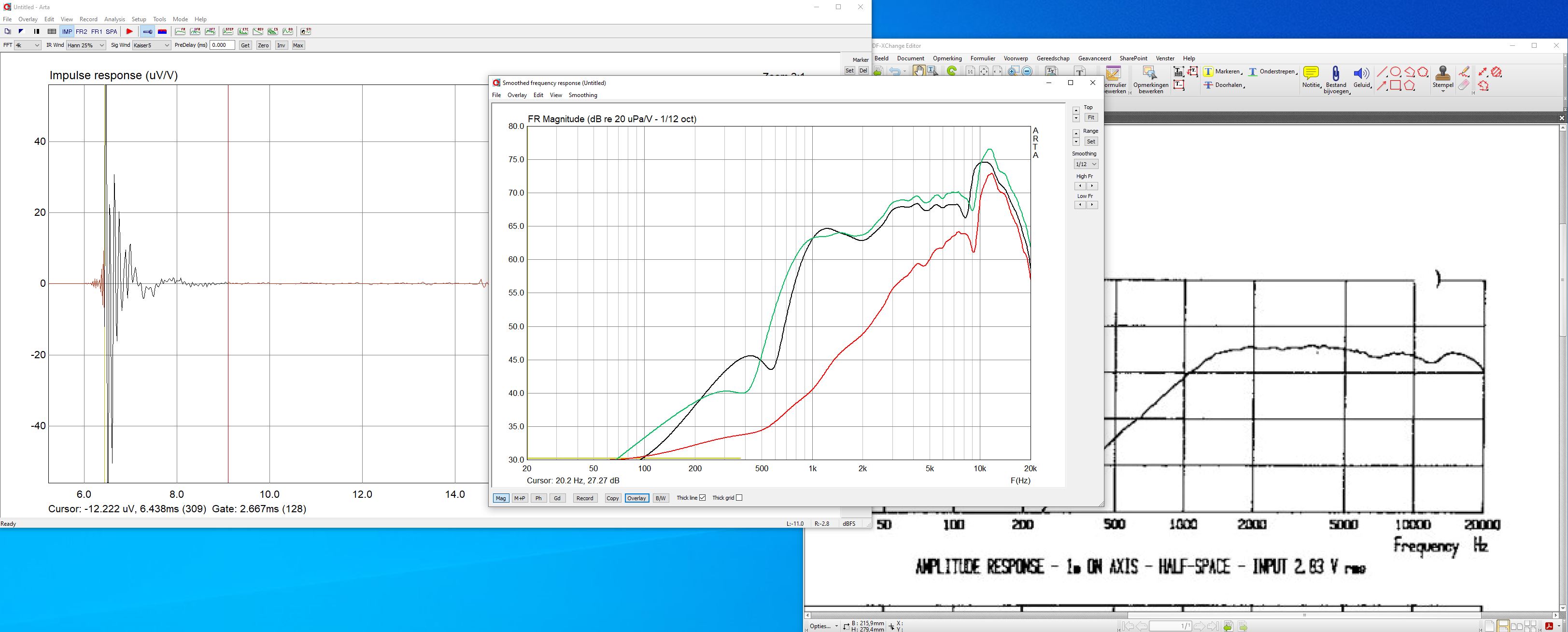

attached measured response of both tweets with ff removed (green, black) and with ff (red). does not look like what it should be
The red graph shows the behaviour of a jammed VC or dried FF but a much too high viscosity of the FF behaves the same. The measurement from KEF and your black and cyan (green-ish) measurement differs in 3 things:
1. the grid of your response is 5dB/line while the KEF datasheet is 10dB/line, which flattens the curve. The KEF is also smoothed.
2. In comparison it shows quite the same characteristics, the peak on the top end is higher on your measurement, that's likely because of a difference in measurement enviroment and tolerance on the mic, preamp, missing or just generic calibration file. Maybe you've used a class-D amp for measuring, which would explain the moderately rised peaks too.
On the datasheet the peak is ~5dB, in your measurement it's 6-7dB, that's well in the normal tolerances. It doesn't matter much because off axis it very quickly drops in level and in that range the human ear isn't very sensitive to linearity and the difference is likely just tolerance or just different measurement enviroment and chain.
3. The lower spl below 3kHz is largely because KEF measured the tweeters in a large standard baffle while you measured them either in the box, in the unit baffle or completely without baffle. With a large baffle the reflection on the edge of the baffle boosts the lower frequencies, the baffle step frequency goes up with smaller baffles. A high viscosity of the ferrofluid could cause that too but will change after the speaker played for a while (warming up the oil).
What's not okay is the impulse response. For a high quality soft dome tweeter that's a pretty bad response. You should measure the spectrum decay and distortion, from that response there will be extremely likely serious ridges in both. It will also show on the impedance response if you can't do the distortion measurement.
Reasons are probably a decentered or rubbing VC, too high viscosity of the FF or some dirt in the gap. To verify that remove the FF and measure again.
At that age it's also possible (though not likely) the VC/dome glue seam came partly off, you can maybe see that from the side with a lamp from the back of it.
BTW: Without the FF the tweeter will show a better resolution but the impedance response will be different and the crossover has to be changed.
