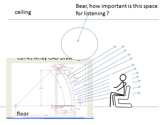

If the tweeter array starts at the floor level, and is 2/3 the line length, will the floor reflection only add SPL near the floor/seated positions? I would GUESS so. As my design will be used for Home Theater only, standing height listening is of low importance.
Same question as Bear, just asked differently.
Please comment on my thoughts.

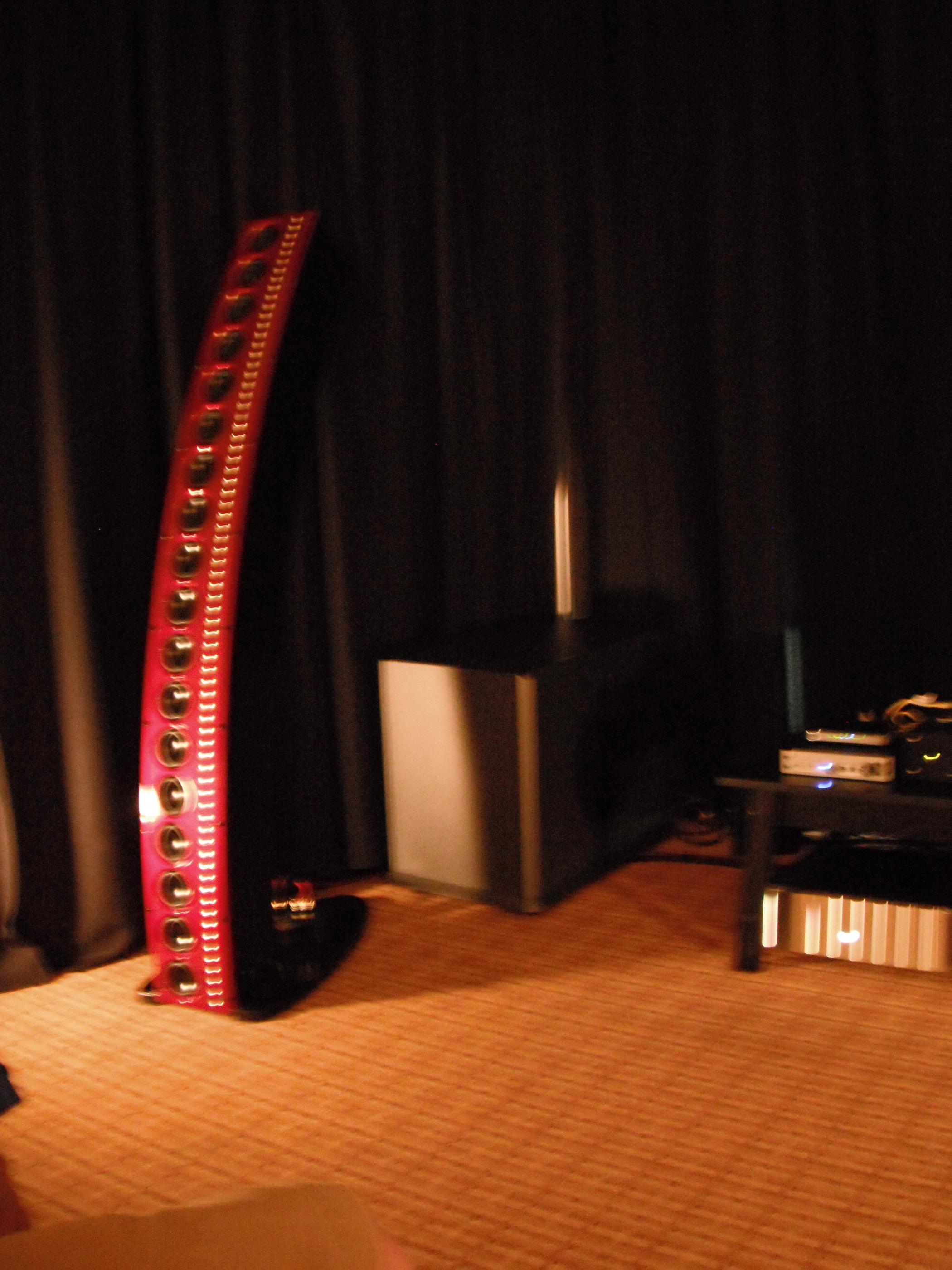

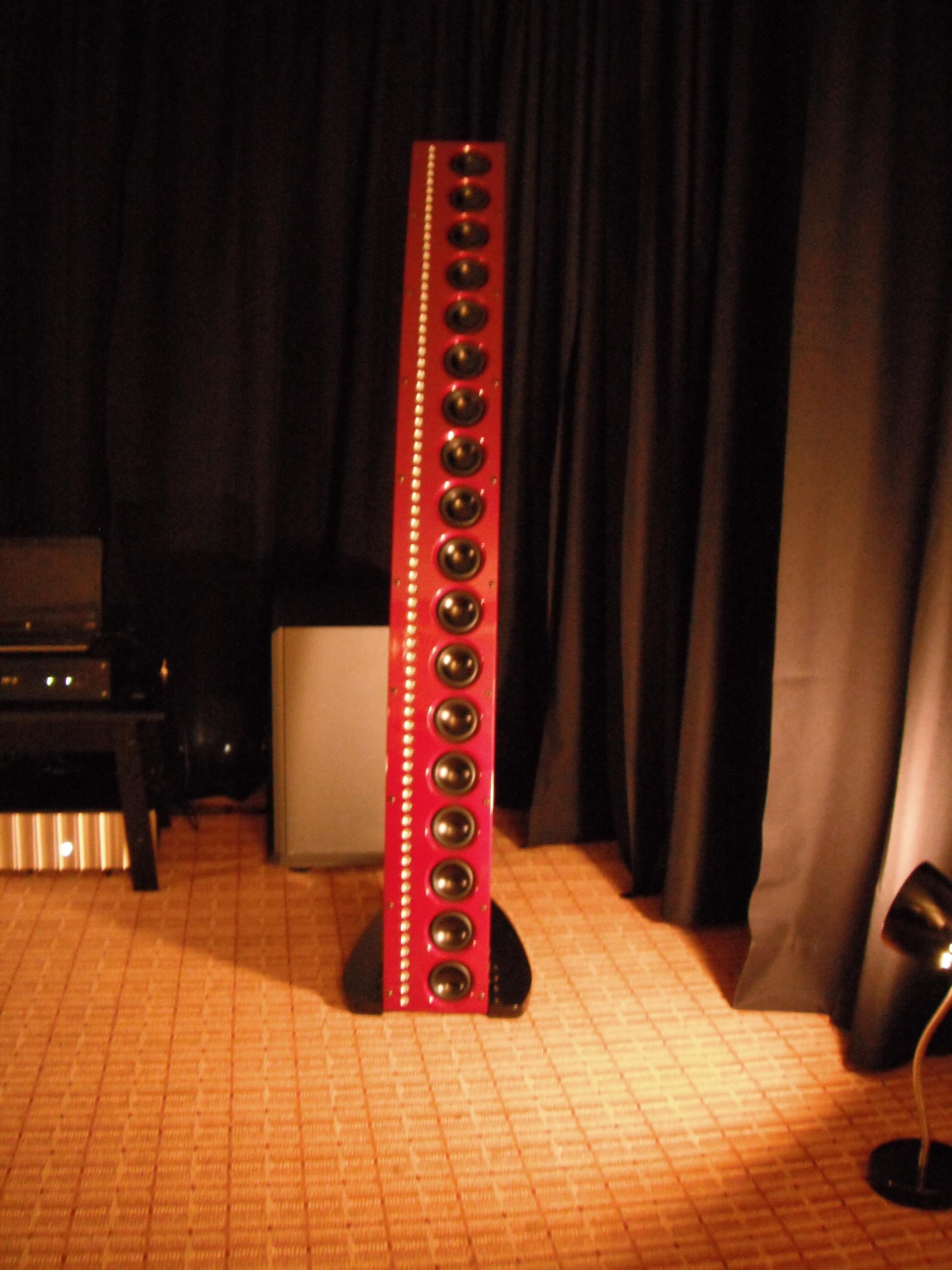

I was at rocky mountain AF, and Keele runs them with subwoofers
sorry about the bad picture quality...

Without shading network, the speaker is quite similar to a straight line array. Exhibiting rapid variation and undulation of sound pressure with position and lobing.
Shading is much more important then curving. Curving is used to avoid beaming. I think it's unfair to call this speaker a Keele line array. They are vastly different in regards to the polar response.
wow omholt, some pretty far out bs in this threat, I better ask moderators to remove the threat
I have noe intention of being rude, but what I wrote is the fact. It's well documented.
I don't see a big problem of a title being off, but it's ok for people to know that this isn't a Keele CBT design. I'll leave at that. The papers are out there for people to read and find out for themselves.

Hi Bear, here is a little picture a draw to demonstrate where is good coverage by tweeters. You said they go only to the half of an array, no they go to 2/3rds. There is 16 midranges and tweeters go to ~mid No 10. Picture better 1000 words.
