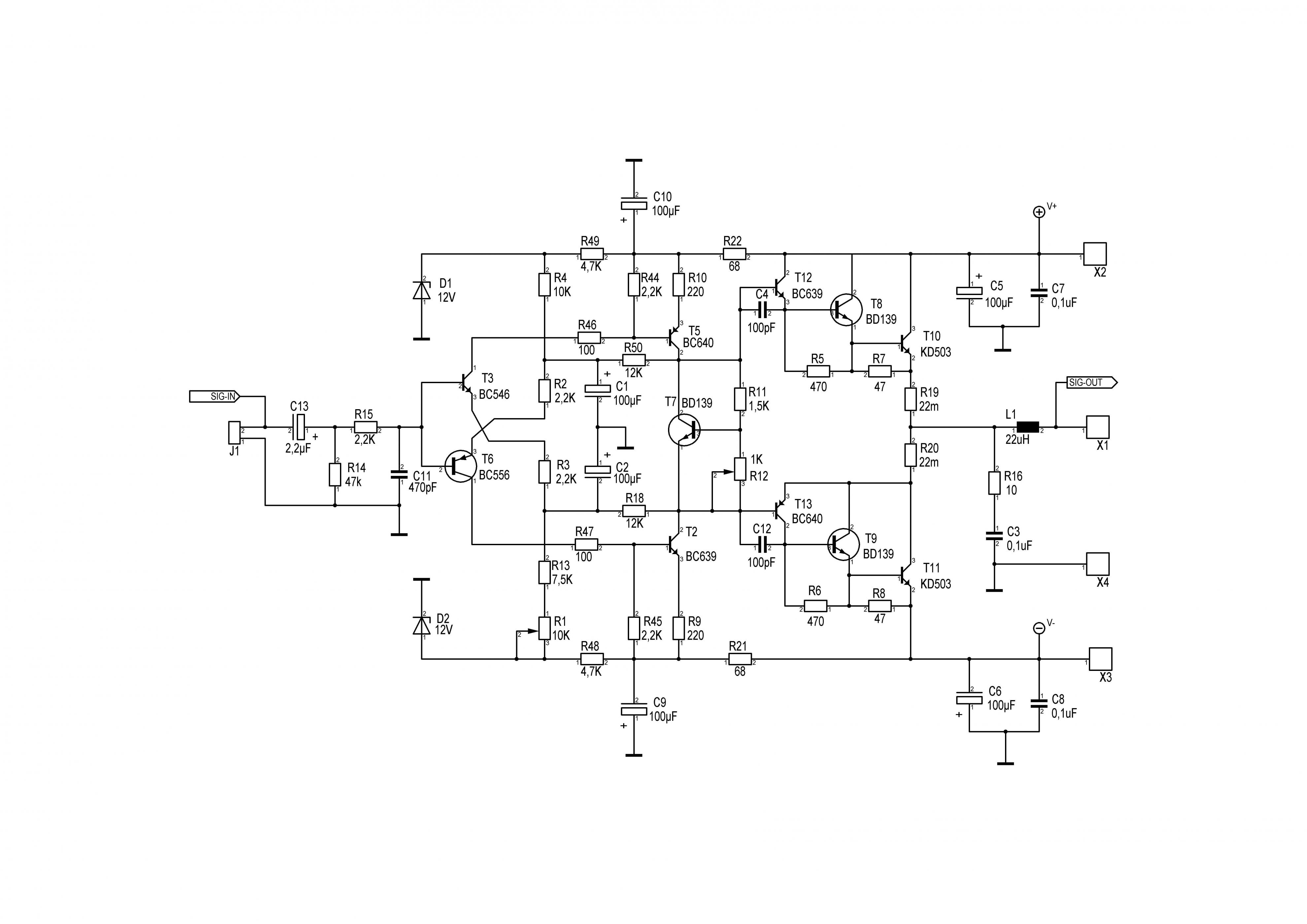

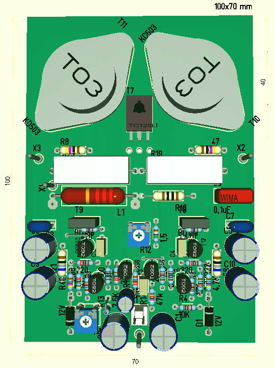

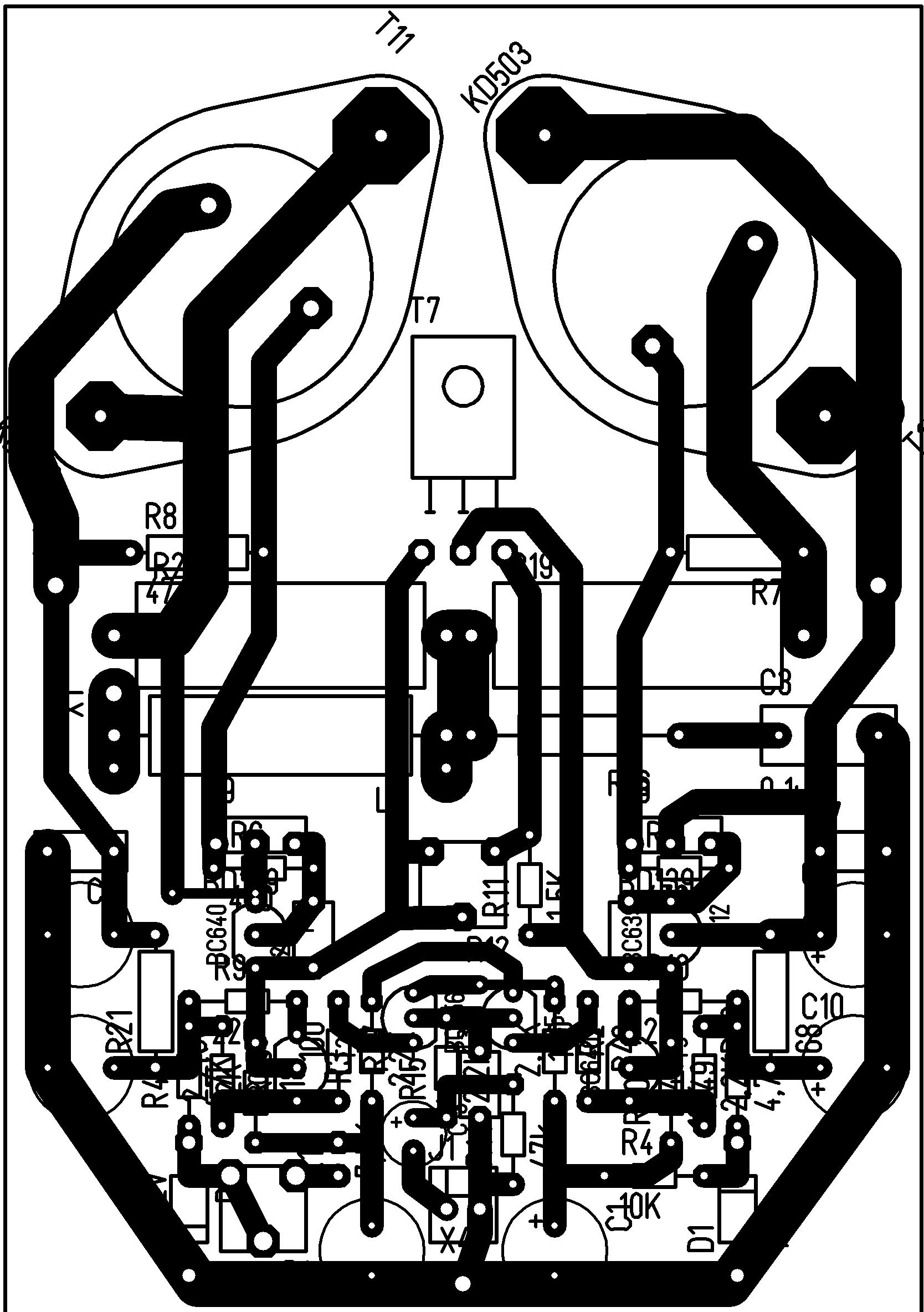

You can try this one - my version of Hungarian B5 power amplifier.
Easy to build, good sound quality.
