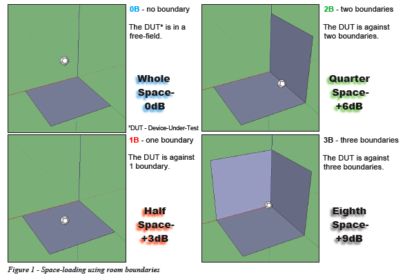

An anechoic environment is (should be) equivalent to "free space", no boundaries.
The KEF KC92 DSP EQ is configured for for in room use, six boundaries.
Ideal 1/8th space boundary gain is +18dB at very low frequencies in an enclosed room.
If +18dB were added to the Corner(green trace) response, the measurement would be very near the KC92's specified response of -3dB at 11Hz, certainly within expected measurement deviations due to room dimensions.
This article goes in depth as to how room boundaries affect low frequency response:
https://www.prosoundtraining.com/2011/08/29/how-boundaries-affect-loudspeakers/
The above graph using the Bose MB4 (4x5.25", specified at +/-3dB 45-310Hz) demonstrates how the boundary gain primarily increases low frequency.

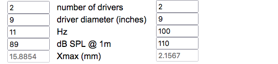

As an adjunct to the above figures, consider a Dayton Audio UM18-22 18" Ultimax DVC 2 Ohms/Coil driver in a 60-litre enclosure. If we apply a Linkwitz Transform filter to this closed-box enclosure, we can achieve the following response. The −3dB point is 11.1Hz, and the SPL in the passband is 95dB. At 10Hz, the required input power is around 800W, and the driver excursion is 11mm. An 18-inch driver has 2.0x the radiating area of two 9-inch drivers. This closed-box alignment is only −0.1dB at 20Hz! At that frequency, it requires 80W of input power to get 95dB SPL. With a 2kW amplifier, this subwoofer would potentially offer a great deal of low-frequency extension at moderate listening levels in a small-to-medium-sized room.The drivers used in the KEF KC92 have at most ~16mm excursion, output could be equalized -3dB 11Hz to 200Hz, but output would be no more than 89dB at 11Hz with no room gain.
