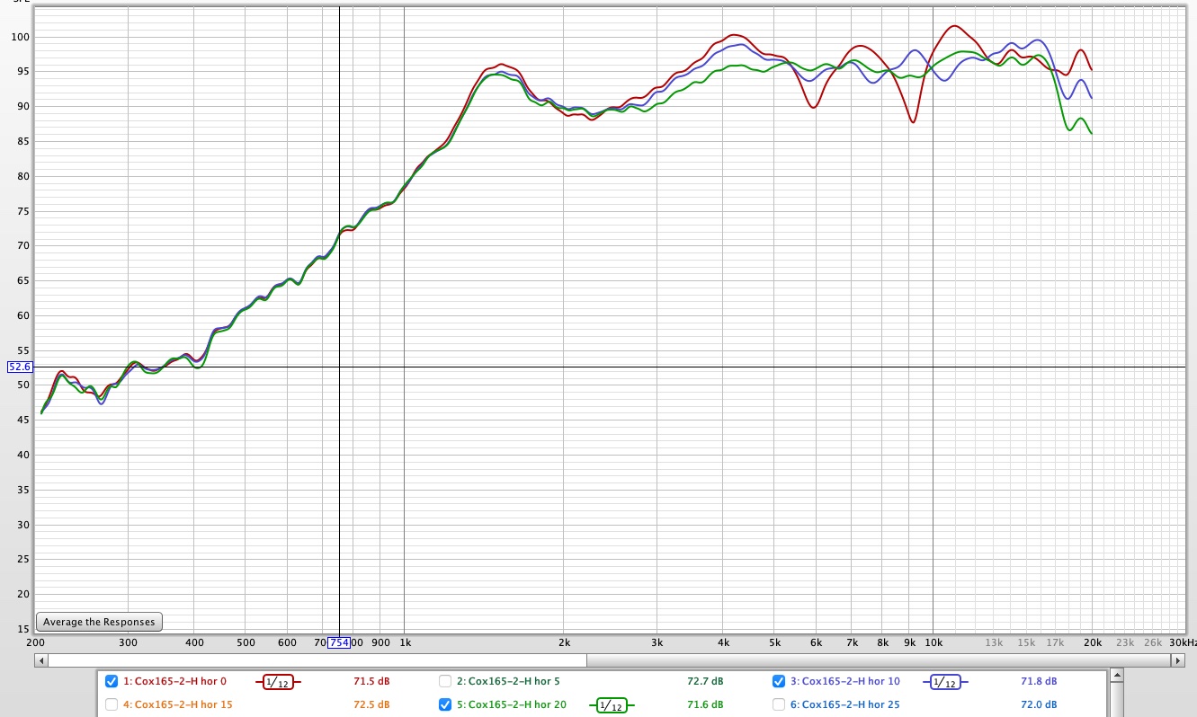

I have bought 3 Cox165 for a new LCR front. I'm working on a first prototype, but must say that measurements in a simple 10 l closed box a far from the data sheet measurements. On axis here are a lot of notches and only 10deg off axis they are becoming more linear. I think the problem is the lines tube with no expansion from the compression driver to the cone of the bass driver. It seems they get some resonances in that tube.
Attached: frequency response for 0,10,20 degrees

^ typical for coax ( any type i've heard/seen/measured).
Yes off axis the issues tends to be less obvious, which is nice as they ( coax) are not meant to be listened on axis ( Tannoy for example are usually meant to be listened ~15* off axis).
krivium, are you referring to the dips @6kHz and 9kHz? If so, you may appreciate the KEF coaxial drivers are almost completely free of these anomalies. The transition of the dome (tangerine structure) into the cone is far superior over other 5/6"coaxes.

Yes i am refering to the 6khz and 9khz dip on axis.
I was a bit optimistic ( pessimistic i should say) in saying 'all' coax i've heard as this is not true: the last generation Genelec's studio monitors (8351) doesn't have this kind of behavior, neither the Cabasse coax they used in the 90's and their new range ( La Sphere which is three way anular).

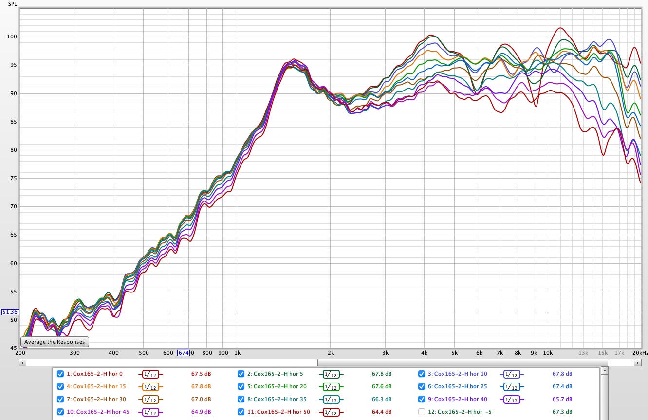

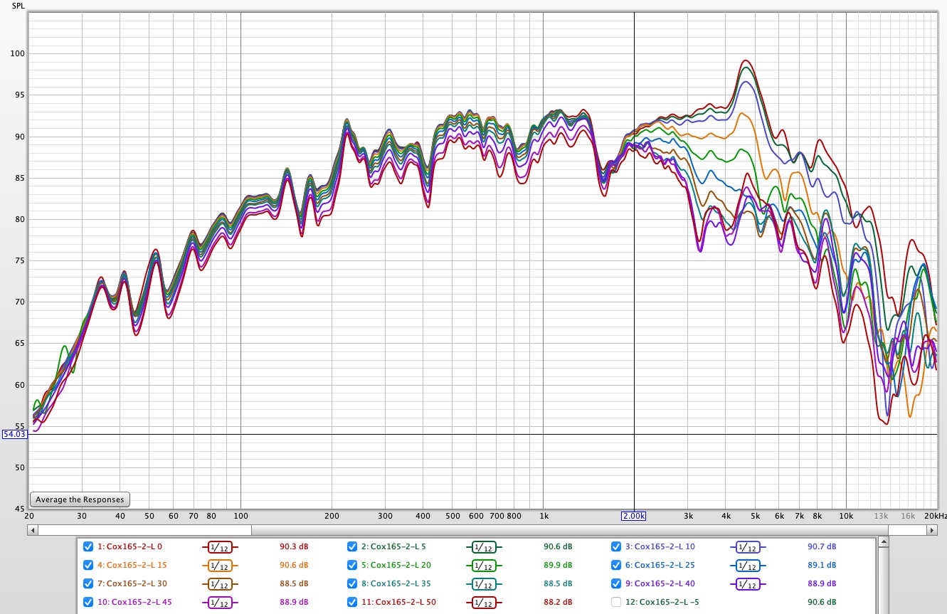

Here are my REW measurements for the low and compression driver part. They were taken outdoors on a 2m stand. The UMIK-1 was at a distance of 50cm. Absolute SPL values are certainly not correct ,but the they are correct as relative SPL values.
I have also made an additional waveguide which makes an extension to the bass drivers flare rate and smoothens things out a little bit, but further investigations and testing are necessary

Im concerned about the severe dip at 1.5k that is no doubt audible

Would you like share some details regarding the waveguide you are using? I was sketching something similar for the smaller cox120 in the neighboring thread.
