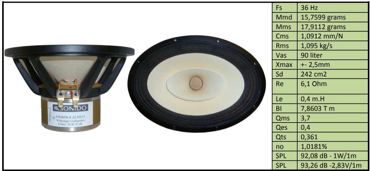

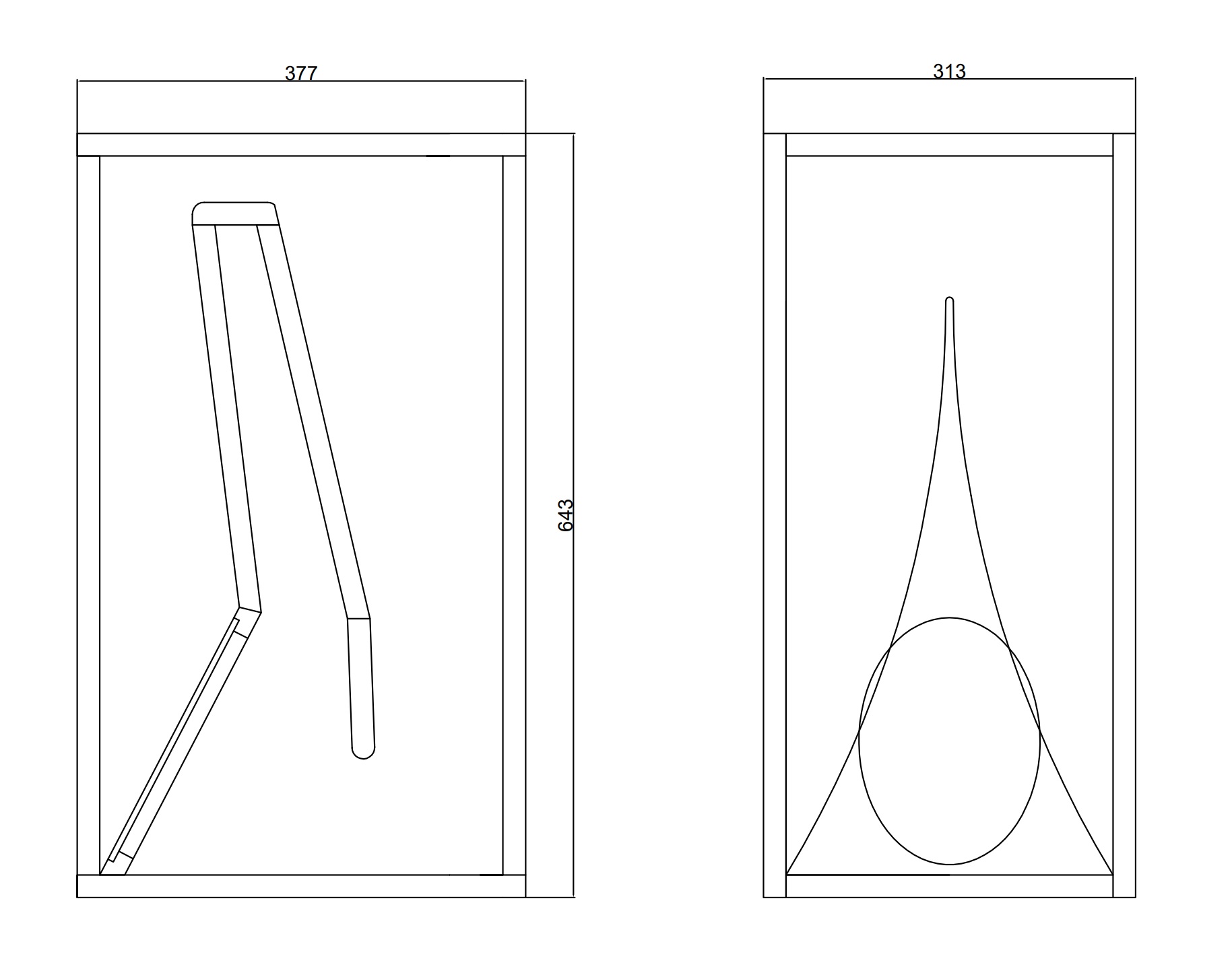

I own Sonido SWR 096 AlNiCo speakers. I'm thinking of making a Karlsonator case.
I have no idea how to choose a case. Which type to take (0.53, 8, 12 or 15)? Size? How to calculate whether the units are suitable for Karlsonator and for which type.
Im asking for help.
TS parameters in attach picture

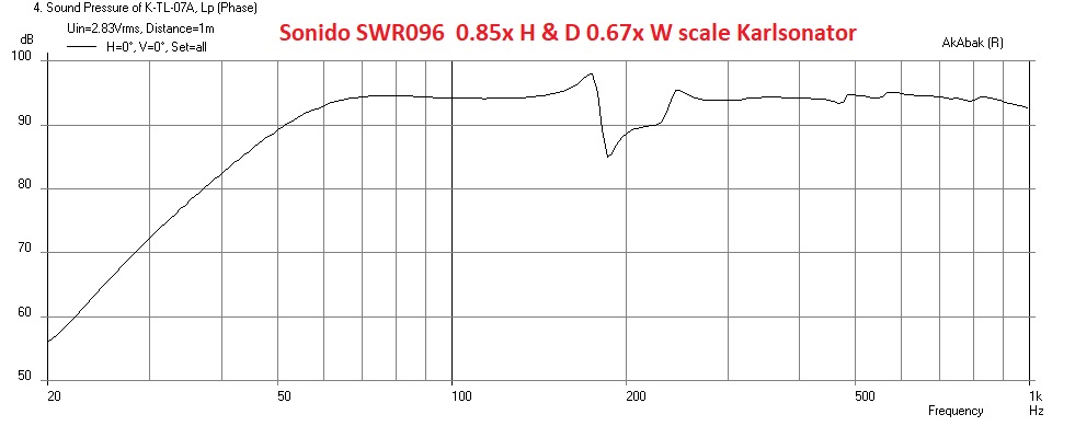

My simulations show this to be a rather large speaker 0.85x scale height and depth and 0.67x scale in width of the original 12in Karlsonator. Here is the predicted frequency response - nice sensitivity of 94dB and -6dB point at 49Hz.
attachment.php
