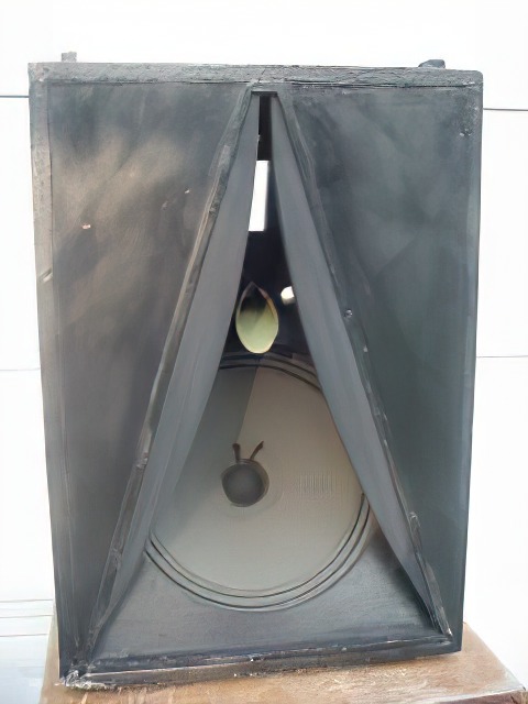

I have an 18" Karlson type with curved upper panel which plays very nice.
Here's a little one with which could use some improvements (don't say pull its wings, etc. 😀)
The recording is analog and of John French so not the cleanest-most dynamic - thing in the first place.
A 10" driver K is about where the power starts. The slotted pipe tweeter can sound very good.
I would assume the focus of the reflector should be "outside" the aperture a bit.

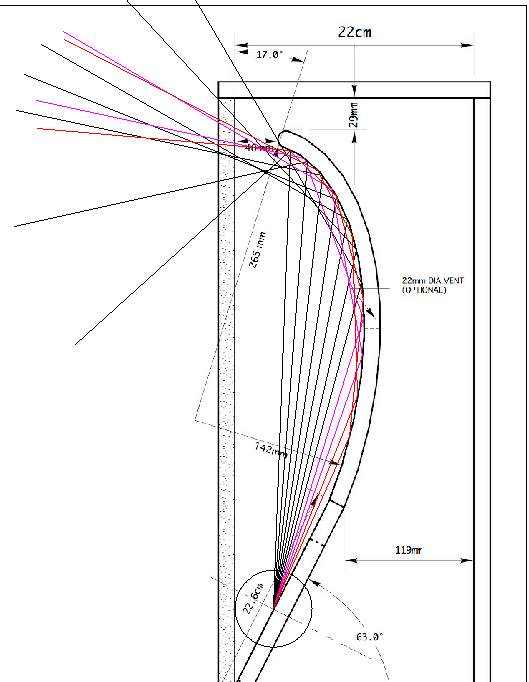

Had to look up what you're referring to, so responded here: Karlson's Fig. 6 Curved Reflector - who here is good at ray tracing ?

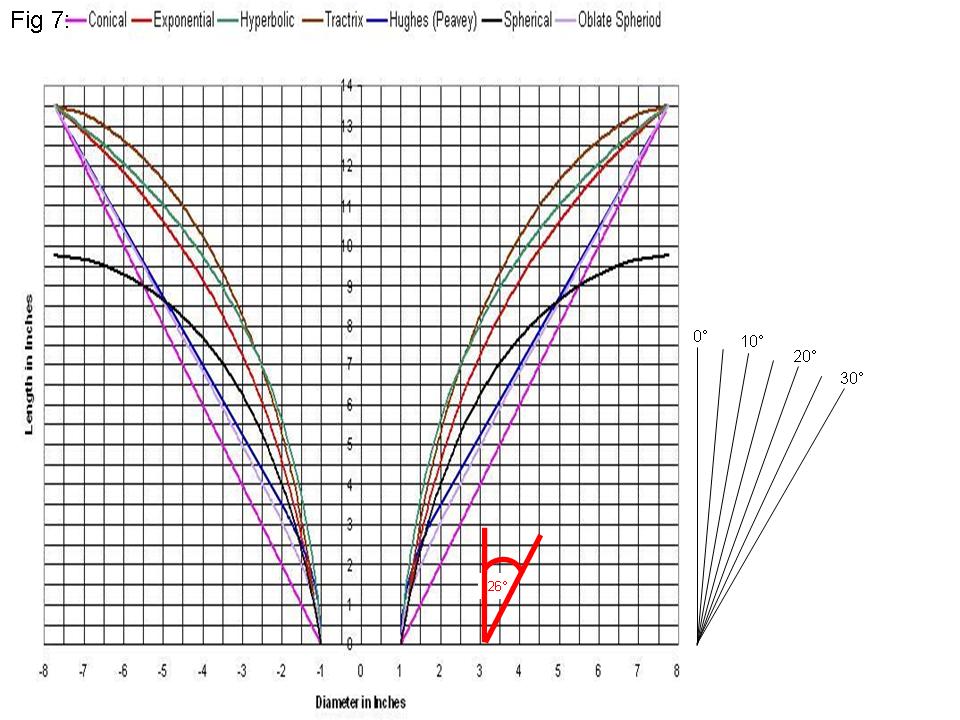

I've tried a bunch of different acoustical reflectors, and these have worked the best for me:
https://www.researchgate.net/profil...g-a-version-of-the-Point-to-Arc-Generator.png

Gentlemen - the WKF ("World Karlson Federation" 😀) needs your input on what "might work" subjectively to focus (in claims) some of the reflections from the upper half of the front out of the box and away from the cone.
Hopefully the curved reflector does not make response worse. (I think it could work both ways - worse if unlucky)
Two and 3 panel approximations of the curve are welcomed as save labor and expense.

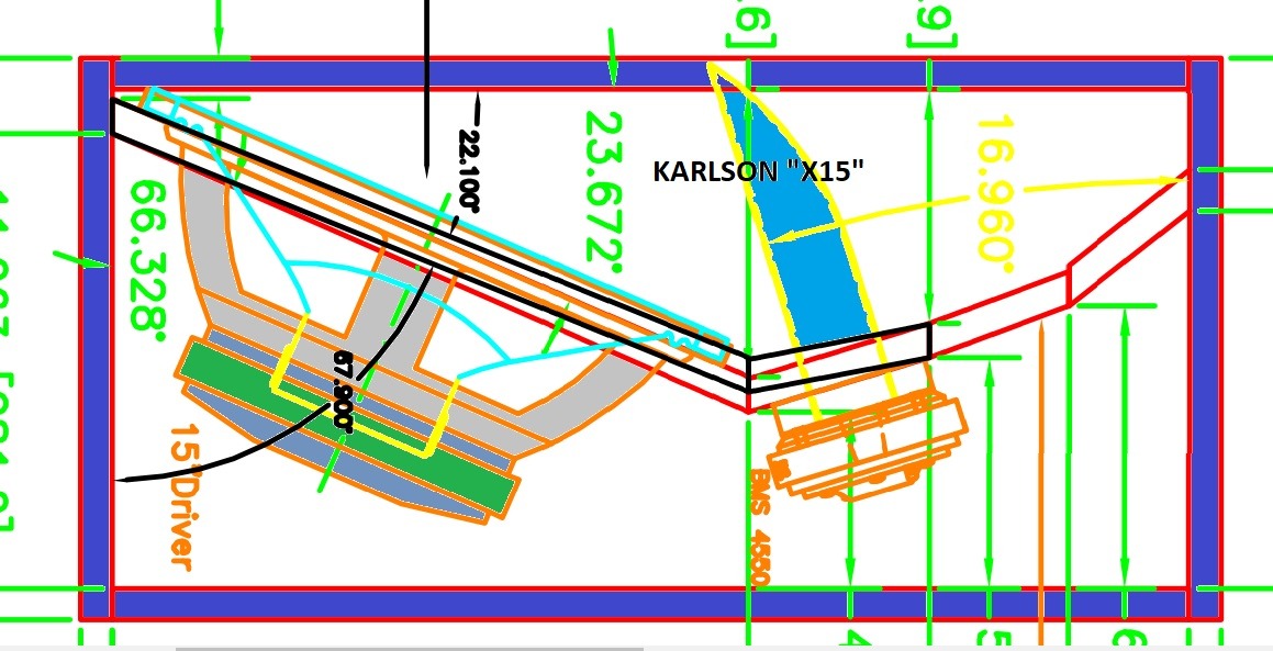

I would like to include a "K-tube" slotted pipe tweeter mounted through the reflector/port panel and would go with a 10" woofer (12" at most w. Kappa12a) and 1.4" compression driver for the K-tube.
The design should be compact - retain some "hit" and punch clearly..
FWIW I could throw away most of the upper chamber so it would be like a mini Metro T15 - or my KUBE12 - that probably would make the low end approach bandpass sims - but it might not sound as cool -
An advanced K-builder likes a taller aspect. Again I think that may or may not work better than the original aspect for a given bulk.

Hmm, if I'm following you, then rather than the original's flare that goes to a very high frequency, truncate it to a ??? Hz 'throat' based on the speaker's baffle step/whatever and start a new horn flare designed for this higher BW, i.e. makes it look like a vertically oriented HR simmed compound horn's schematic since this is what the original was trying to somewhat mimic.
hi GM- - X15's slot in its first half of travel coming down from the top, opened a bit faster than a pure radial arc. That may have been partly for tonal balance and part for clearing the K-tube - although the first X15 tweeter was a wood mini-klam with 3" paper cone driver.

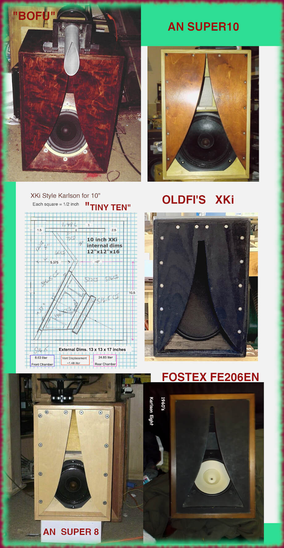

Some of the early French 'Epsilon' designs might provide some inspiration:
https://www.inner-magazines.com/audiophilia/elipson-a-loudspeaker-that-made-new-music/
