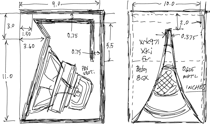

hi AlexyP
Look at XRK's "XKi" thread - here's a post with Eminence Beta8cx
XKi - X's ab initio Karlson 6th Order Bandpass
I think later X revised the vent on this drawing
If you decide upon a driver with known Thiele-Small parameters then
XRK971 can run an Akabak simulation for you to get proper chamber sizes and tuning
I tried to simulate that type made with Karlson K8 back and front chamber but don't know if the model makes any sense

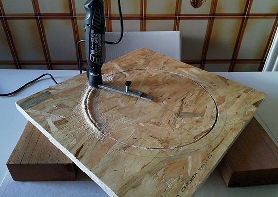

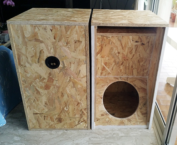

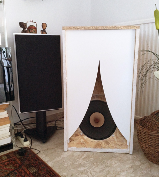

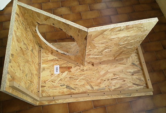

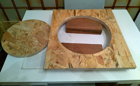

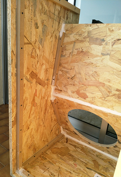

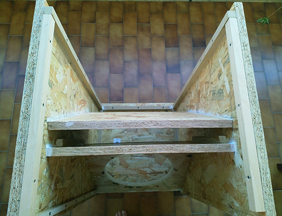

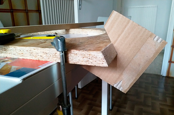

Hi all,
I bought sometime last year a pair of Lii F15, the idea being to place them into a K.
I made it into a Karlsonator.
My idea is to have one single full range and a big box to get big sound at low level.
Once I received the drivers, it was easy to try them into OBs...it was OK but not what I was looking for.
They aren't closed tight for the time being because I wanted to listen and see if it was to expectation....and it is so I'll have to finish them and make them nice.
I chose OSB panel because it is the cheapest thing I could get, plywood here is difficult to obtain and far far out of my budget. But also I wanted OSB because it is heterogeneous which is a simple way to avoid standing inside waves.
I hate damping which I find muffling the sound and here there is none.
Don't ask mesurements, I don't do such thing, I listen then I like or dislike and try various modifications.
All is made with my poor tooling equipment and on my kitchen table for the pleasure of my wife.
It is what I was after, big sound at low level.
But as I have always thought the recordings are essential, much more than anything in the system.
On good recording the thing shine, you have precise sound all over and you can stay there for hours. So I have some music I am not really fond of but it well recorded it become a real pleasure to listen.
But I still have few things to try and of course close it tight once happy and that also could make a slight difference.

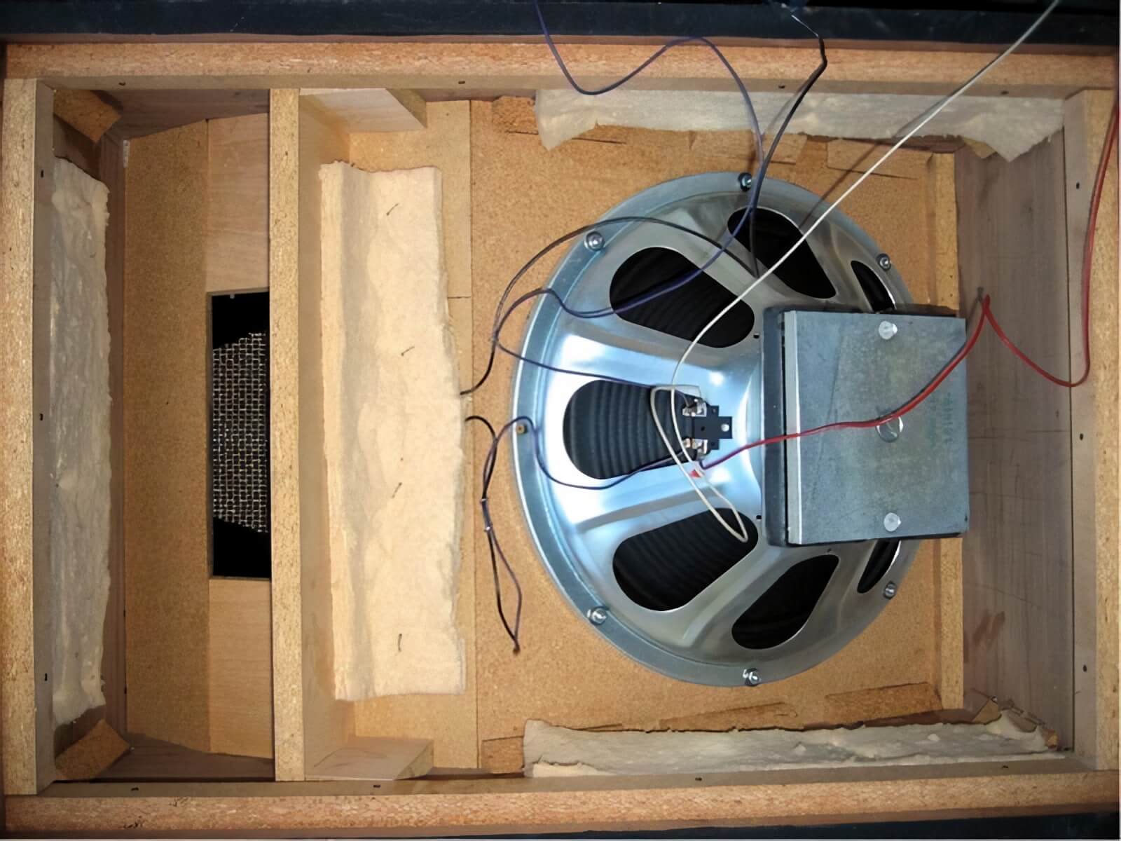

I have just picked up a pair of K15's. One had an unwelcome family inside and they messed up the batting.
It looks fluffier than fiberglass.
Any suggestions as what to use ?
Thank You
Thank You
Melamine scrubber foam pads works great as sound absorber. Doesn’t rot and rodents won’t eat it. Same as BASF Basotect. But a bag of 100 for $7 from China.
