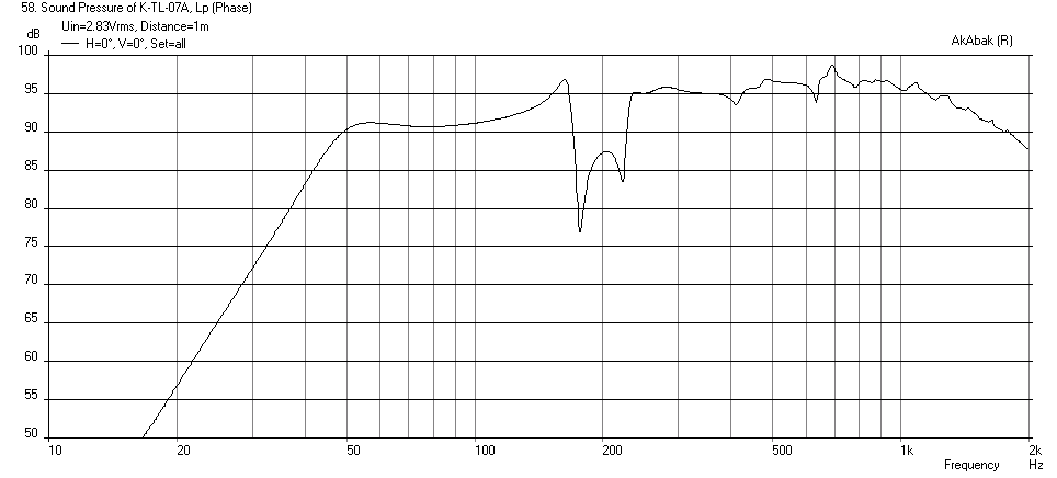

Yes it should work well scaled by 0.9x. I did the sim a while back here:
http://www.diyaudio.com/forums/full-range/239386-karlsonator-8.html#post3575655
I'm going ahead with the Karlsonator K12, but I'm hoping to get some thoughts on one last driver option, specifically, whether or not it will work better than the Beyma 12g125 previously queried. The driver listed below is twice as expensive, so if it isn't an obvious improvement, it probably isn't worth it to me.This driver can work well in a 12 in Karlsonator to get 90 dB efficient bass down to 50 Hz. The HF is so efficient though it will need heavy BSC to tame the rising response to give a balanced sound. Make the box according to the full scale Karlosnator 12 plans but scale the width by 0.9x to reduce the volume if possible - that should still leave enough room for the bezel to fit. Use a 20 ohm + a 1.8 mH inductor in parallel to reduce the HF's to match the 90 dB bass level.

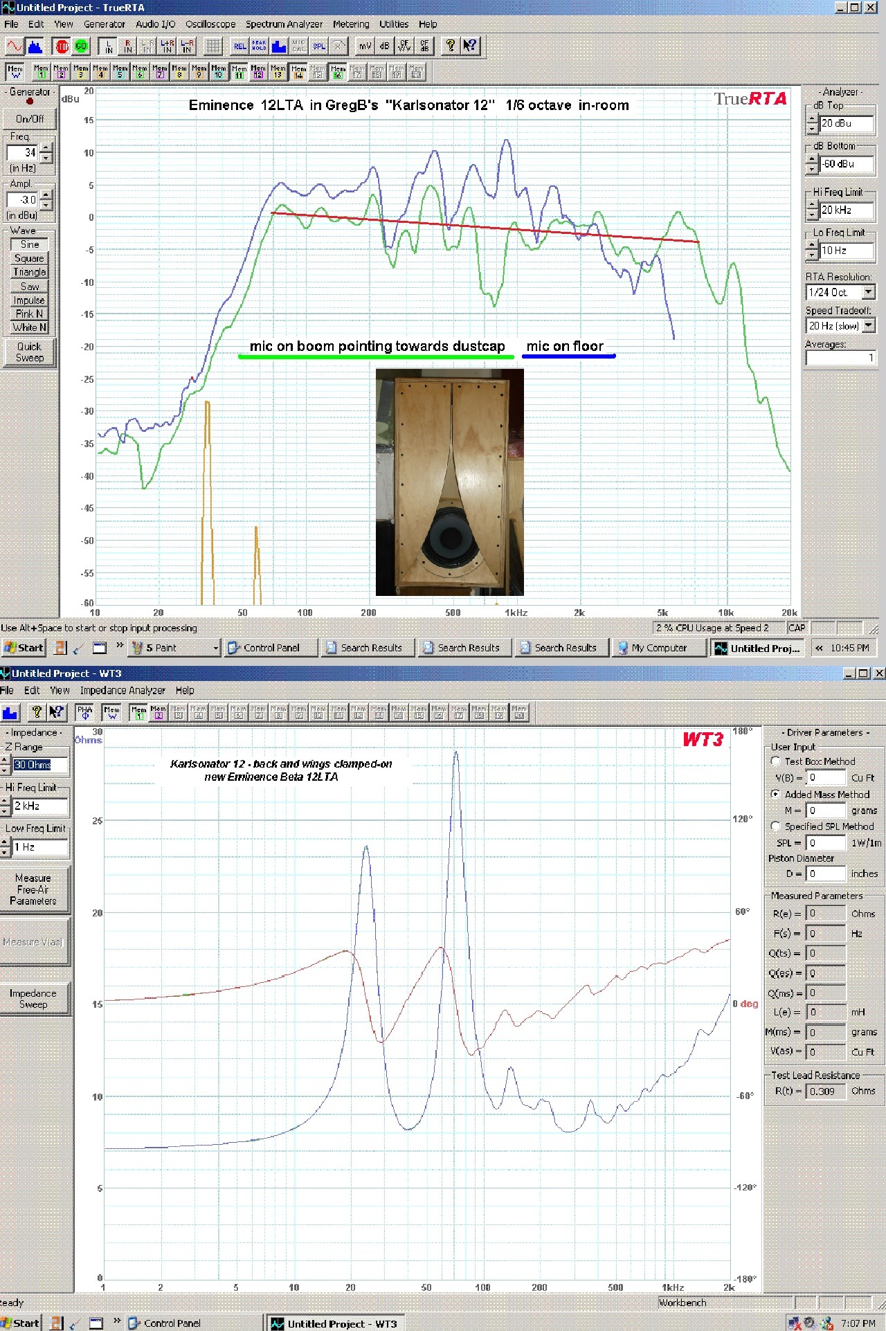

12lta sounds good for what it is and overall sounds very good in the new Karlsonator.

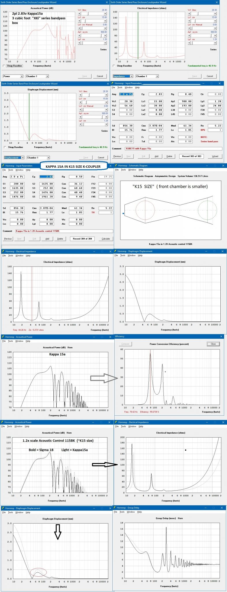

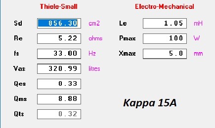

hey X - - do you still have Akabak running for the Karlsonator? If so I'd like
to see what could be done for typical medium mass 15" speakers in K15 or less bulk.
I suspect a nearly cubical XKi would give the lowest cutoff for a given bulk
(sorry about not having T-S in Akabak form - gotta get up early to see a surgeon)
