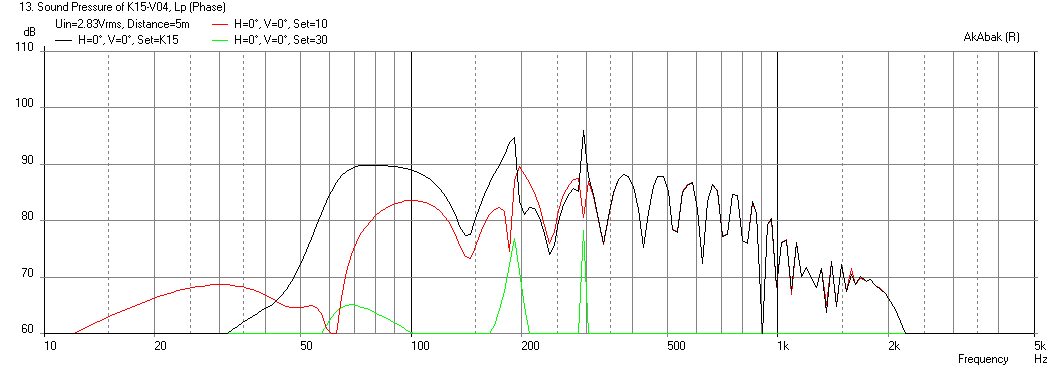

My Akabak model has independent height vs width and depth scaling so I can stretch the box in one dimension only and shrink in another to preserve volume. I also have the Karlson aperture as a quadratic curve fit that can scale in length and width as it is a normalized zero to unity function as the basis function. From there I can apply scaling for the large opening, and the gap can be adjusted with an offset constant. I have already shown that stretching the K15 box by factor of 19/15 improves the bass on the Betsy. Although in that case I actually increased the width and depth by a factor of 16/15 as it seems that the Betsy K had a rather large Qts that benefitted from a lot of extra volume. Is there a K aperture function other than the prescribed table from the 1954 design that I should try? My guess is that it will have little noticeable effect as I saw hardly any difference going from 9 aperture to 14 aperture approximation of the K aperture.

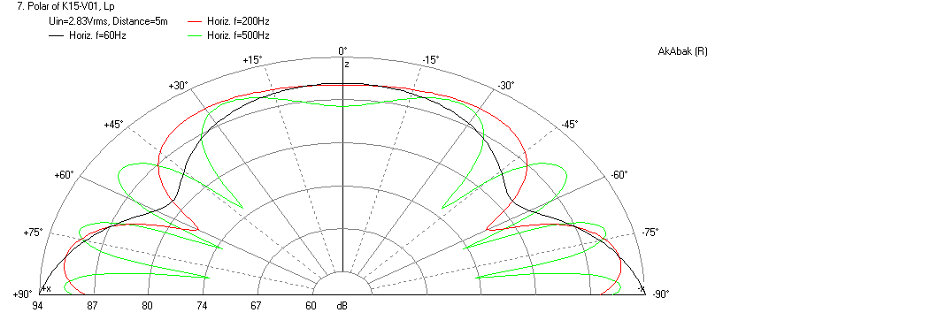

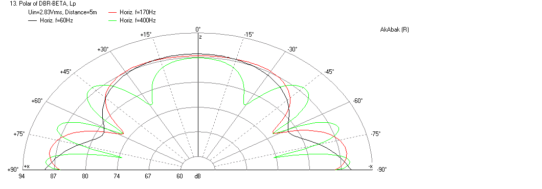

regarding akabak, what do you see in the Karlson horizontal dispersion vs a direct radiator? Carl says K's not only disperse but don't have dead spots on stage like reflex.
The K-aperture certainly does provide improved dispersion. To show the difference, I simulated a straight bass reflex cabinet for a Betsy K and plot the polar SPL at 5 m for 60 Hz, 170 Hz, 400 Hz (selected to capture most uniform frequencies at these 3 ranges. As expected, the lower frequencues 60 and 170 Hz are very uniform and omnidirectional as expected. At 400 Hz though, lobing can be seen and the central lobe is good for a 30 deg cone (+/- 15 deg). Next is a Betsy K in a K15 (1954 with 30.5 sq in vent) at similar frequencies (60 Hz, 200 Hz, 500 Hz). Here you can see that the Karlson aperture produces central lobe that is about 70 deg wide (+/- 35 deg). Obviously, 75 deg is a lot better than 30 deg. I wouldn't say that there aren't any dead spots as you go past 45 deg off axis there are several lobes that will appear to have dead spots at 500 Hz. The same is true with the bass reflex with direct radiator, but it happens at a much smaller off-axis angle. BTW, the 70 deg dispersion uniformity is perfect to couple this with a compression driver fitted with a standard 60 deg wide horn (the kind that fits inside a coaxial driver like the Beta C10X).
So, another reason why the Karlson kicks butt in larger spaces.
