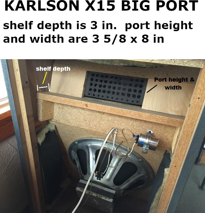

e/ K-slot design:
1/ slot start 0" to 3" from the top
2/ gap width 0.25" to 0.5"
3/ slot area 1.5-1.8x driver Sd
4/ slot width at driver intercept ~0.4x Dd

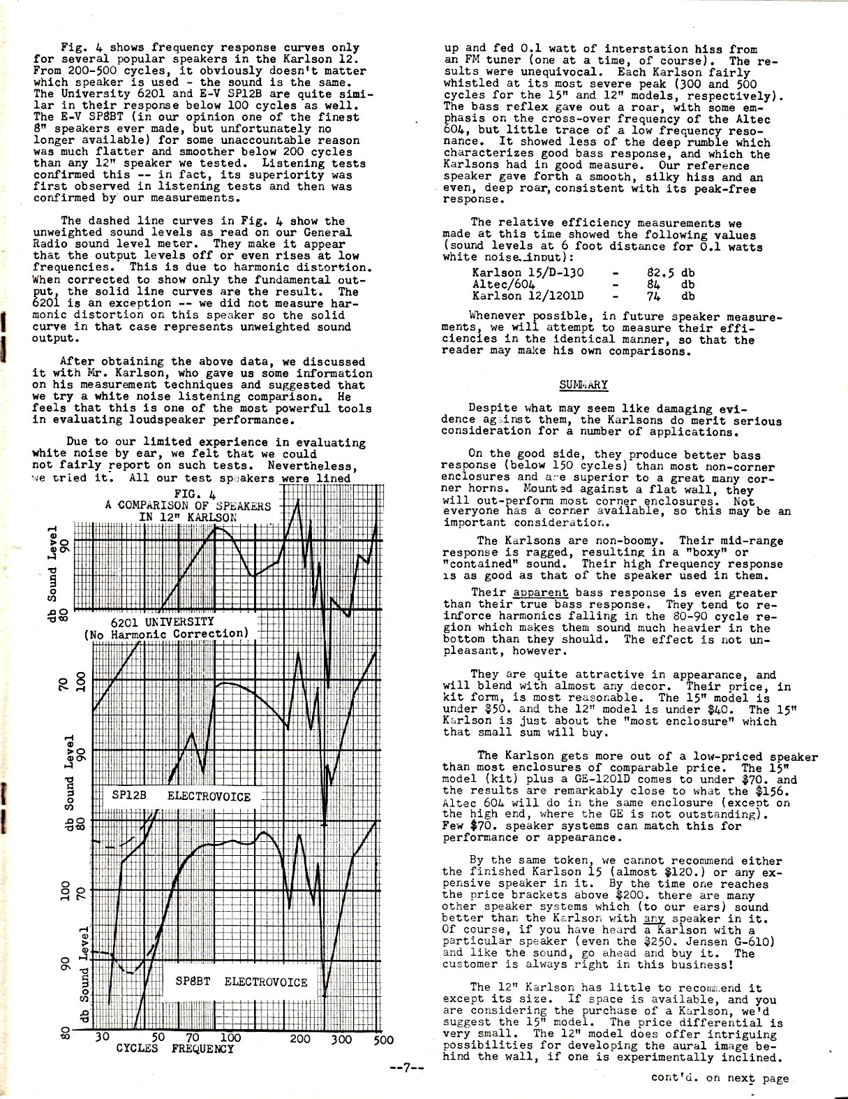

Carl gave the following as a rough guideline
A formula for rear chamber volume -
Rear chamber: vbr ~(vas*qts*fs)/fc (CN used fc="50")
(230*0.25*32)/50 = 36.8l (pretty close to Karlson's K12)
Front chamber: vbf ~0.5 vbr;
Lowpass rear shelf gap area: slp ~0.2-0.4 sd

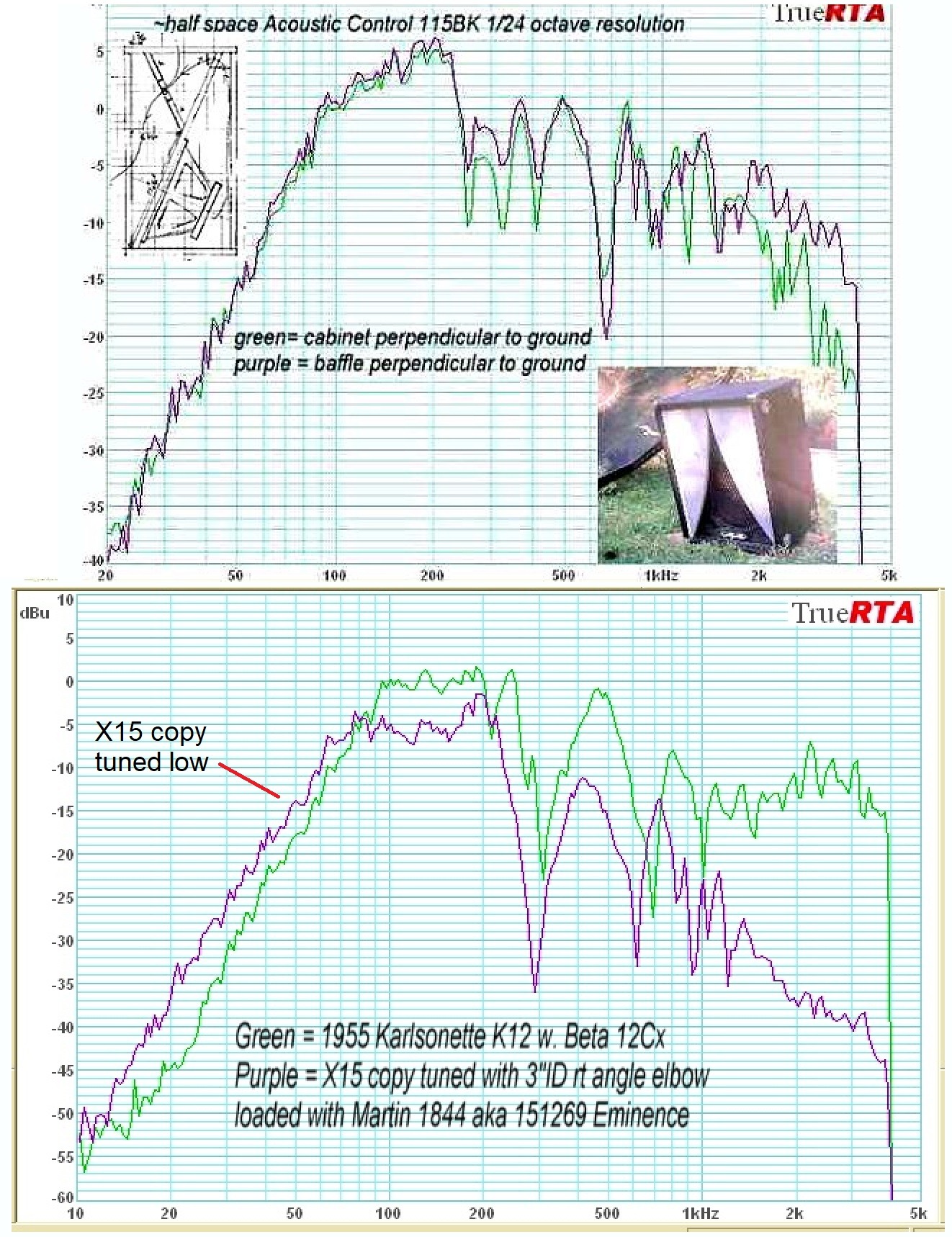

FWIW I think GregB's stock Karlsonator 12 would work pretty well with this Altec - but it would be fun to try something else K-ish.

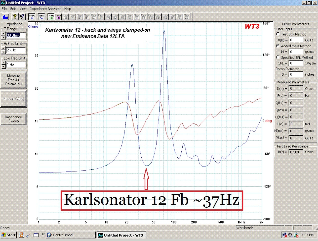

At 37Hz Fb Karlsonator12 is tuned a bit more than a half octave lower than Karlson's little "12".
A provision in a test box could be make for a reflector panel to hold the big EV compression driver - it would have to have a K-tube in that mode, otherwise the treble would be buried in echoes from the upper front chamber.
It would be good in a test K to have the port panel removable as to be able to switch between port schemes and port tuning. Recollections of Ann Karlson's X15 organ speaker said it was tuned with 43 - 3/8" holes. I think we have proof of that being done sometimes with the pictures of a large-port X15 having a board insert with about that many holes drilled. There have been other X15 with the big port open and I think that led to the flurry of X15 size K-couples appearing in the early 80's by a number of companies.

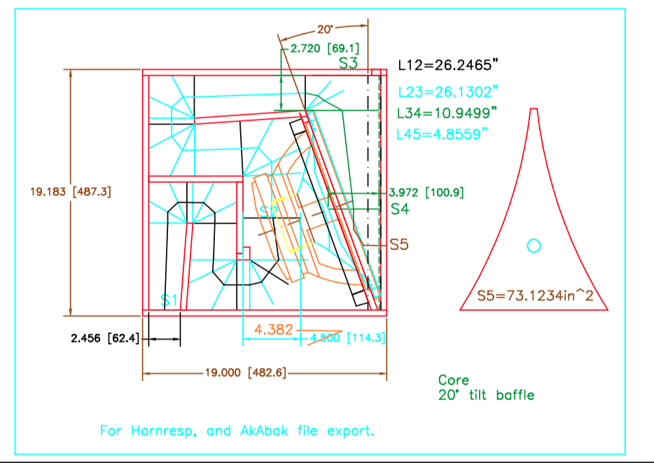

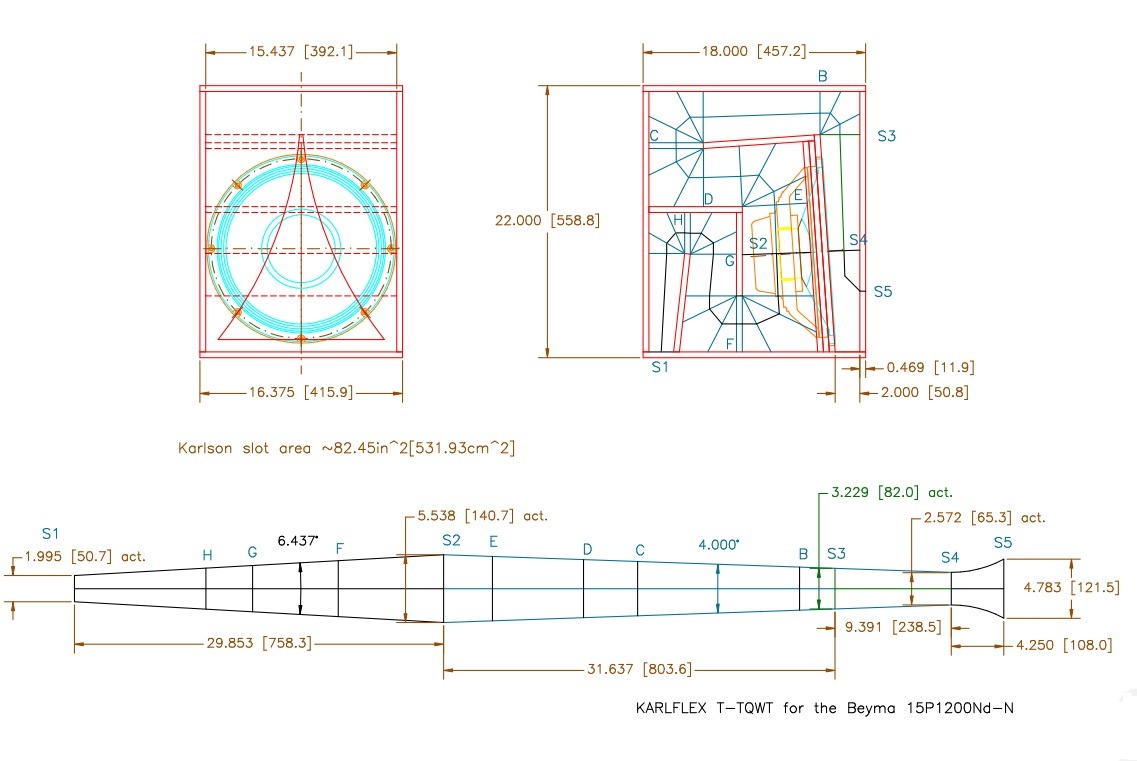

@freddi Since you talked about something K-ish...I was toying with different horn shapes to fit the Karlson general design. So here's something 'out there' attached: it's a more instrument shaped front chamber kind of in-line with the sketches of Karlson patents without parallel surfaces. The 2 driver thing can be ignored. It's a tractrix horn so which allows the woofer to be placed after the fold. The tqwt itself sims well. The port could be slits or a pipe sticking into the horn, and it could be positioned at a null point like 1/17 or 1/11 of the total length.
You made a statement about Karlsonators sounding good when the overall path length is 1/4 of the Fs wavelength. Would this be because at max speed crossing the null the compressed airwave will reach the other side of the woofer when it's at maximum extension - as a reason why cone motion is so well controlled, apart from the front and back loading?

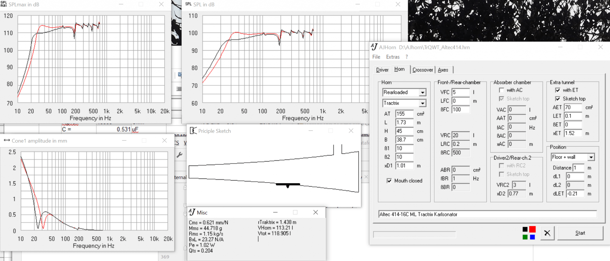

assuming your 414 specs are ballpark, what is the internal volume of the TQWT portion of your proposed K-coupler and what overall dimensions would the K-hybrid have ?
Although in uncharted territory, it looks like it could be a winner.

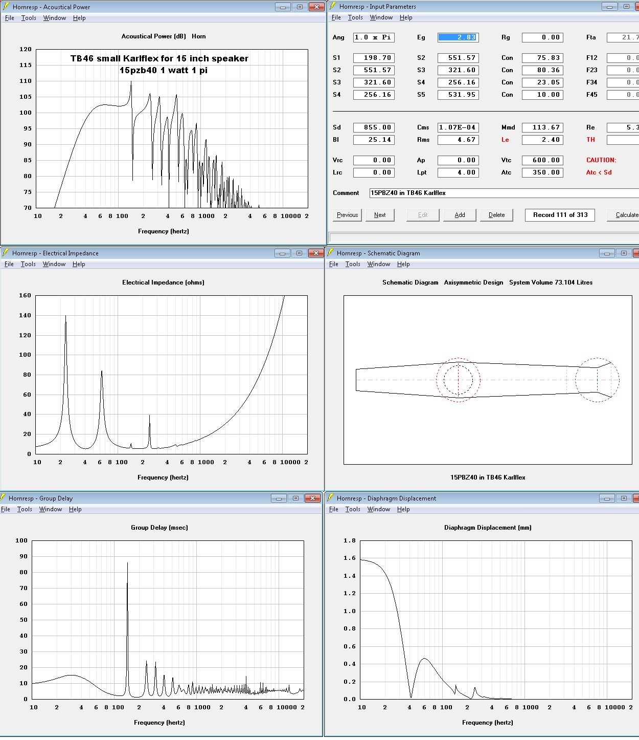

Did you simulate the rear with hornresp? - what effects would the front chamber have upon the TQWT'response?
There ought to be a way to estimate with hornresp. My little Kube12 is squat aspect so series bandpass sims don't seem far off.

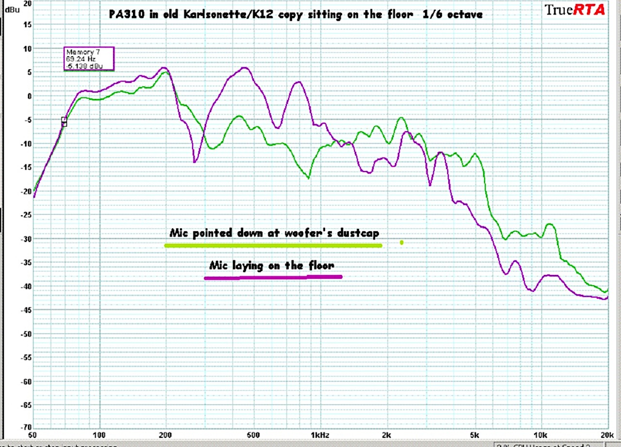

I've heard cases of K-coupler where the overall sound including midrange is "improved" vs a direct radiator - particularly with 18" drivers - of course it can go the other way -a slit vent K12 loaded with Dayton 12" PA-310 sounds like its 20 feet under water while a Kappa 12A only a few dB loud in the mids is pretty good - and very striking on synth-organ. I'd love to have a Dutch K12 for reference.
Vent location seems to have a lot of impact with K and can get really ugly with regards to dips. Perhaps IG81 will weigh in on this matter.

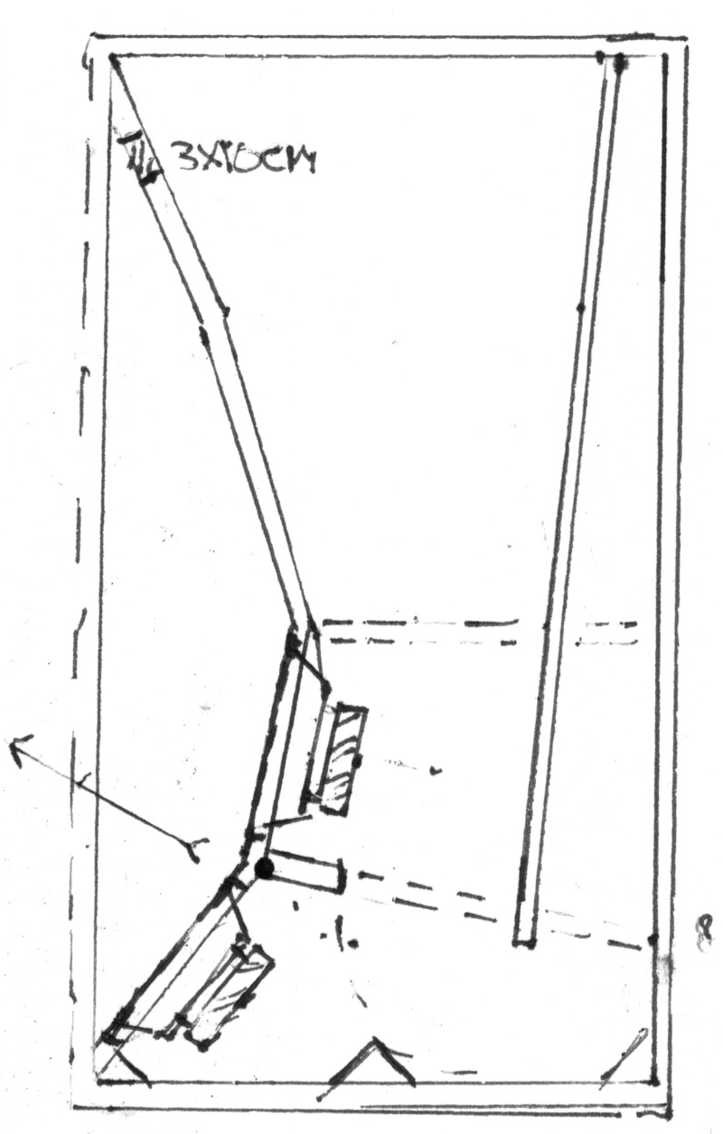

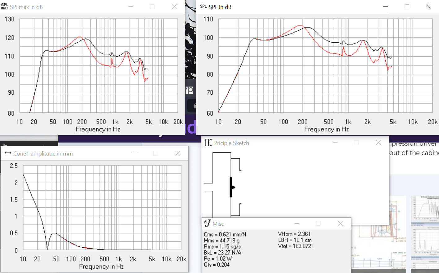

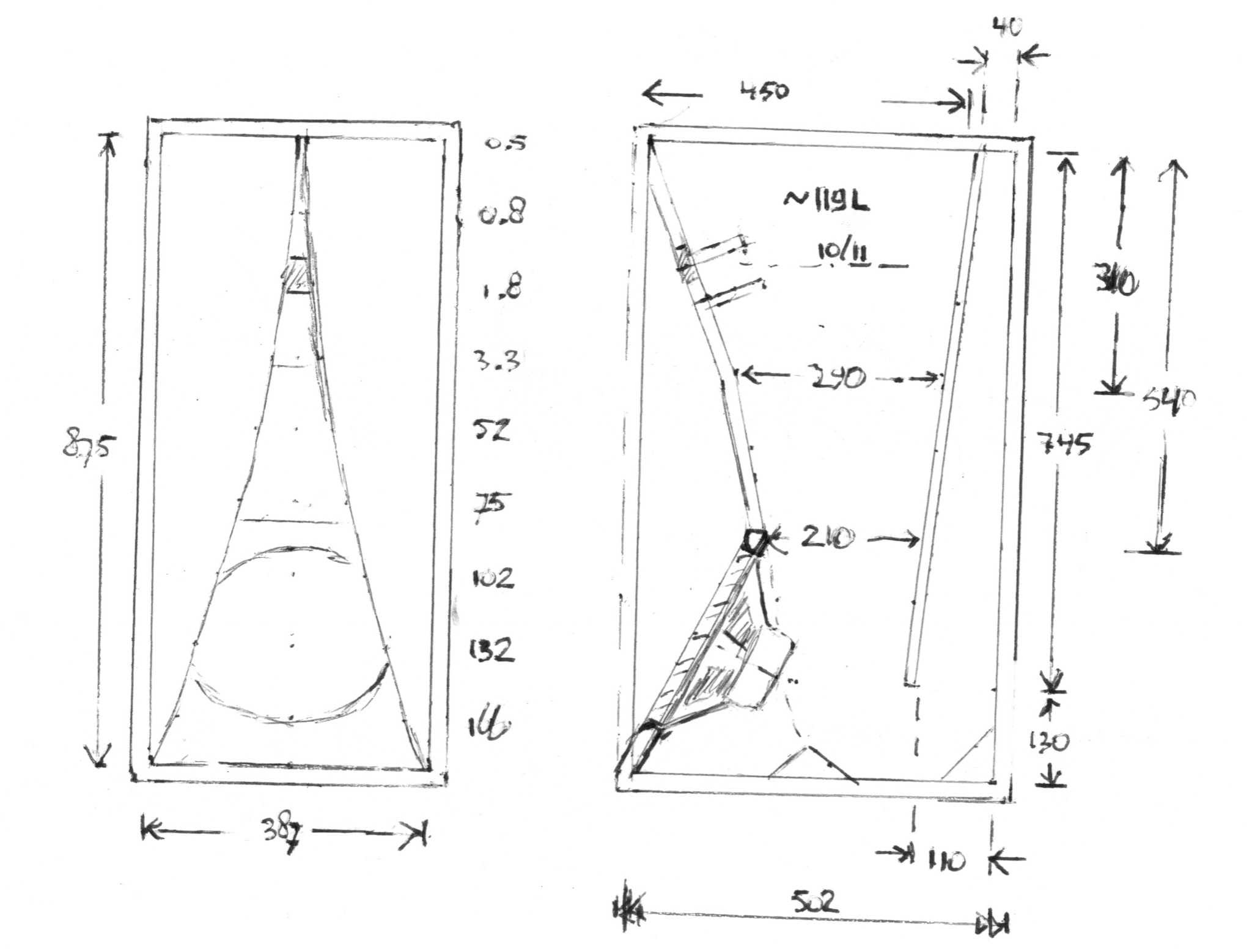

@freddi I've redone the concept sketch based on the 414 now, using the parameters from here http://alteclansingunofficial.nlenet.net/Thiele-Small.html (I should have 414s in my hands soon). I used AjHorn for the calculation; I haven't worked with hornresp yet or attempted to model the front chamber - so there's quite a few blindspots, including me being green at this. Ajhorn doesn't sim the floor coupling effect which Karlsons enjoy, so I'm presuming I can get away with a lower tuned cabinet (-6db bass shelf).
The result here is a 170L enclosure with about 120L : 40L ratio and about 10L lost through internal 'scaffolding'. I've ran 2 different tunings through it: one with a 35cm2 port (black) and one with a 70cm2 port (red). The port is 10cm / 4" deep and is position to sit on the 11th harmonic of the horn length (1m73 / 5ft8). As with your graphs the tuning, position of drivers and ports make quite a difference.
As for predicting the front-TQWT interaction, I think the Karlsonator is our best guide - despite it being less aperiodic than this concept.
My direction currently is to do a 143L Hiraga-style downfiring MLTL and a form of Karlson to see which one deserves a proper build 🙂
I'll ask my brother is he still has his K12 🙂

That looks like a workable plan. Keep a provision to adjust the vent and tuning to better match the front chamber response hump in the mid 100Hz range. Can AJ-Horn simulate TH or BP6 so as to include at least some behavior from the front chamber?
Hi Mr B1
that has a very pleasing front aspect ratio and is very close in bulk to K15. I think it will go a half octave or better lower than using 414 in K15.
Perhaps you can try TB46 Karlflex model (Oliver Frazer)
