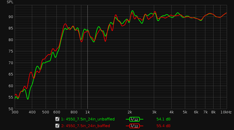

Here are some measurements for the BMS 4550 on 7.5" K-tube.
First, response 24" away, perhaps ~15deg below tube, slot facing down, without and with a driver plane baffle, as per the pictures.
We can see the baffle (red trace) supports the low end, but probably below a sane cutoff frequency. There is a slight smoothing of the response from 2kHz to 5kHz. I suppose a baffle might be beneficial, but no need to go crazy there IMO.

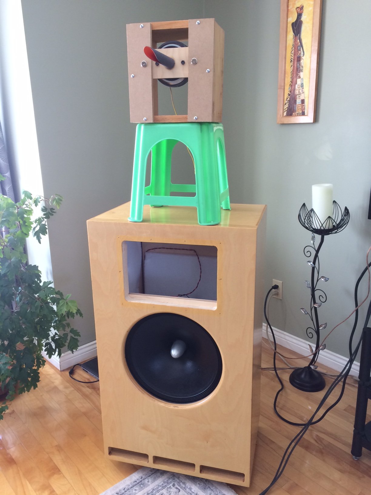

I do like the 4550 quite a bit. I took it off the QSC waveguide it's normally on, mounted in the large enclosure used as a stand in my last post.

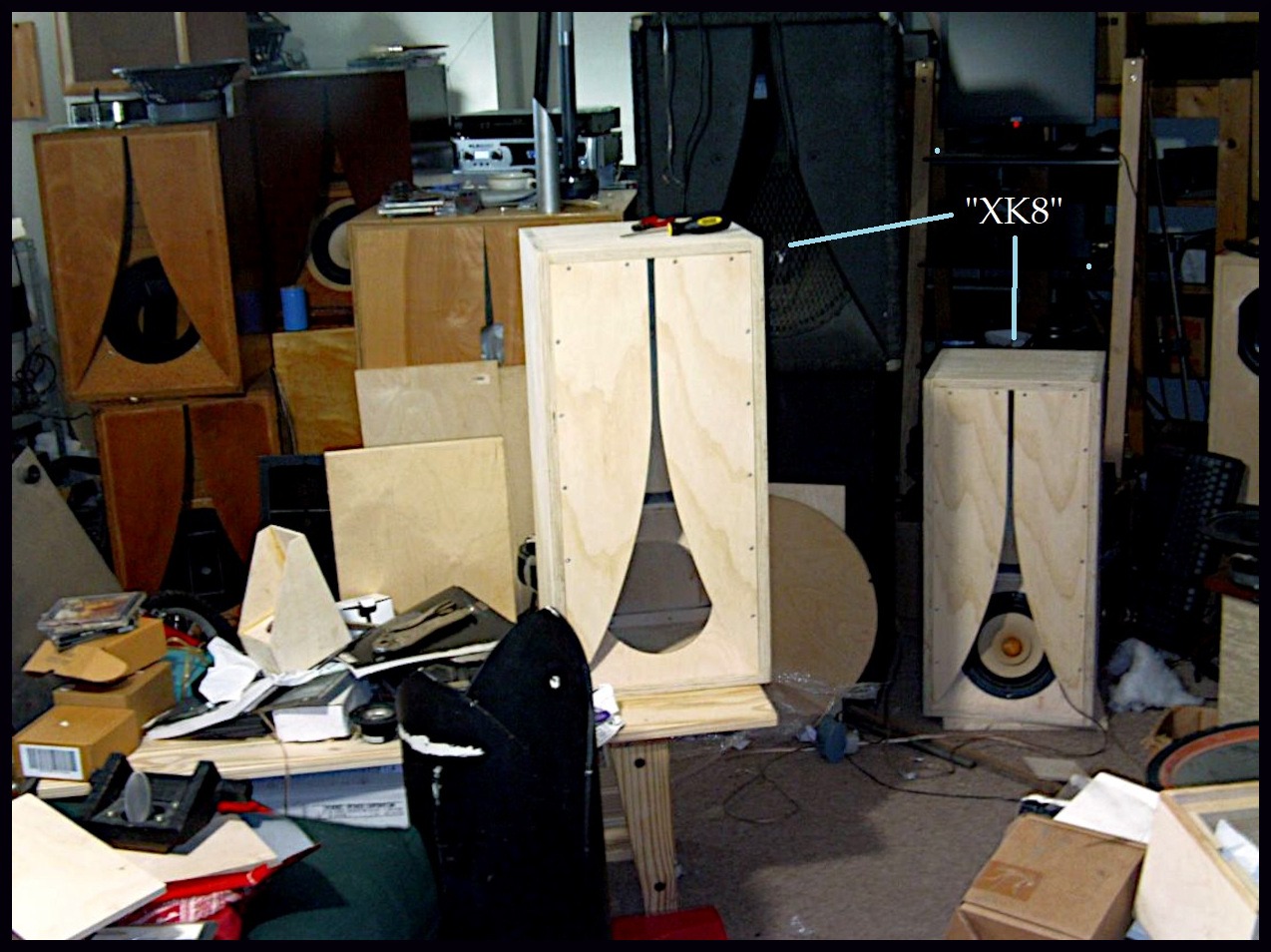

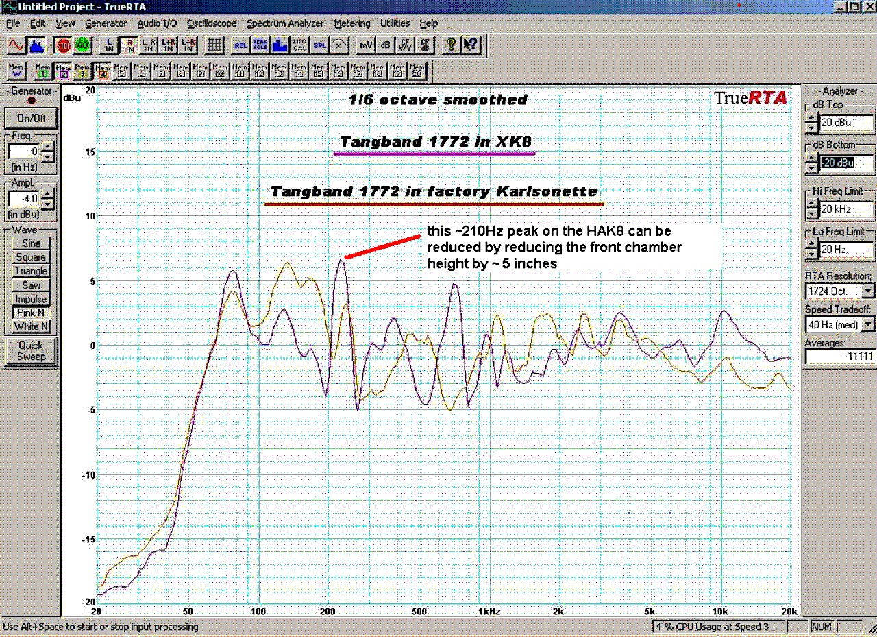

hey IG81 - here's what I got for an "XK8" vs Karlsonette K12 with W8-1772. The original aspect had 2-5dB more gain in the 110-220Hz octave. Both cabinets are similar in bulk. I think the 28 inch height should be reduced to maybe 23. XK8 probably needed tuned lower.
I got a bizzare impedancreading with a 3 inch hole vent at the top of the front chamber and Nirvana Super 8.

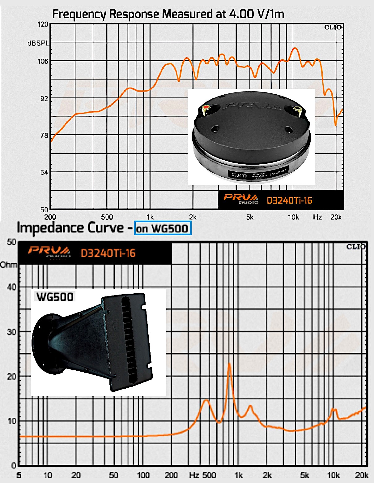

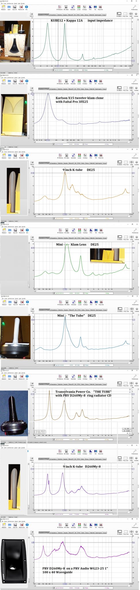

Hard to say without knowing the response and impedance on your tube. I guess an L-pad to tame the impedance peaks would be a good start. Then a small capacitor in the 1.5µF to 2.2µF range might equalize the off-axis response. You'll then likely have its natural LF rolloff create a kneepoint in the mid-1kHz range, so maybe a swamping resistor and a 2nd order network at 1.5kHz designed to the impedance you ended-up with the components you used downstream. It's a bit like with a CD-waveguide.

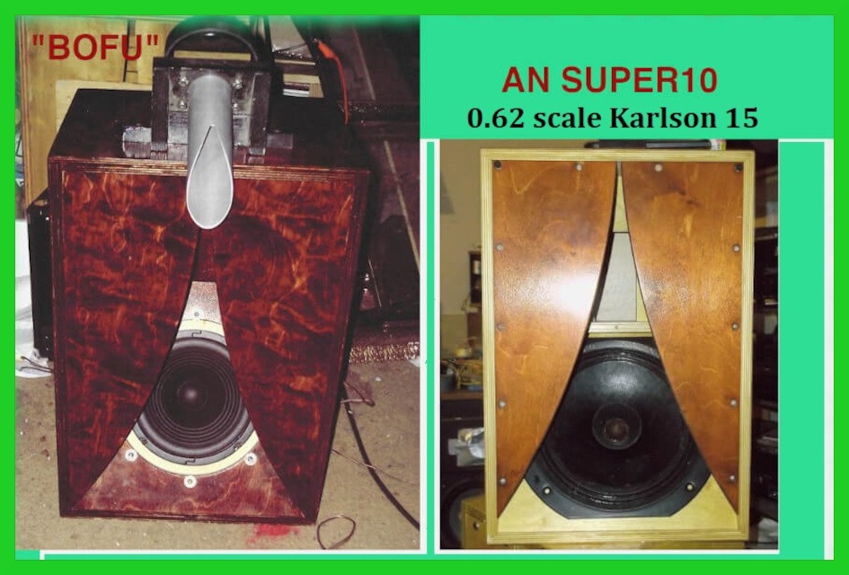

I'd like your thoughts regarding making a stellar "K10". There is nothing wrong with Karlson's K12 with some 10" speakers. but it could be interesting to try something "new"
Driver type ("home" vs PA") affects LF cutoff.. My recent KUBE12 with Kappa 12a shows a pretty solid 70Hz with F6 in the low 60's for a one cubic foot back chamber.

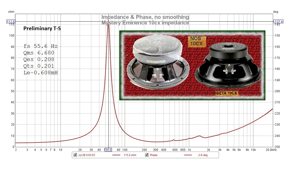

Celestion's TF1020 probably would make a .OK "K10. I have Peerless Tymphany "Pro" 10" which probably are a good match for some K10 plus some monster Eminence 10(cx) with 80oz magnet.
-those have no horn and woould immediately adapt to a coax k-tube.
