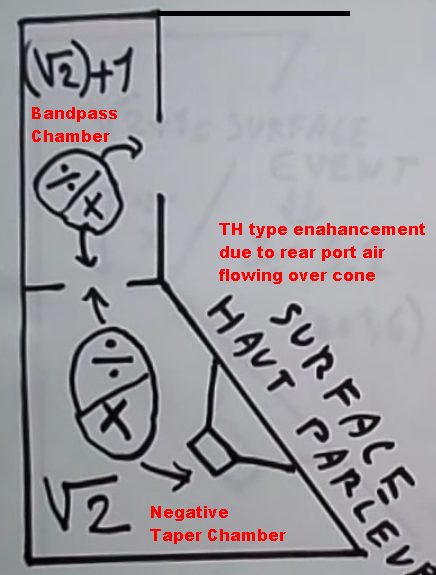

I know several of us should be interested in this, especially freddi *
Unfortunately it's in French ! But he does write a number of useful looking simple calculations onscreen, which could prove helpful.
Vance Dickason's book is used as a design reference, so the English version can be located.
What i realised for the first time, with this build, is shown in my screenshot. It appears to me, to have these three design elements all working together, plus the usual elements in front of the cone, not shown in my screenshot.
The ones in front are seemingly a combination of a number things. Semi bandpass, Restrictor. And whatever you want to call the curved wing shapes.
So all in all, there's a lot going on ALL at once ! No wonder trial & error must be very frustrating building these.
What are your thoughts on my analysis ?

@Zero D - yeah it has TH and front resonator elements. I'm not sure what the French guy's analysis will ultimately show.

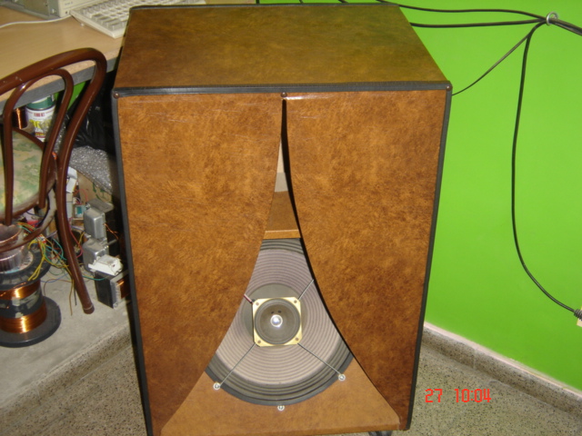

hey GM & guyz - what do you think would be the best way to sim this Thai "mini Karlsonator" for 18" from a MrFlexy YouTube video in Hornresp ? - eyeing, chamber ratios look 2:1. Having a vent "blowing" towards the narrow part of the aperture may have some effect.
just looking at Mr Flexy's "Mini Karlsonator" for 18" as a series bandpass box, gives a pretty poor response. IF it works, then perhaps the narrow portion of the aperture is doing something not seen in the BP6A model - ?
The inner port area may be more like ~460 sq.cm. - but that doesn't seem to help the response curve shape.
