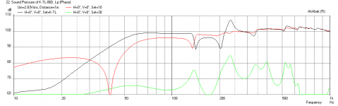

how would a wider version of the Karlsonator 12 sim with say an Altec 416? how much lower cutoff can be achieved in the same volume as K15 using a 15" woofer?
Here is a Karlsonator with the Altec 416 scaled to 15/12 in both height and width:

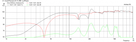

With the width scaled to 18/12:

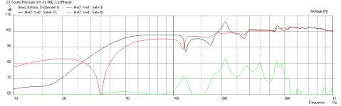

Now with both the height and width scaled to 18/12:
It seems that this driver has a very pro audio behavior of high efficiency with some reduced bass extension. It's a rather big cabinet though to achieve bass extension. The sims are for walls far away with mic at 1m.
