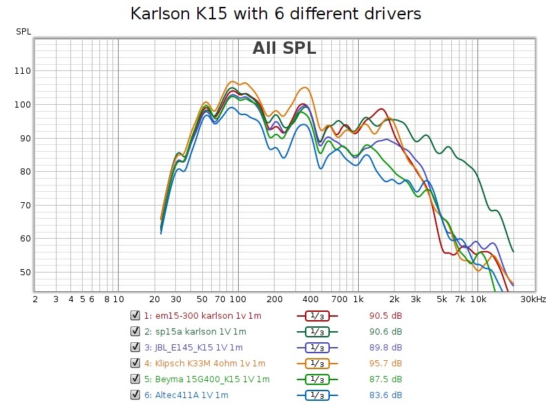

I think GM brought that up to illustrate there was some sane pre-TS thought going on regarding properly sizing bass reflex boxes.
Karlson enclosures likewise would have some size limits. I have run strong 12" (KN 612HC) in K15, very weak 15" (EV SP15B), Audio Nirvana super10, all with enjoyable enough results. I never ran my nemesis 12LTA - that might have been a good match to extract some power from the weak motor.
One 416A in K15 would lend good support.
With a lower crossover such as 80-100Hz (maybe 150 would work?) you could use K15 like Exemplar.
Tuned how low? The 416A [~3-4 mm Xmax] is designed for ~20-25 Hz [measured Fs] FLH, though normally tuned to ~ 42-55 Hz in the cinema reflex horns whereas the K15 is designed for the 50-60 Hz 604B, C with its ~1-2.5 mm Xmax.
Not really sub duty unless there's significant room gain and/or ~100 dB transient peaks is adequate.

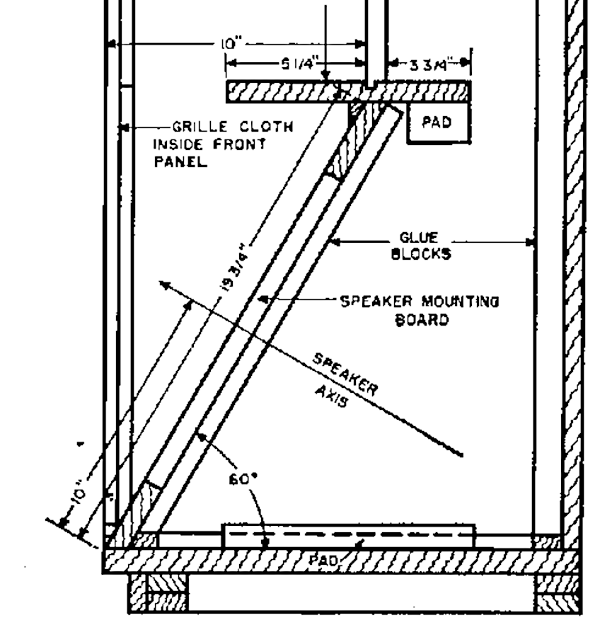

fwiw I would not mod K15's shelf either for fullrange/coaxial or subwoofer duty.
The front portion of the shelf partially corrects a dip in the response above 200Hz and the rear along with "pad" does some filtering of the backwave before it passes through the central ~9"x4.5" vent.

Of what material are those *"pads"* that show in the 1954 Radio and Television News drawing made...blocks of wood, or?
For my woofer/subwoofer build, would you recommend building with the original rectangular ~?*"x4.5" vent, such that the Exemplar dual 3" elbow vent could be added later with an insert panel if desired?
Best, Robert
* I'm having trouble reading the slant height dimension of the speaker mounting board up to the shelf on the 1954 drawing...what is it...15.75", or 19.75", or? If it's 19.75" (which seems likely since the slant distance up to the driver centerline is 10"), the port height is 9.02", not 9.5", not 11.25" mentioned by SoundRight.

those pads were fiberglass, rockwool - later probably "Kiomsul" (a nice paper insulation product not made anymore)
I would make the 9" x4.5" vent shown in the January 1954Radio and Television News article - but if you intend it only as a subwoofer, you could make the port panel to directly accommodate two schedule 40 rt. angle pvc elbows.
Tuned with the original vent, it will have articulate punchy bass which extends to around 50Hz reasonably flat - depending upon room.

Robert - here's that plan detail in the baffle enlarged - does that help?
There's also a 1959 K15 "build in" article. That one differed by attaching the back panel to the "outside" of the sides/top/bottom, making it 18.75" deep vs 18" for a regular factory K15.

Thank you for the detail of the plan...it helped me to confirm the 19 3/4" slant height dimension, thus the 9" port height.. Also, thanks for the scoop on the "pads"!
I was originally thinking of scratch building a single enclosure...but...along comes a pair of vintage, nice looking - like K15s, with what appear to be their original Utah 15" co-ax drivers on ebay, Item Number 164812341714. Free pickup in Greensboro, NC...but alas, I'm in Corinth, Vermont, ~850 miles and a 13 hour drive away. I've submitted a request for quote on crating and freighting them here...expect reply tomorrow.
