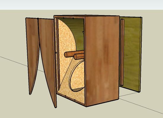

I whipped up a Sketchup of a K Kab, with variations per JK's newest patent.
There's a dutch builder who's completed one like this or similar to it anyway, who seemed to be very pleased with the results.
This isn't in any way final result, just wanted to put up an image.
Kenpeter,
Have you looked at the latest patent JEK held, specifically regarding the so called " Figure 6 " diagram. There's a DIYer in the Netherlands who has built cab's to the new layout. The area above the shelves is bent into a smooth arc, and both the front and rear shelves are removed. He seemed very pleased with the results. He also modified the size of the vent.
My own plan is to build a box, and then construct both an updated, braced original interior, and one based on the mods described above, so I can listen to both, then decide which I like and veneer/finish the cabs.
I'm leaning to the Smith DSH, but the materials to do the " tube", are inexpensive so probably will try them too.
John

The flaw in Fig6 is that it focuses to a horizontal stripe,
but the exit slot is VERTICAL. Thus the first pass exit
efficiency is low, and you have a lot of reverberation.
Now, you turn those curves sideways, and maybe you
can provoke a focus that is more in line with the exit.
Its also important to lengthen and contort that path of
acoustic short circuit managed by the shelves. I think it
would help to brace the wings and back by moving the
gap area to the sides or corners.
