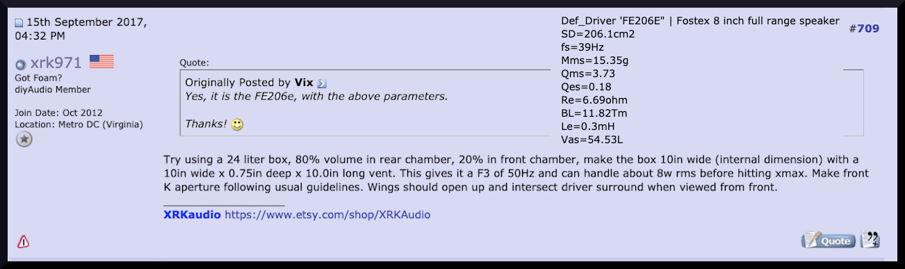

XRK971’s XKi suggestion would be around 15” tall, 11” wide and 11” deep - that would be a fun size for sure:
XKi dims by XRK971
Although tuned low (~41Hz) a Karlsonator 8 should be a pretty good match for 206 and that was the original prototype built along with a Karlsonator 6 (excellent cabinet)

That's an interesting size. I am tempted but in reality don't have a need for more speakers. I'll bet they would outperform my friend's Wharfdales but for nostalgia.XRK971’s XKi suggestion would be around 15” tall, 11” wide and 11” deep - that would be a fun size for sure:
looks like it would be just a bit larger than X's Beta8cx XKi and still quite compact.
I think Beta8cx with the right lowpass network would play pretty well and with some "hit".

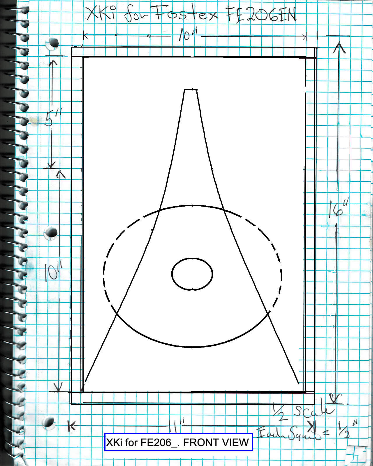

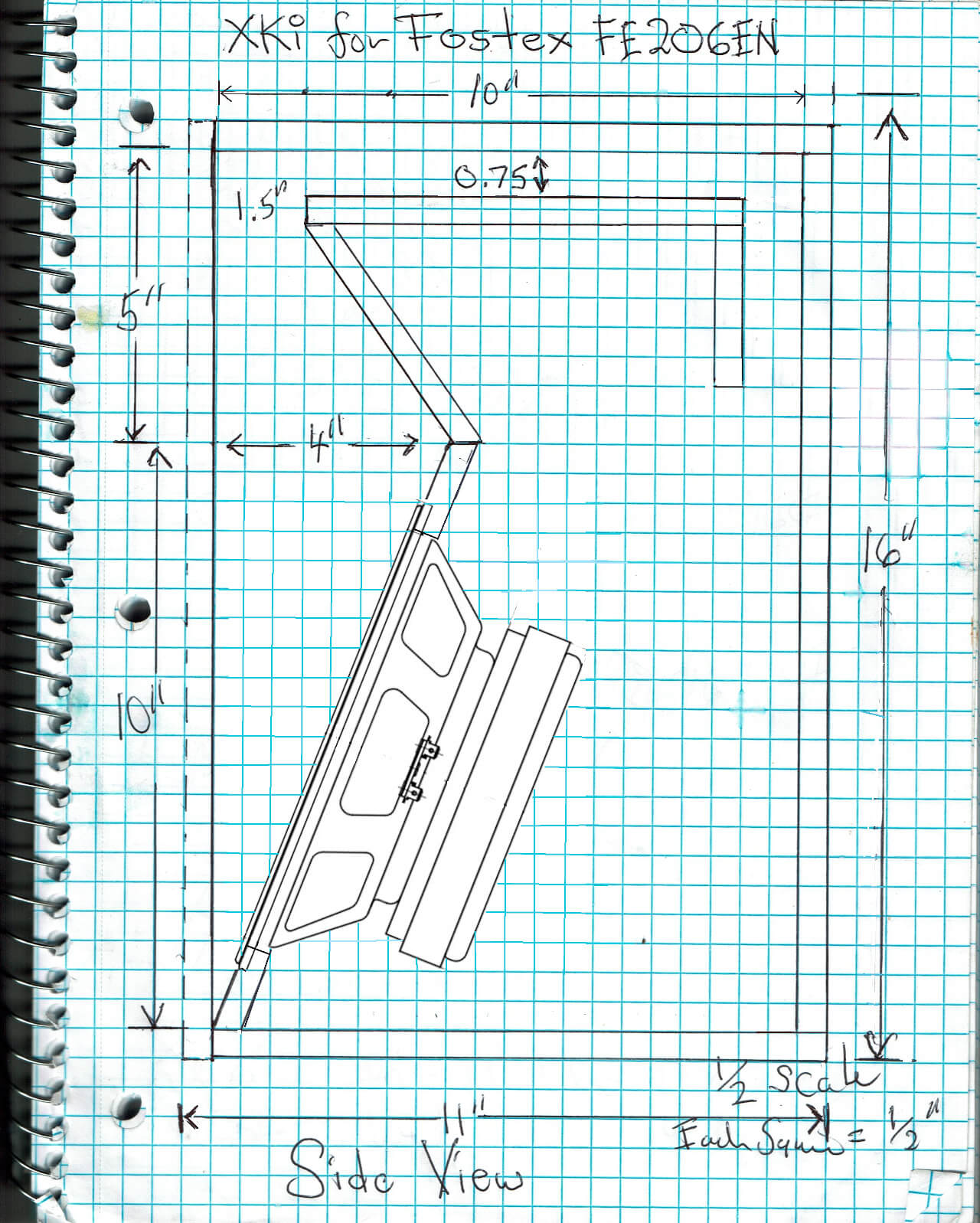

Here's a somewhat better sketch of an XKi alignment Karlson type cabinet for FE206xx. At ~31.7 liter external bulk its quite compact.
Although the vent is specified as 10 inches in length, it might be wise to reduce that length by 15-20%.
If foam core is used for the vent duct it could make for easy experimentation with vent tuning (maybe length, slot or a hole(s) like a flute).Although the vent is specified as 10 inches in length, it might be wise to reduce that length by 15-20%.
