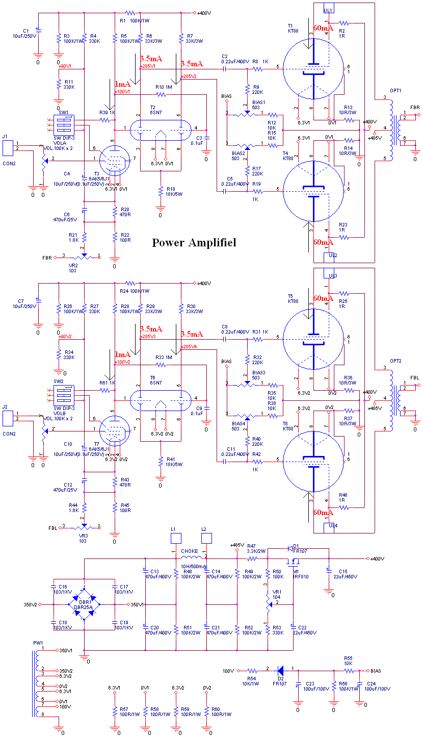

I have a new idea,this is hi-end karaoke system,someone interested in this idea?
I am designing schematics: Pre Microphone, Echo Digital, Pre Music, Mixer, Pre master,Power amplifiel.

Thanks, but what tubes are doing there?!
Thank you.
Tube makes vocals became smoother, warm ...
