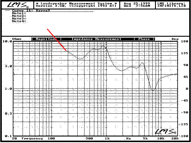

I have a couple of questions regarding impedance related to my Infinity Kappa 9's that I think could be answered here.
I have attached the familiar K9 impedance graph for reference.
1. In the K9 woofer xover there is a bass extension switch that when in the OFF position adds a 5ohm resistor to the xover circuit. Is the effect of this switch as straight forward as adding 5ohm to the lowest impedance of the woofer?
2. I would guess that the impedance graph was a result of measuring the K9 with the + and - speaker posts connected in single amp mode. Can anyone give me some insight as to how the Mid/High portion of the graph might change if the speaker posts were not connected such as in a bi-amped setup. I would like to know what kind of impedance resistance would be presented to an amp on the top end in a bi-amped setup.

It's a monster big 5 way with an additional rear-facing tweeter. Impedance looks horrible if that graph is correct. Dipping to 1 ohm is a bit poor.

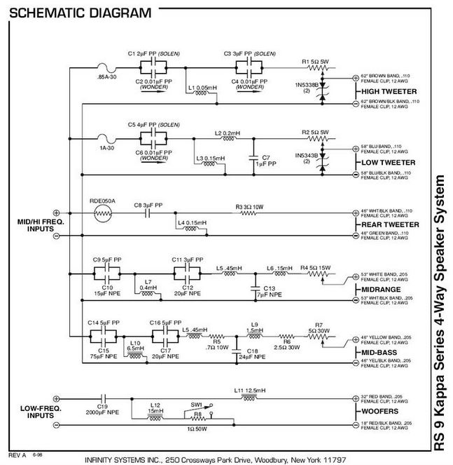

IF it's similar to the Infinity RS9 Kappa, we have this below. Hard to know where to start with that. You might set up a sim in Downloads with similar drivers and see where that goes.
Lot of work, but electrically, if the drivers are similar types, with similar 4 or 8 ohm impedance which you might measure, and you get phase right, it ought to give you a fair idea what is going on. BTW, only use an ohm multimeter on regular speakers, ribbons are fragile.
You might use some imported projekte files to get the hang of the simulator, but you'll need to set up 6 drivers from the start on a given baffle and box volumes. boxsim-db.de | Boxsim Projektdatenbank
Multi-ways can have all sorts of low impedance issues, and taking resistors in and out of circuit has surprising effects, because you're affecting filter damping.
Yes that's it. Thanks for uploading the Xover.
In looking at the woofer xover I see I made an error in my first post above because the switch (SW1) that I was referring to on the woofer xover engages a 1ohm resistor not a 5ohm resistor.
Maybe it would help if I explained where I am coming from and why I am asking the question. I have already completely refurbished the xovers in these speakers. I now have these speakers horizontaly bi-amped. I want to get a more accurate reading of what kind of impedance loads I am putting on the two amps in a bi-amped setup.
My woofer amp seems to be handling the bass well with the bass extension switch OFF which engages the 1ohm resistor. My concern is more with the top end amp because I have a couple of nice vintage Yamaha amps not rated to handle 1ohm loads and I don't want to risk damaging them.
My guess is that tweeter or midrange drivers dipping to 1ohm requires a lot less current than a woofer dipping to 1ohm and since it is the current demand that can damage an amp, am I safer with the lower ohm dips on the mid/high in bi-amped mode. Is this a correct assumption?
I am asking because I am under the impression that I can't rely on the impedance graph because it would change in a bi-amped configuration with the woofer xover disconnected from the mid/high xover circuit.

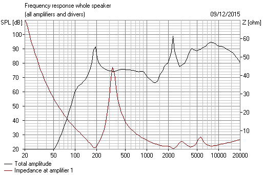

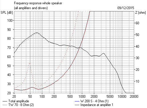

Here's the sim of a 4 ohm load on the bass section. The dotted line is the more conventional style without the shunt altogether. But keeping the 2000uF cap. Frequency response is hardly changed.
This is the section the bass amp sees biwired. Looks like an amp frier to me! Off the top of my head, I'd reckon you could lose the series cap and the coil shunt and it'll sound exactly the same.

Well, I ran some of the top section up the flagpole, but I'm not setting up a seven driver speaker here. The top section spends a lot of time around 2 ohms or less even without the two extra tweeters. 😱
FWIW, the 1 ohm resistor on the bass shunt DOES help by being switched in. The weird bass section input is a slight subsonic filter really. Acts below 50Hz by about 3dB overall.

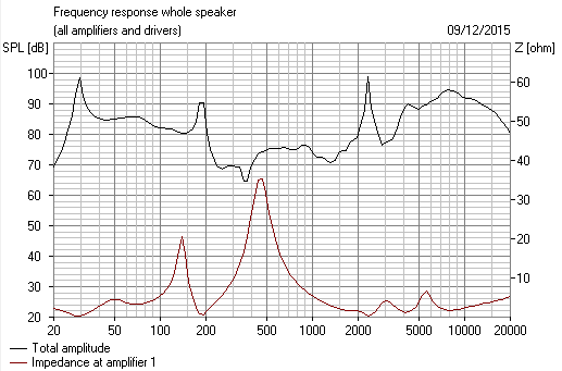

I set up a sim for electrical purposes, up to the low tweeter, and set the coil resistances to zero. Dreadful. Virtually short circuit at several points. The only thing saving the amp is the resistances of the coils themselves. Essentially most of the coils are too small, and most of the capacitors are too big. That bass section shunt is daft too.
The second image is the bi-amped filter top section on its own. Do you feel lucky? Remember there are two more tweeters to add. I wouldn't plug that in. 😀

Amusingly the published schematic has an error in it which creates an even worse dead short in the mid when you rebuild the crossover. 😱
Now what is wrong with it? TWO mistakes in the mid filter IMO.
1. I noticed the 7uF cap is connected between the 0.3mH coil and the 3R9.
2. (?) 🙂
