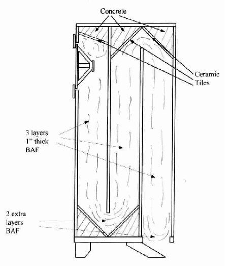

I've constructed a Kapellmeister enclosure after years of planning to make a set. I've made in 2012. Since we don't have the recommended the Altai speaker here in my country. I used a Pioneer car speaker & a car cd/radio player where I previously kept when I sold my car.
The performance of the system is awesome. As what the author of that paperback book have mentioned, all the instruments and the vocal of almost songs that I played were crystal clear. I feel like I'm listening in front a band playing live. Indeed, the system have no colorations. It's what really called a hi-fi.

I have "An Introduction to Loudspeaker and Enclosure Design" by V.Capel that describes the design, construction, and performance of these speakers. The only aspect of the performance that might trouble some, is the falling response (-4dB at 200Hx, -12dB at 100Hz,). These measurements seemed to have been done in room using multiple microphone positions averaged. I have insufficient knowledge to know how significant this is, but it does point towards an honest appraisal from the designer. It does not say if the level of stuffing was subject to experimentation. The designer uses, and advises using, some bass boost.
This is a very poor TL design. You can always design better one with a TL software designer, such as TL designer from Leonard audio, or from Martin. J. King, or George Augspurger.

Sorry but that is a load of bullcrap. Why? Because this kind of enclosure changes the behaviour in the bass only. It has absolutely nothing to say regarding the mids, let alone the heights. And that means if it is poor in the bass, there is absolutely zero reason to build it in the first place.
Look ICG you have no right to tell me what I do or make . I don't care about your comment. You are the one who is ignorant about this enclosure. You should know what you are talking. At least I was able to build one and experience what it sounds like.
You can build whatever you want. Do whatever makes you happy. Why didn't I build one? Well, why don't you build a tire out of stone for your bicylce? What, that would be a bad idea? Well, there you can see, if you've got some knowledge, you know something will not work well. Or at all. This enclosure principle only works in the bass and if it doesn't work there, there's absolutely no point in building it. So you building it for an experiment is fine to get experience.
But - and that's important - you've attributed a lot of positive things to the enclosure and I could not leave it standing like that because the positive things you've mentioned got not a single bit to do with the type of enclosure! What you've wrote about the sound might (or might not, I'll leave that to the reader) be true, but to tell others it's because of the 'great box' is simply wrong! I wrote that to save others from the disappointment and spending money on something someone (wrongly) praised so much. That's the truth and that's something you'll have to live with.
If you want to improve it, try removing and moving the damping material so it does not eat up all the bass anymore. Best is to keep the damping material in the first ~30-40cm (medium tight stuffed) and remove most of the rest, especially ~1/2-2/3 length to the end. That will make the enclosure work in the bass, you can change and experiment with the damping. Removing the tiles will further improve the sound, keeping the first at the driver is okay though.

The Kapellmeisters as a concept aren't as terrible as some would have you believe.
IF you're looking for an aperiodic TL and hope to lose as much rearwave energy as possible, then they suit.
So too does Visaton Vib130TL.
I'm sure an aperiodic TL could be designed using MJK worksheets but I'm not sure how. Maybe Akabak can simulate?
Strides have been made which largely leave Bailey lines and things like the Kapellmeisters in almost pseudo science territory but they largely have a basis in science, just with one or two incorrect assumptions.
I still have no doubt, with the right drivers, losing the corner reflectors, and with a careful redesign the construction method and general premise make for a neutral and balanced output (almost Infinite baffle without the necessary home renovation) and could make for brilliant integration with a subwoofer.

I built a pair back in the mid 90s, I still have them upstairs.
They were built exactly to spec. (I wasn't clever enough to deviate), but I found that there was a peak around 1khz (never knew why), were flat down to 250hz, then the response gradually fell away as expected from a single unit. However all this was compensated with a graphic equaliser. Also found that any speaker cloth had to be open weave or it dulled the treble.
The problem with the author's construction was that it was extremely difficult to replace a speaker, as I had to after blowing one when pulling out a phono lead without turning down the volume! On music signal though they would go quite loud.
