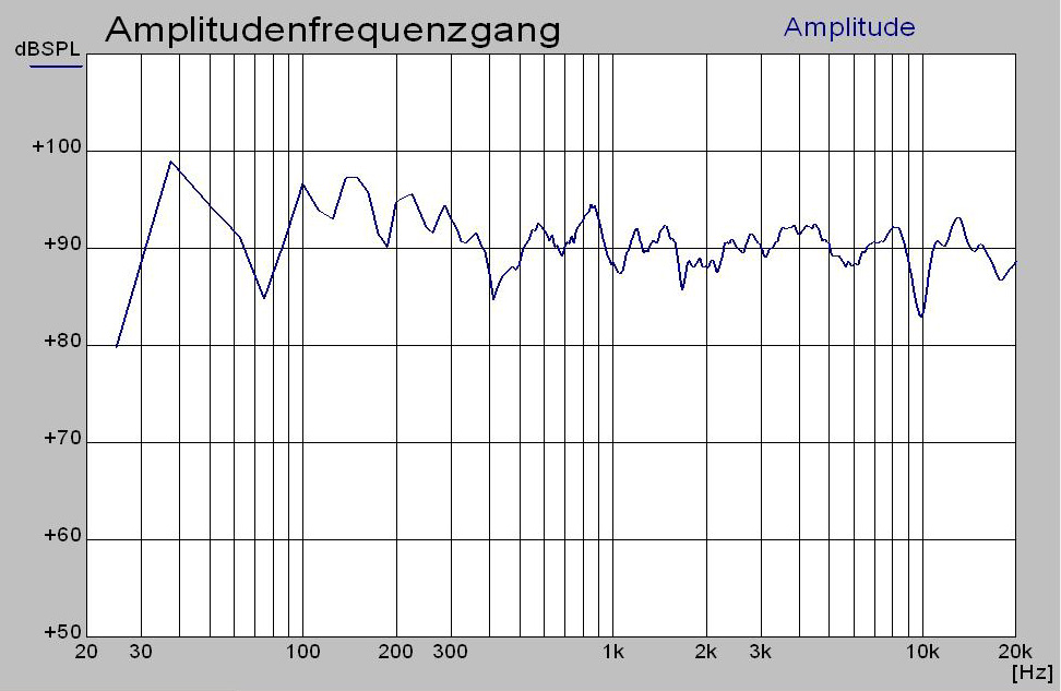

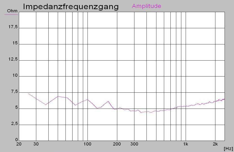

measurements
Hello,
here the measurements 1m 0° SPL i think~92 dB
and IMP
both i think sensational

Those look pretty good - is there a reason why your measurements have such coarse resolution in the low frequencies? I can't tell how wide the 75 Hz dip is as it may just be data point resolution limited. Try the REW software - it works very well and is easy to use and produces very nice plots. That is an amazingly flat impedance curve but again more resolution in the low freq will really tell how flat it is or is it just data point resolution smoothing going on.

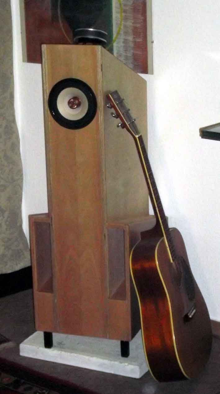

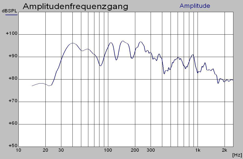

Hello,
the cause of so much bass is the concrete 30 kg, i remove it and now it is
standing on carpet, now i test a variation of wall distanz.
During night time classic listening i found at low levels the
opulent bass was superb.
