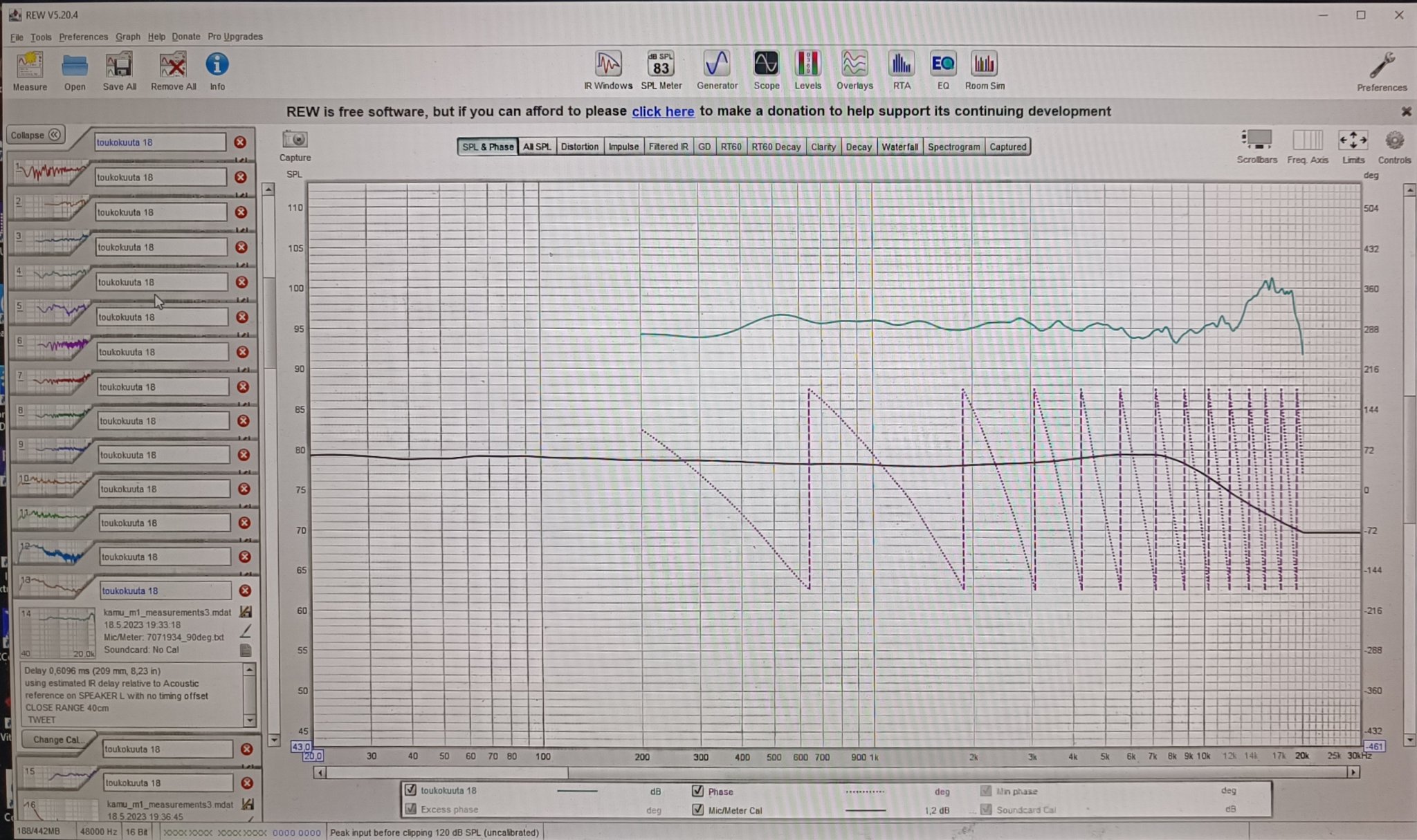

K KAMU_designs Member Joined 2022 2023-05-18 7:31 pm #41 2023-05-18 7:31 pm #41 Too windy outside so here's some half assed gated measurements. Accurate to around 400hz. Rise in hf is intentional. The bmr sounded a bit dull when the fr was flat. This is due to hf dispersion which narrows from 120degree to 90degrees after 10k. Reactions: 6thplanet
