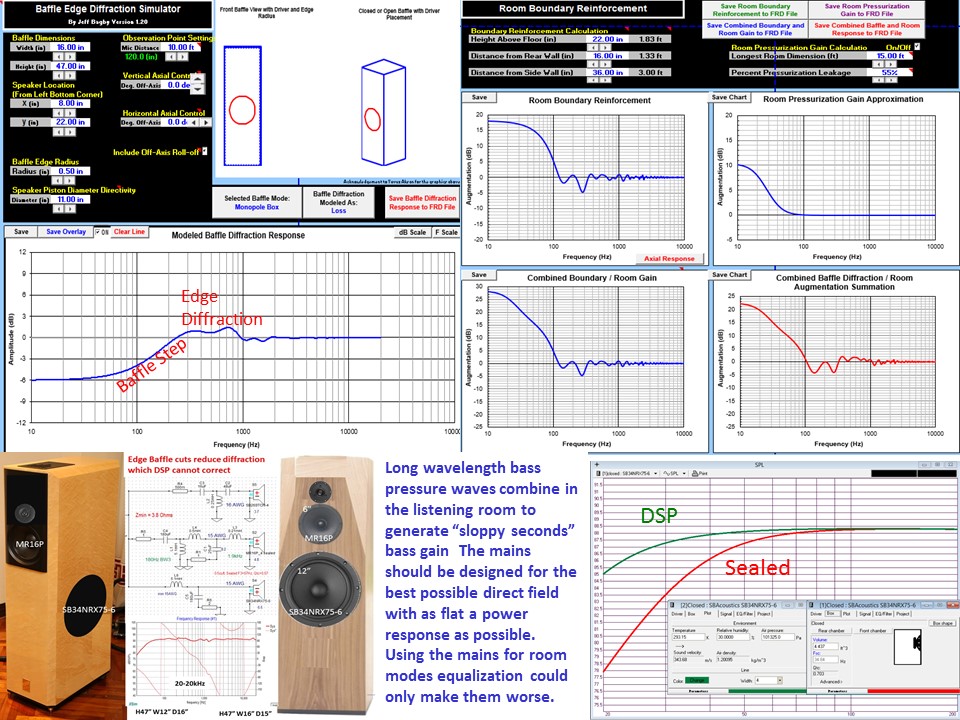

A 12" woofer like the SB34NRX75-6 designed for excellent transients in a sealed box volume can produce better sound quality than a ported alignment, but requires a larger volume box than a ported alignment for the same -F3. For the best stereo soundstage, spend your floor space and money on a stereo pair of tall front 3-way FULL RANGE speakers. Use the equalizer capability in your Denon or PC to help smooth low frequency bass.
Simplify the conversion to DSP. One of the big sonic benefits from DSP is the ease of getting very high quality bass from putting a "larger than normal" woofer in a modest volume sealed box and using a Linkwitz Transform function to get deep bass with a high power amplifier. Geddes: “The mains should be designed for the best possible direct field with as flat a power response as possible. Room equalization of the mains could only make them worse.” Initially put your single subwoofer along the rear wall(corner) to help equalize room bass modes at the listener.

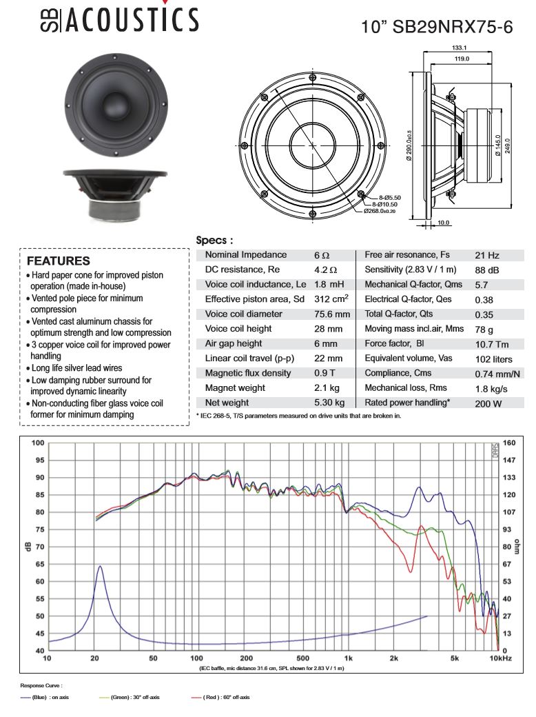

Jeff Bagby favors a LR2 woofer crossover at 200Hz to the Kairos to help cover flexible baffle step compensation demands. Jeff selected "musical" woofers with significant frequency extension beyond 200Hz.
"I call this a 'universal crossover' because the low pass section works well with a lot of different woofers since most of them break-up or roll-off well beyond the crossover point. And the high pass section does equally well for a large number of monitor speakers if they are sealed and have a nominal impedance of 8 ohms. The crossover point is at approximately 200 Hz, which provides a nice transition between the bass and the vocal range. The acoustic slopes are approximately 2nd order Linkwitz – Riley slopes, which is the reason most of the set-ups will require a reverse polarity connection between the woofer module and the monitor. "

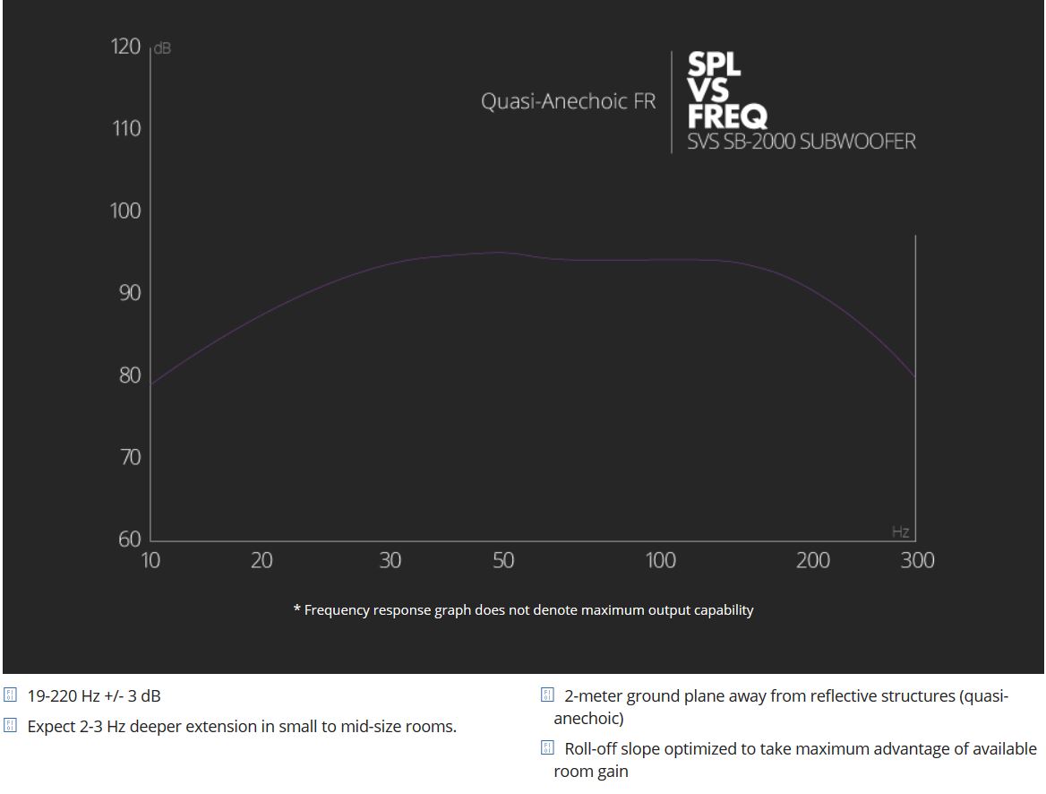

The SVS SB-2000 Subwoofer SPL measurements show -3db at 220Hz, which is at the limit of ideal Kairos integration. You will want to listen to 200Hz music on your SB-2000 before commiting to a marriage with Kairos / Adelphos.

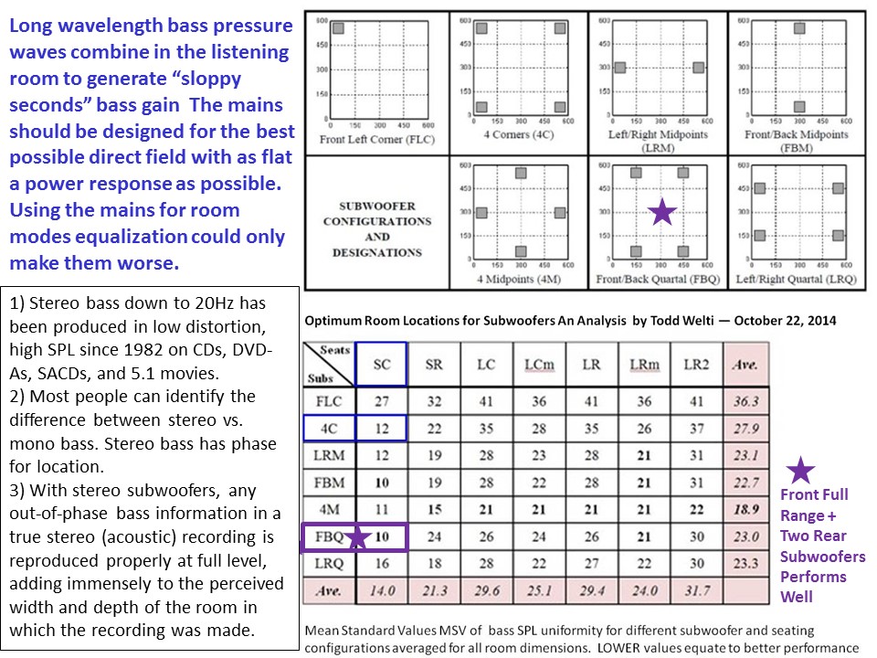

1) Now you know that putting the Kairos / Aldephos using their recommended 200Hz crossover on top of stereo SB2000 subwoofers will not produce good sound.
2) Using stereo SB2000 subwoofers requires main front stereo speakers with -F3 below ~80Hz to meet the quarter wavelength C-to-C goal, and ideally -F3 below ~60Hz.
3) A sealed 12" SB34NRX75-6 woofer generates -F3 below 37Hz with excellent Qtc=0.7 transients before room gain effects. Adding equalization/DSP to a sealed SB34NRX75-6 with Fs=18Hz can generate -F3 ~20Hz deep bass. .... front stereo bass. SB2000 subwoofers along the rear wall or side walls can be used to smooth room bass modes at the listener.
4) The ported EKTA mk2 with -F3 = 37 Hz will also blend well with SB2000 subwoofers.

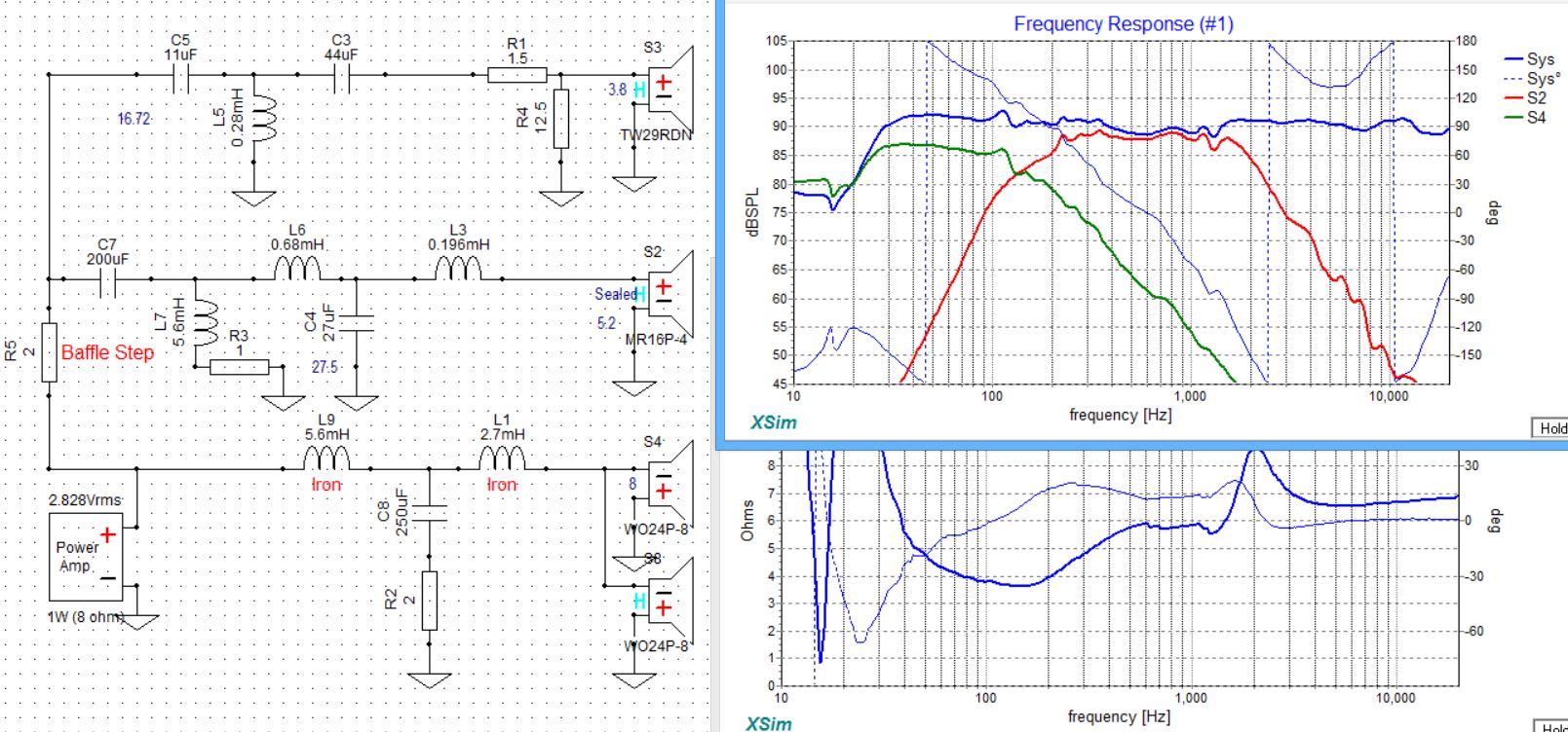

Is there a cabinet's build plan?
What about cross over parts + scheme? (Is the scheme you posted is all what I need?)
