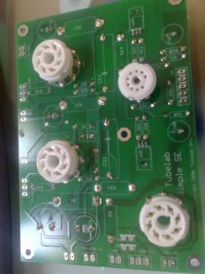

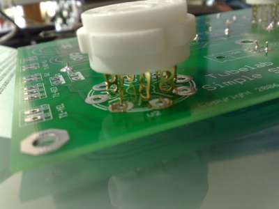

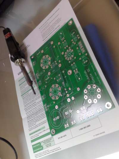

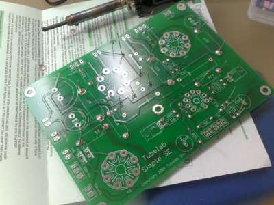

I see. You bought chassis mount octal sockets. You should have ordered PC mount octal sockets. Notice the difference on the bottoms of the contacts?
I'm not confident your "bend it and solder anyway" technique is going to hold up well in the long run. Of course, now that it is done, trying to take them back off may cause more harm than good.
I dont plan to be rolling tubes etc. i hope they'll last a couple inserts etc, i'm reverse mounting so there isn't too much stress on the sockets. If they do fall off i'll hafta figure something else.
a) You could squeeze the loops/eye narrower to fit in pcb.
b) You could use a cutoff resistor-leg to make a loop up thru the socket-eye, and back down for soldering...
c) ...already mentioned; pcb-mountable sockets...
Arne K
Arne K
He says he has already bent and soldered them to the surface of the board. I wouldn't mess with them any further, unless they turn out to give trouble later. Trying to unsolder them now is likely to lift a trace or damage the circuit board.
yeah, i just bent the legs at 90 degrees and soldered them like any surface mount components. I think it should be okay its a pretty solid solder.
