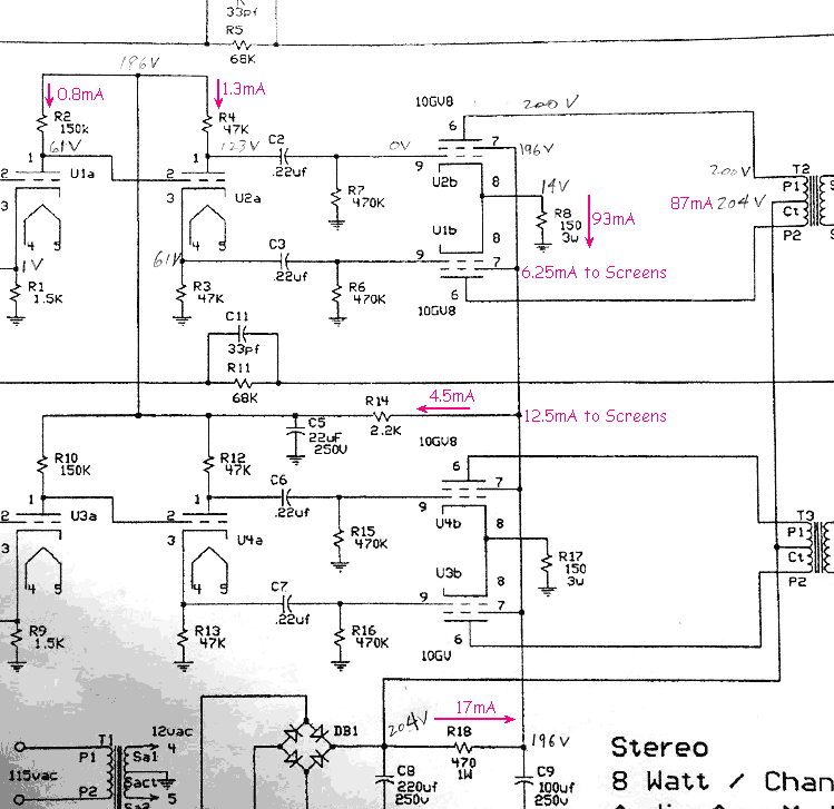

I have a K12-G from ~2007, and it too appears to be biased well beyond max. plate dissipation. Below is link showing the idle voltages I measured. When I did the math, I found that my idle current is dissipating 9.3W in the plate.
idle voltages for k12-g amp
Most data sheets suggest a max. plate dissipation of 7W. (Some also show 7W AND 9W, what's that mean!?). I'm going to reduce the power to lengthen tube life.
I'm considering putting in a 5-W potentiometer for the cathode bias resistor, and a "switchable" volt meter & amp meter (via switches I could assign these 2 meters to a particular tube, so that I can easily compute plate-power, and use the potentiometer to adjust bias.)
Thoughts on this modification?
Thanks all!
Thanks all!
Less. I get like 8.1 Watts/plate.
Ik/pair is 93mA, but about 6mA is screen current. Vpk is not 200V but 186V.
The 7W/9W ratings are explained in footnotes, but context has been lost. What were these tubes sold for? You on your test bench? Or many thousands of TV sets, maybe checked for picture but not verified in every detail? They want you to aim for <7W. This leaves room for manufacturing slop (tolerances) and miss-fit in the field (230V lines in a 220V district). The careful designer will also check for <9W "worst case", which is hard to define. This all smells of large safety-factor. The V-sweep tube of a TV is not a real critical part of design, but should not fail enough to get a bad reputation. 7W-9W will not make a TV model notorious.
Note also that in sweep work dissipation is nominally low but small circuit losses can raise dissipation greatly. It is not unusual for same-frame tubes to be rated 3/4 or 2/3rd when sold for TV sweep than when sold for audio which is much more consistent and much easier to measure.

I had the same issue with my fully-modded K12-G. Same symptoms. Mine had been heat-cycled every 24 as I played it each evening. So just because it was an easy task, I re-flowed the solder on the tube socket connections. Even the ones that looked fine.
Totally fixed the problem. Seemed to sound better, but that is a completely qualitative assessment.
