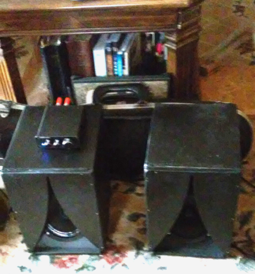

I tried a little Klam wth a BIC DV52si cab in it. Subjective testing it coupled a little better on low passages. The speaker low is supposedly 70Hz.
They sound pretty good with the BIC sub woofer in my system. I just did the subjective comparison with my K5/Xki and the BIC didn't do so well. It did a little better in the Klam.
Here's my little K5/Xki's with Bluetooth amp;

Hey EddieT - do you have a rough sketch of your K5 ? - I'd like to see the front cavity shape and depth to the. baffle-"reflector" apex.
No sketch, it's build was at least 25 years ago. Empty cab internal dimensions are 6½w x 8⅛d x 9h. The apex of the baffle and upper panel is 3⅜ in from the wings but the upper panel intersects the top at 1⅜ in from the wings (all measurements in inches).
The baffle was set at 60° and the upper panel probably at 45° with a ⅜ shelf between and now a ¾ vent with an Xki duct.
I appreciate you taking time to give those measurements and bet its really better than scaling the factory K8.
With the Xki inspired duct I am well pleased with the result. I will fine tune the rear chamber padding as soon as I can visit Lowes for some screws. I may use hex head sheet metal screws for ease of driving in/out for experimentation.

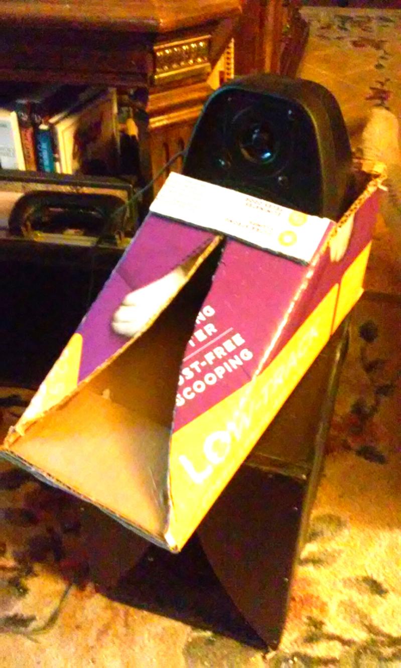

You might try a passive K-tube with your FR and XKi 5.
Make a tube of appropriate diameter and length to reach from the dustcap to the main aperture plane - - -have it suspended right over the dustcap (with sufficient gap as to not hit the cone on bass heavy passages). You could roll a paper tube and cut the slot with scissors. This extension is useful with deep Karlson coupler such as the clam/"klam type.
