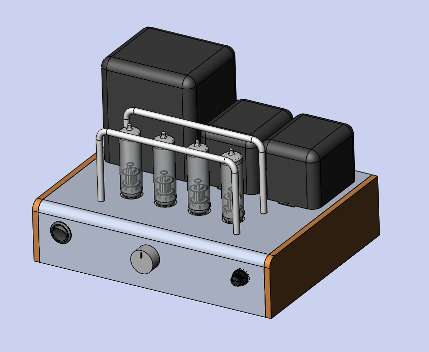

I built my K-502 Stock and have been enjoying listening to it as it. I decided to put a $100 shine on a $3 pair of shoes so I designed a housing for it.
