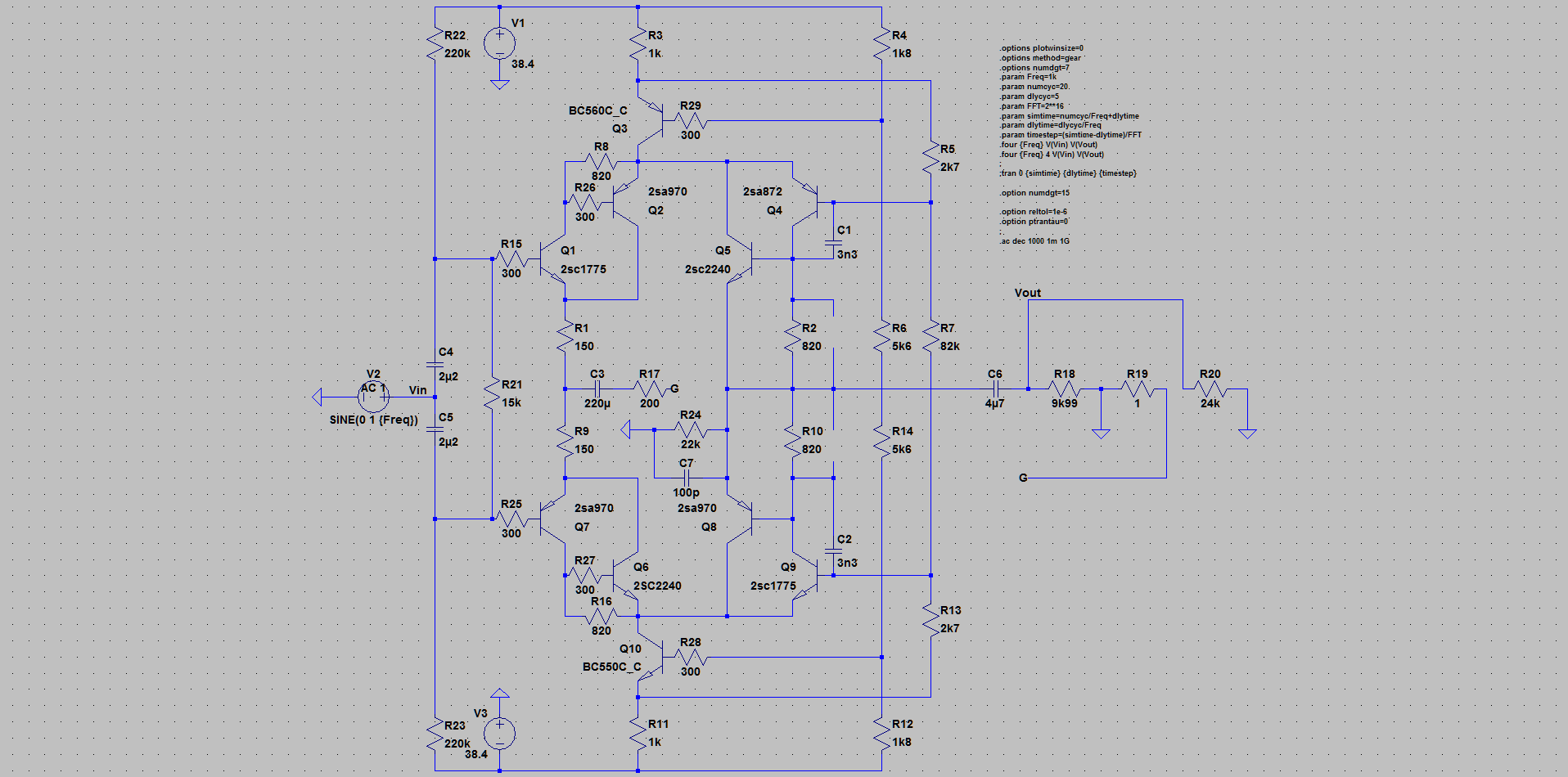

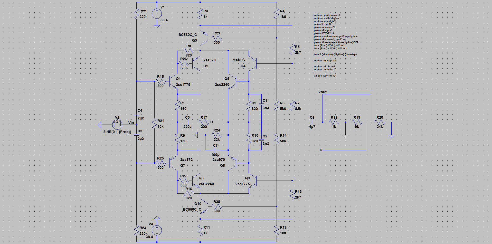

Hi!

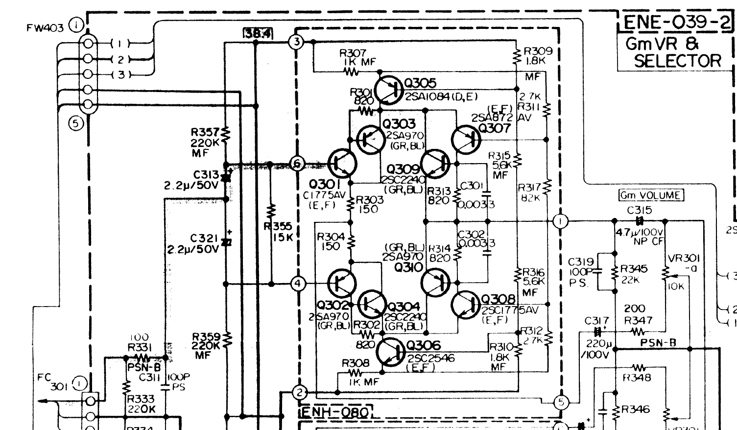

Last time I got JVC amp with Gm VR input circuit which is in fact ngnfb low noise input preamp.
Whole amp sounds wonderful with Magnepans.

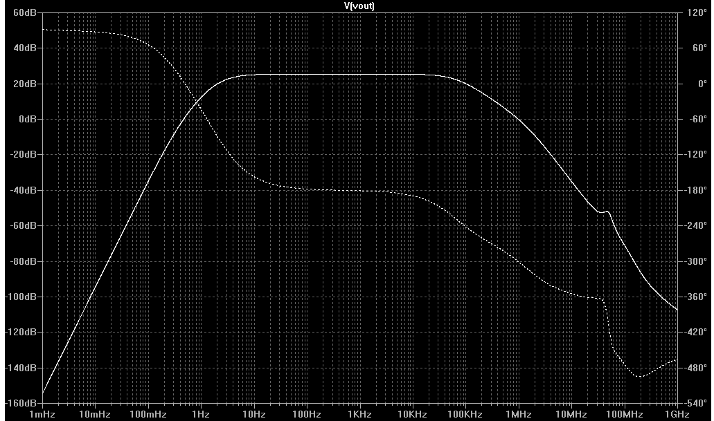

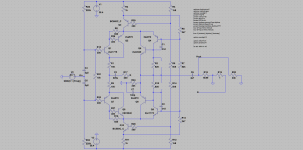

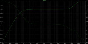

Further I wanted to learn more about it and made LtSpice sims of the input and power amp.

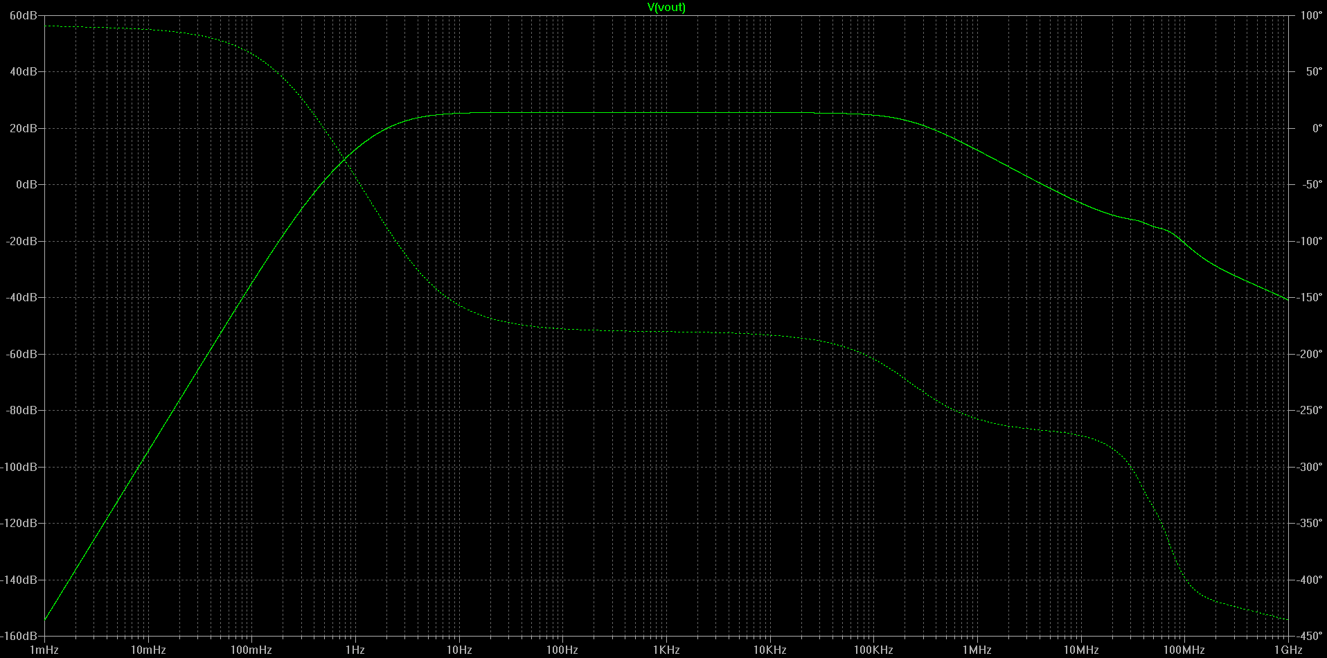

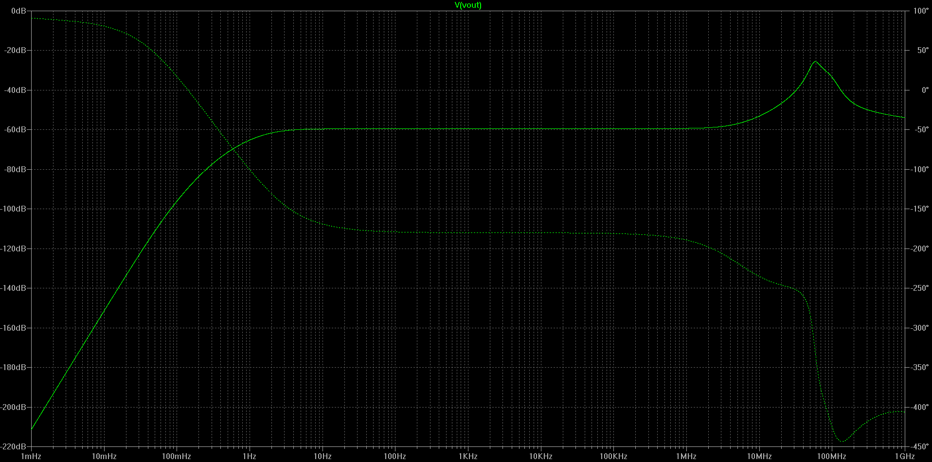

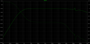

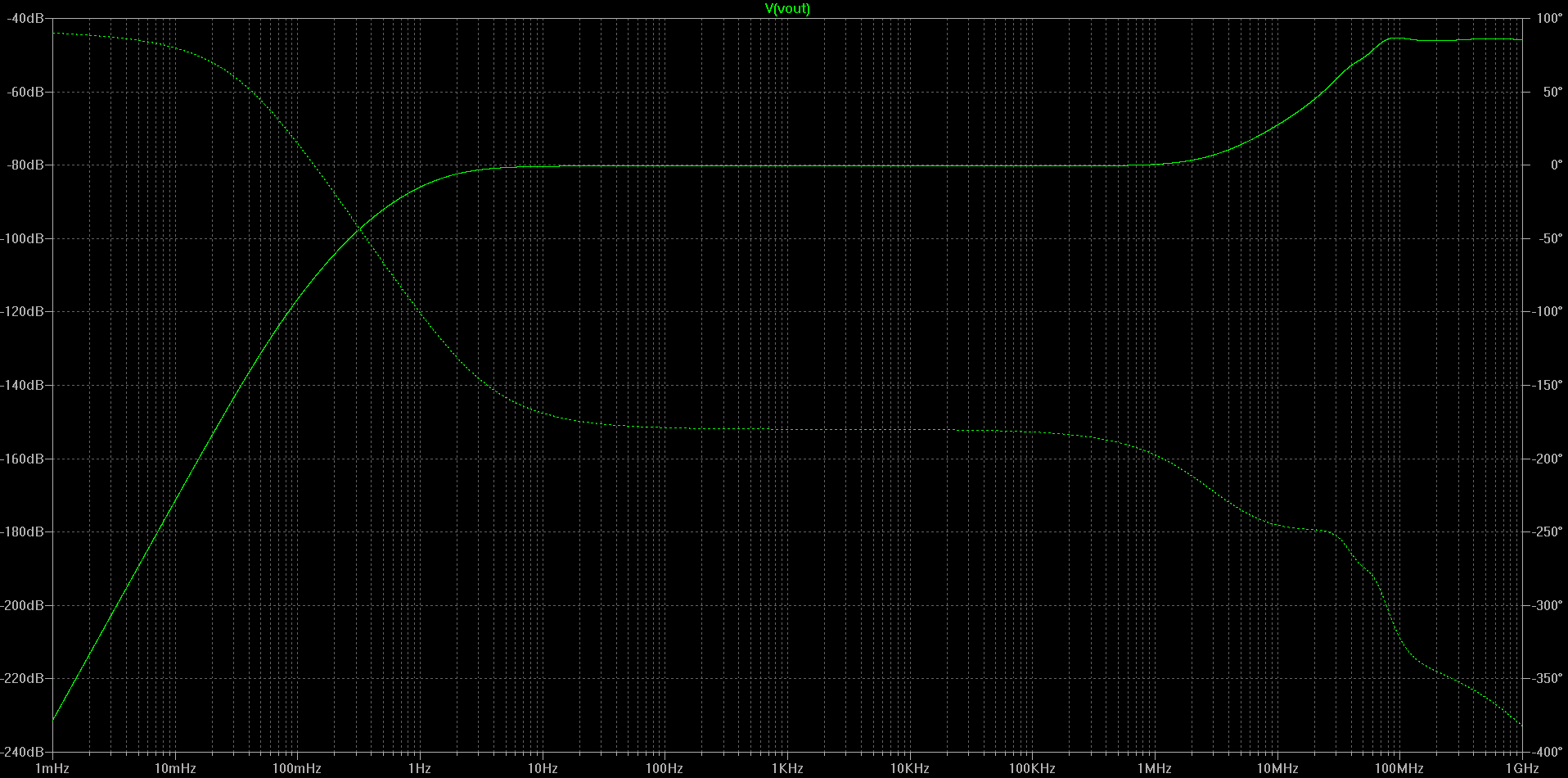

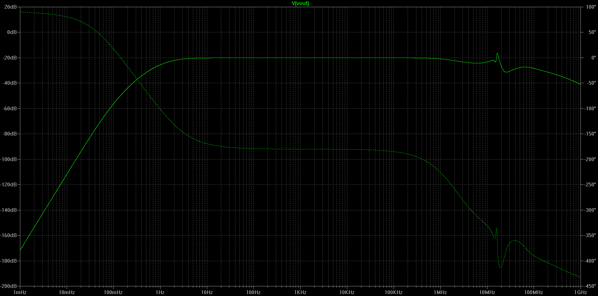

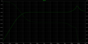

For Gm VR (and power section too) I have found that it has ~10MHz knee which is impossible for me to tame.
I tried to put the caps from bases to collectors of all of the transistors, in vain; the knee or even the pitch still existed.
I have changed the types of the transistors from original Japanese to BC550/560 but the oscillations were unchanged so I guess this is up to circuitry, not the transistors type.

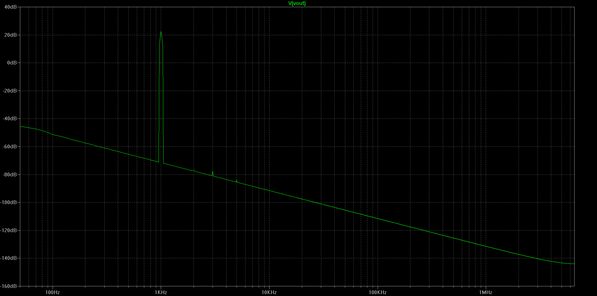

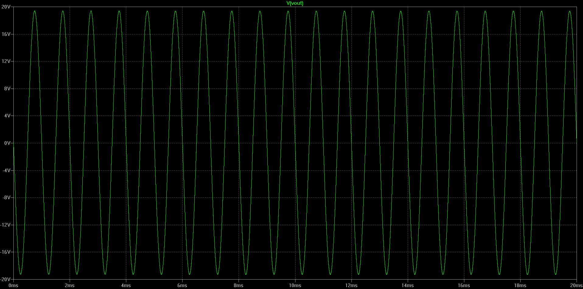

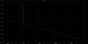

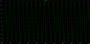

THD of the pre is excellent and at 1kHz 40Vpp at the output spice shows ~0.001% and HF harmonics are nicely descending. More, there is soft clipping with this pre.
R18,19 in real is a pot with grounded CT.
Just for the knowledge, please advise what techniques should I use to fight those ~10MHz peaks (even if they are nonexistent in real pre)?
Thank you in advance for any suggestions!

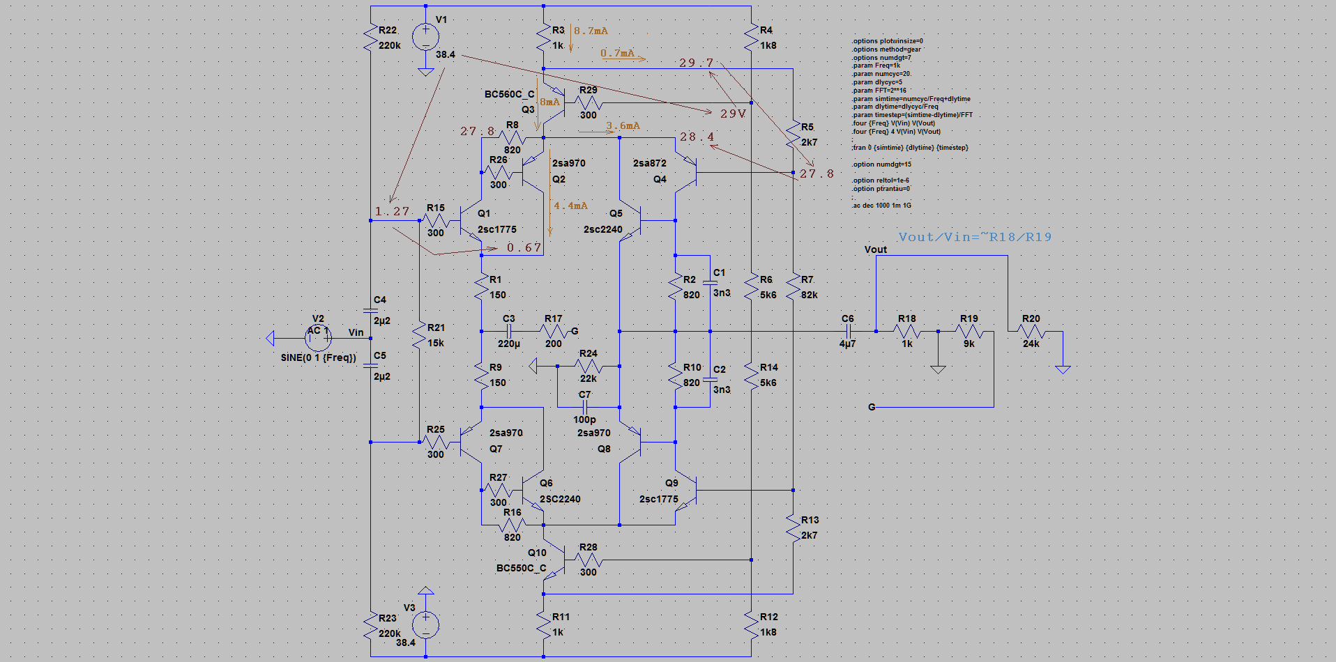

You'll find the 10MHz+ peaks disappear if you take R5, R13 to the supply rails rather than to the emitters of Q3,Q10. The enhanced ( aka Hawksford) cascodes are the culprits.
<edit> You will have to fiddle with the DC levels somewhat as those 1k emitter resistors have about 8V across them. I tested this with 8V voltage sources in series with the 2k7s.
Hi.
Gain=R18||R20/(R1||R9+R17+R19)
R24 fallen in disgrace ? 😀
This "pre" is a V-I converter. The transconductance is determined by R19+R17 (and a little bit by R1//R9) ,reverse value (resistor= V/A to A/V)
Gain is then transconductance x load (R18//R20//R24).Here R18 is that small you can forgett the others.
