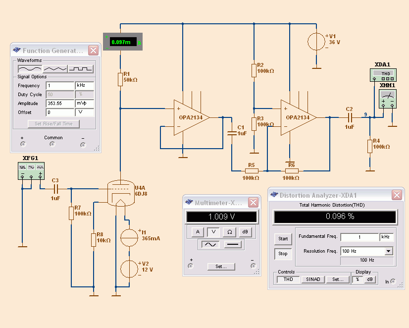

Here is a take on this concept.
I went for x4, gain=4 (+12db)
I use 36 Volt supply, as this is what opamps generally take.
I used input: 0.250Vrms
And Output: 1 Vrms
And I added Cathode resistance until I got to THD less than 0.1%
(Note that this is almost impossible att 12 V supply)
I now had 10k Cathode and 50k Anode resistors.
Now attach opamp.
The first half of OPA2134 is used to buffeer signal from Anode (and 50k)
The other half of OPA2134 is used as INVERTER to get signal back at phase.
OPA2134 is strong enough to drive HeadPhones.
Especially if they are higher impedance types, say 100, 200, 300 Ohm.
But think it would do well with 32 Ohm, too.
Here is my experiment curcuit, that works and avoids too much Distortions.
And Output: 1 Vrms
Now attach opamp.
Explanation of the circuit
Basically, this is a grounded cathode voltage amp followed by an opamp buffer.
For full understanding ignore the opamp stage and look at the tubed voltage amp.
Just cut (in memory) the wire between the tube and the opamp (+) input.
The triode is fixed-biased by the grid-charge current that flows through the 1meg resistor.
To explain this:
The hot cathode always emitts some electrons that have enough energy to fly up to the grid.
The grid resistor closes the current path between grid and cathode so that the grid discharges across the resistor and
following Ohm´s law builts up a negative voltage between grid and cathode = ground.
This way of biasing works for many small signal tubes like 6DJ8, ECC88, 6922 but also for 12AT7, 12AX7 etc..
It works for pentodes as well, like DAF96, 1T4.
It won’t work for power tubes like 2A3 or so because the bias voltage is in the range of -0.3..-0.8VDC only.
Choosing the value of the grid resistor:
It´s written in the books. It is that value named “max. grid resistor” and often is combined with the type of bias: Automatic or fixed. Choose the value for “fixed”.
Here I have to correct myself:
If the book says “fixed bias” this is for an external negative voltage to be applied to the grid.
If the book says “automatic bias” this is for the bias acquired by a cathode resistor.
Most books don’t say anything about “grid-leakage bias” !!! If there is a value, use it.
If not: Use the value for automatic bias and multiply it by 10.
In my circuit the R1 value should be up to 10 megOhm .
The circuit works ok for R1 = 1megOhm but one can be sure that there is a small amount of grid current flowing.
Choosing a plate resistor:
Normally you would take the value off the data book, too. But in this case it is not possible because the plate voltage is so low that no curves exist for most
of the tubes.
Here is a procedure how to get a value without curve-tracing.
The plate resistor value is chosen that it will consume 4..6 V from the 12 V DC power. I recommed that this resistor is adjustable if you use any other tube than the 6DJ8
series or want to use other supply voltages.
Always adjust the plate resistor to consume 1/2 to 1/3 of the supply voltage.
If you try pentodes the plate resistor may consume up to 2/3 of the supply voltage.
Start with a high value, up to 200kOhm, and adjust to lower while continously measuring the voltage between plate and B+ until it fits.
Now take the adjustable resistor off the circuit and measure the resistance. You now may choose the standard value nearest to the result of the measurement.
An amplified input signal can now be seen at the opamp (+) input if we “repair” the wire we cut above.
The opamp in the prototype is an NJM4456 dual opamp. It is able to feed as much as 70mA into a 150 Ohm load.
The NJM is not as “hot” as modern opamps with enormous high gain-bandwidth products. So it is not very likely that you will have problems with noise or oszillation.
You may also try other opamps like NE5532 or OPA2134 or so. Make sure that they are “unity gain stable”. That means they will work flawlessly at a gain of 1.
That´s the configuration we need. We wire the output to the negative input and feed the signal into the positive input. From the DC point of view this input sits at
about 1/2 of the supply voltage, according how exactly you have chosen the plate resistor. In steady-state the output of the opamp follows the input (with a gain of 1 here)
and therefore sits at 1/2 of the supply voltage, too.
