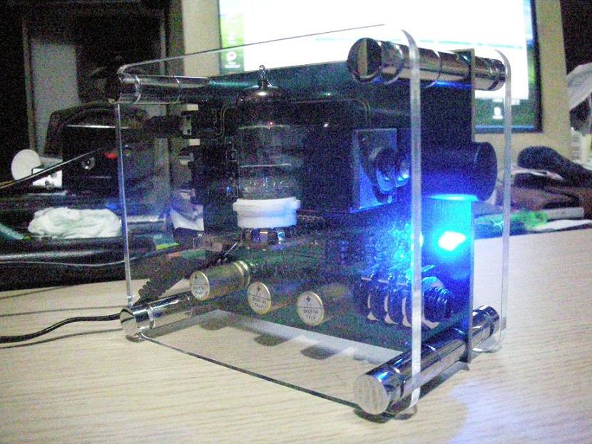

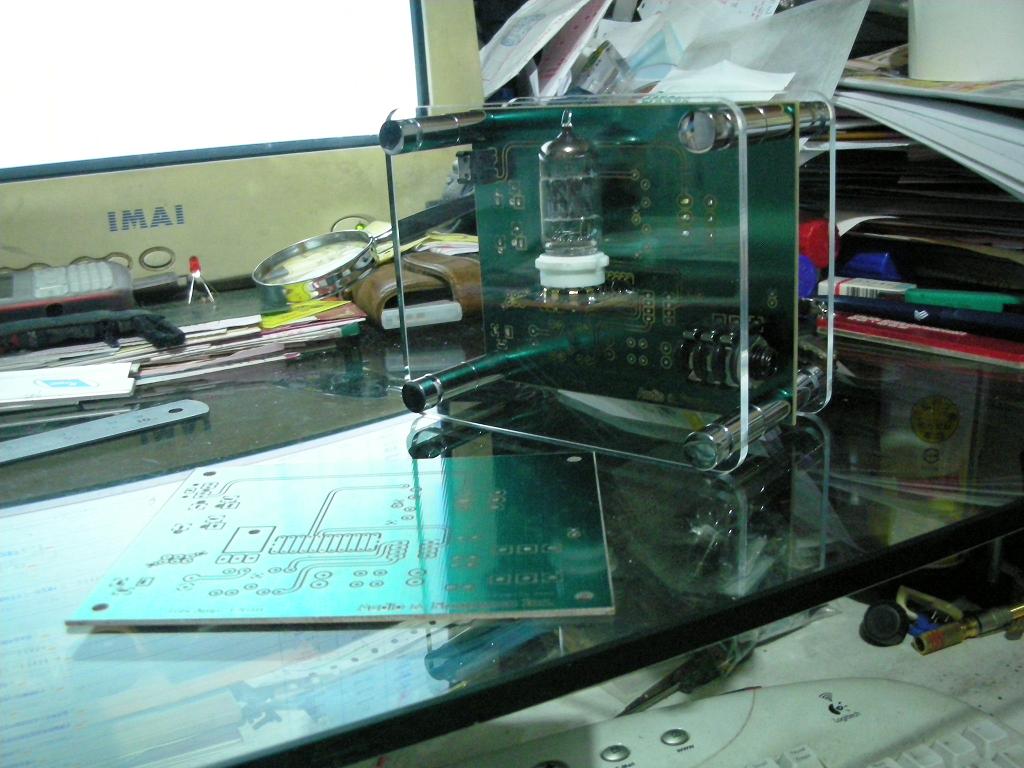

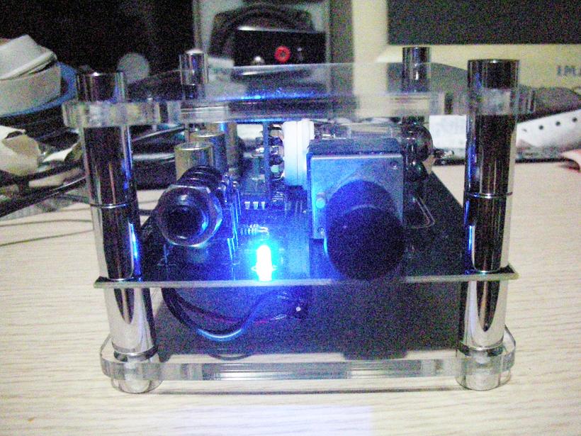

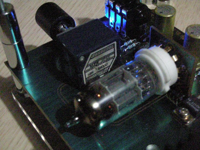

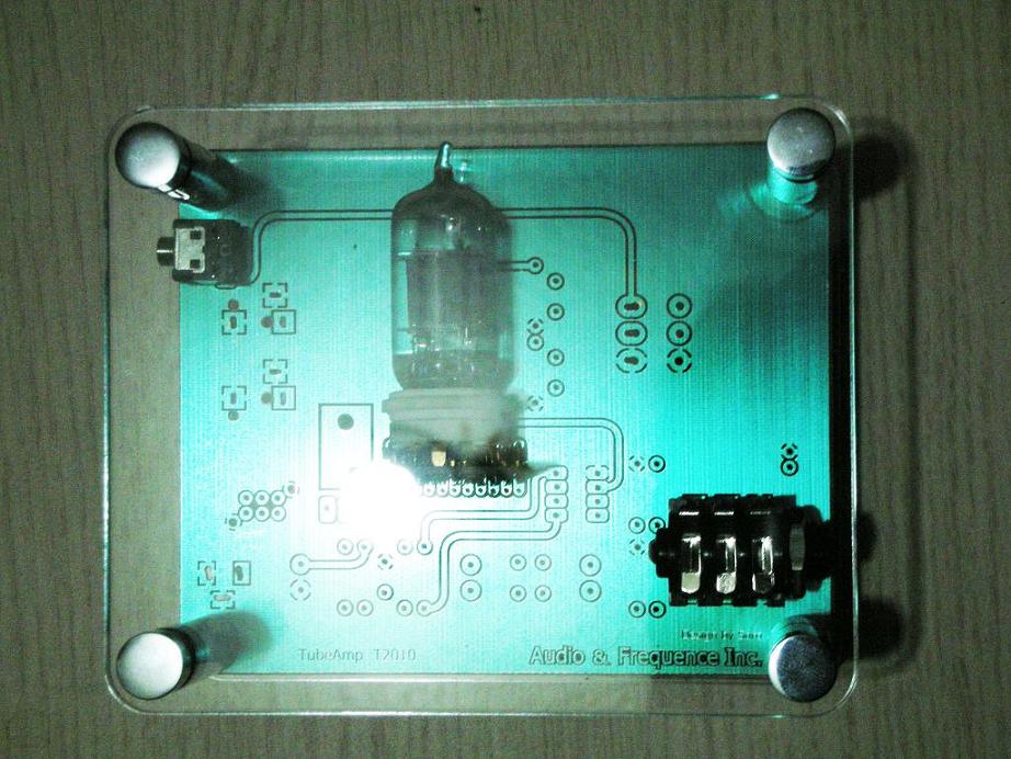

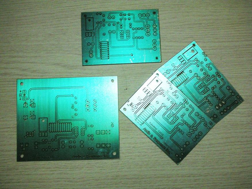

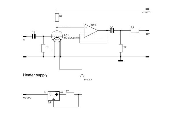

just plan to make a headphono amp
just look.
But since this is the solidstate forum ( we hate tubes:gnasher: )
Speak for your self, tubes are cool (as in neat, not literally).......and they make great amplifiers.🙂
Just most people here have more experience with sand than those empty glass thingies.😛
incidently, I've never seen a triode work linearly at 12V plate voltage, seems a bit low......and direct coupled to an op-amp without coupling cap and DC reference for op-amp.:beady:
Firstly let us say Hi to forum🙂
1)For the gain>=5 opa637 is very good and stable.If gain <=5 opa627 is stable and good
2)Some people use in inverting mode.I am not sure why people does not want to invert the signal.Maybe it is about phase shift
3)Yes i remember that a tube headphone amp works at 9vdc
