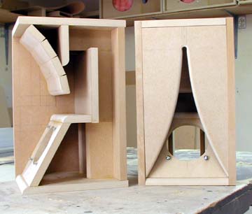

hybrid Karlson/Transmission Line cabinet
I have built a number of hybrid Karlson/Transmission Line cabinets for a number of Fostex drivers. Currently I am running a set of fe166e's as well as fe126e's in these cabinets. I have run both fe167's as well as fe127's in these cabinets. I have included a photo of an early version of the cabinet used for the fe 127/126e driver. The benefit of this cabinet is that it provides a significant load to both sides of the driver. This then generates a very good impedance match between the driver and the air in the room which results in excellent output with the limited excersion these drivers have.
This idea is not the norm that I have seen on these forums and is very different from what common wisdom would call for but the cabinet is compact while its structure is very ridgid and bass response is better than I had hoped for. I do not have any measurements to supply but I have previously built ML TL for both of these (all four) drivers and find the hybrid K-Line to have superiour bass performance. Best regards Moray James. I don't know if the photo will attach but if it does you can get the general idea of this design. can't seem to paste the photo perhaps someone could walk me through it?
