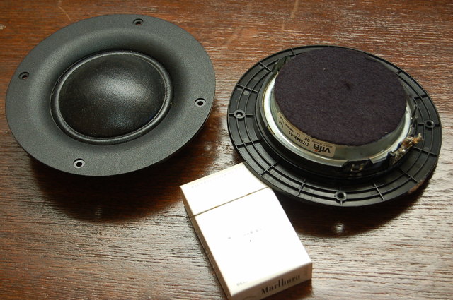

The sound quality of the mid is still bothering me, the dome sounds great but getting it to integrate with the rest of the speaker is a nightmare (i.e. sounds great on it's own but less good when connected with the woofer/tweeter). I should point out that it still isn't sealed, and it only has one screw holding it to the baffle, as the person who build these was incapable of drilling more than one hole with any accuracy (!)
You really must chamber the mid before doing anything else. Otherwise it's acting as a passive radiator for the woofer, which will drive the mid's coil outside of its Xmax and make it sound incredibly bad, if not damage it. And of course you lose any acoustic support to the mid that the chamber might provide.
Oh, I did not see this - it MUST be sealed!The sound quality of the mid is still bothering me,
laplace is absolutely right about that.

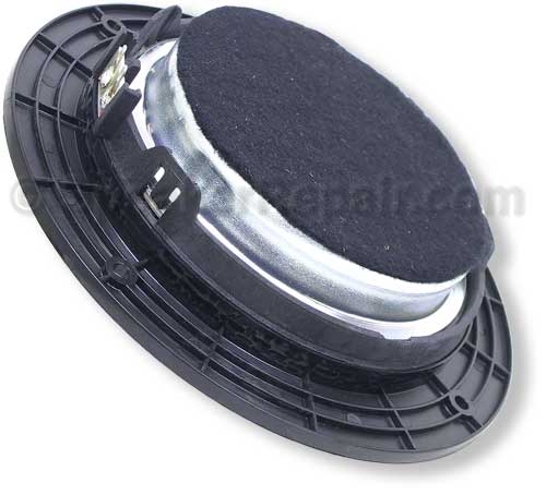

the Vifa mid dome does not have a back cup, but I do not think its open back either ... is it ?
or maybe there is the magnet venting hole ?
in which case the cup should just fit the magnet
many pics show a piece of felt placed on back of the magnet

Really looks sealed by this.....
Really couldn't hurt by enclosing it with 2-3 Liters worth. If it does have a pole-piece vent hole beneath that felt !@#$ , no wonder! All that pressure setting the dome in motion!

The mid dome needs to have a rear sealed chamber.
This will bring up its low end response but also Fb and Qb.
The x/o cannot be designed properly without the rear chamber.
You may or may not get away with not compensating
the mids Fb impedance peak, modelling will reveal all.

... Ok, so I can only find the sealed seas chamber in the US, and the cost of delivery (about $40) means they're not gonna happen, I'm currently thinking to use a 2 litre soda bottle as a former to build my own chamber unit, just wondered if anyone had any suggestion of how best to do it? (i.e. what material to use, if I should keep the plastic bottle or just use it as a mold etc) or even if there's a simpler way to make a 1.7 litre chamber...
I thought about that, but the easy availability of a 1.7 litre mold (well, 2 litre, but would be cut down and molded inside so would come up very close to 1.7) may be something to capitalise on, maybe with a resin and mesh?
Plastic bottle is too thin, it will flex by woofer action and pump air inside the dome midrange. Use thick plastic flower pot instead (do not forget to seal the bottom hole!).I'm currently thinking to use a 2 litre soda bottle as a former to build my own chamber unit, just wondered if anyone had any suggestion of how best to do it? (i.e. what material to use, if I should keep the plastic bottle or just use it as a mold etc) or even if there's a simpler way to make a 1.7 litre chamber...

For a quick and easy back chamber one can also use the large diameter PVC pipe and endcaps from your local Home Despot and trim for correct volume. Works great!!
I'm not sure where you are out what their shipping cost is, but I've previously bought very cheap chambers from madisound.
Failing that, I think the PVC drain pipe option is very good; you can use an end cap as a kind of reverse flange too.
