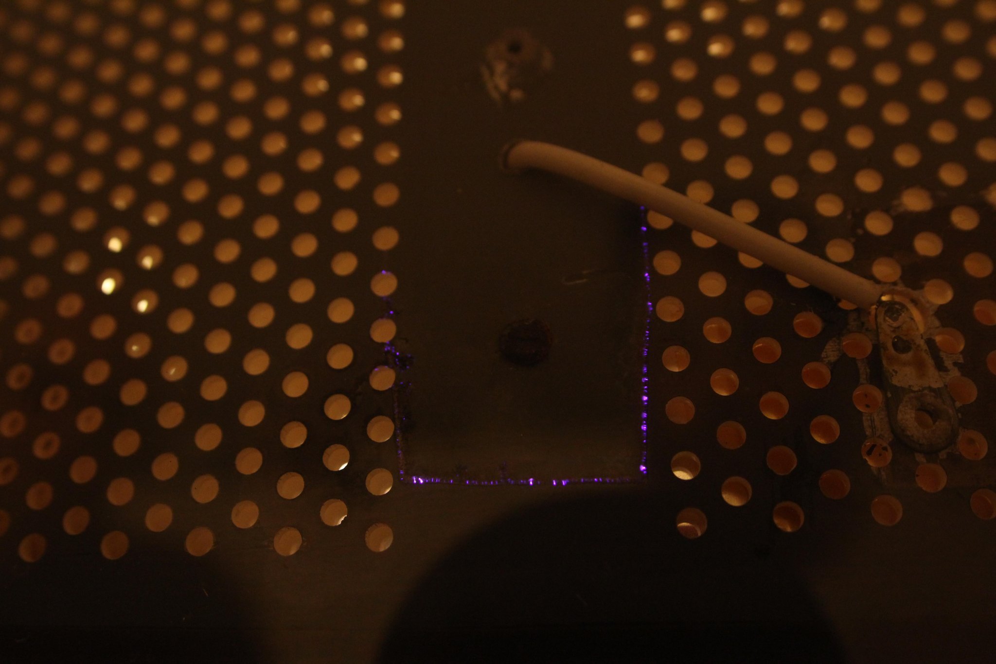

But I made also a mistake: as you can see on this picture, I retouched the grey paint on the stator edges with Tamiya XF-54 Dark Sea Grey model paint. And there are some faint buzzing sounds that one can hear from very close. I contacted Tamiya and they wrote it contains Titanium Dioxide TiO2. On the net I found it is a semiconductor 🙁 titanium dioxide electrical conductivity - Google Search
So probable it creates a leak path. My son can hear the squeak from normal listening distance, I can't

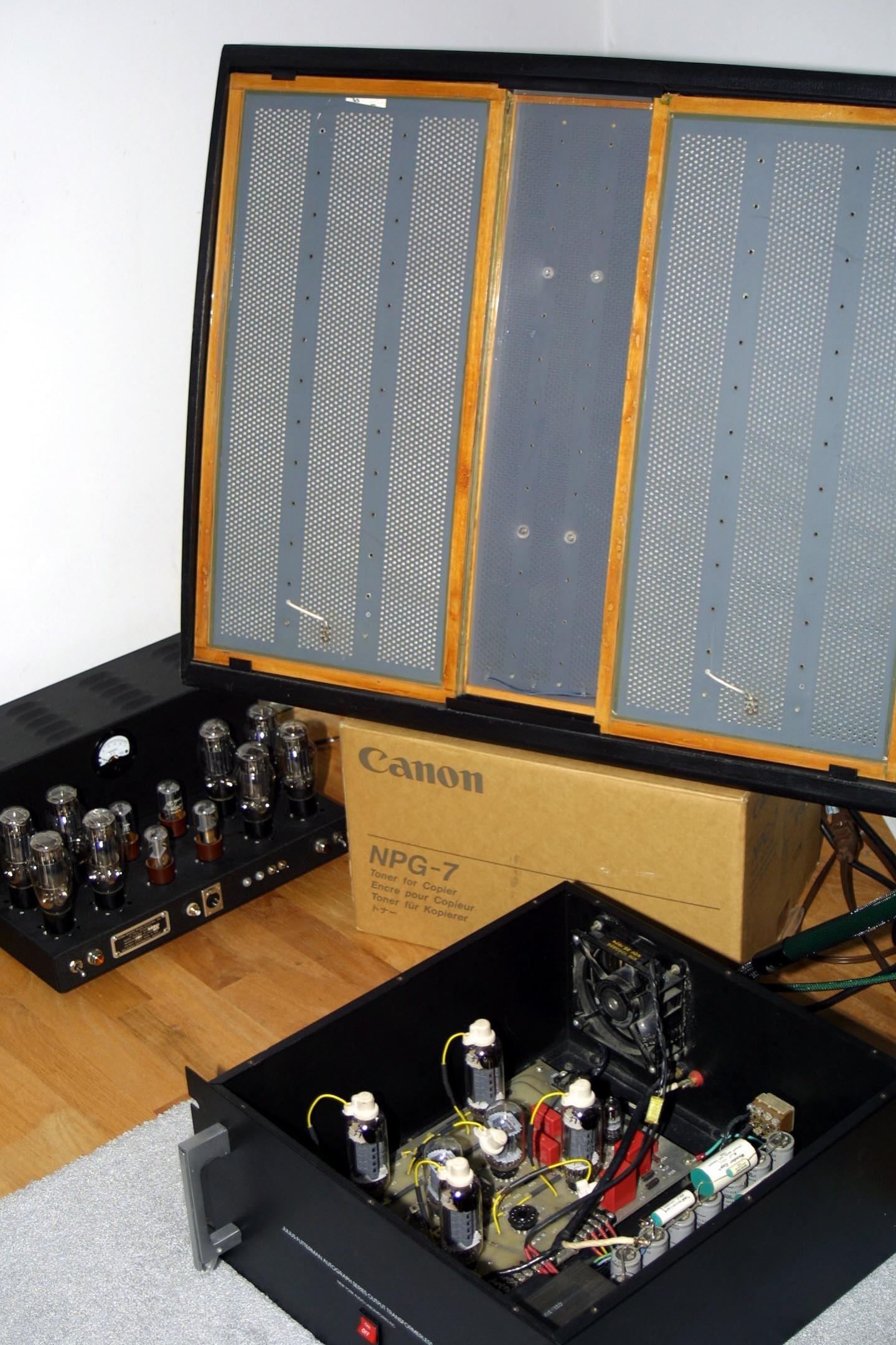

Magic of the 57's
I have *ideas*, but am reluctant to "do the work myself"
I have owned mine for 37 years, came out of a Levinson HQD
system (one of 2 in KC area), mine were pulled straight from
the frames, as nude Quads ~ they .are. open sounding... LOLS.
I spoke with Kent @ Electrostatic Solutions, KCMO
(have known him for over 40 years) He is "the man"
one of few, that I would implicitly trust with mine.

That said I inherited a pair of ESL63's needing rebuild,
they sit... I ponder them... as an even bigger challenge.
The image (as shown) was the last time I experienced
the 57 drive by Futterman OTL-3 amps [ M A G I C ]
Every music lover should own a pair of Quad 57s

Are you still dealing with a "sizzling" sound? That's likely describing HV leakage that is sometimes accompanied by a violet colored plasma near the rivets that hold the bass panels together. The dust covers are not too difficult to replace. I use 3M window insulation and the 2-sided tape that comes with the kit.
