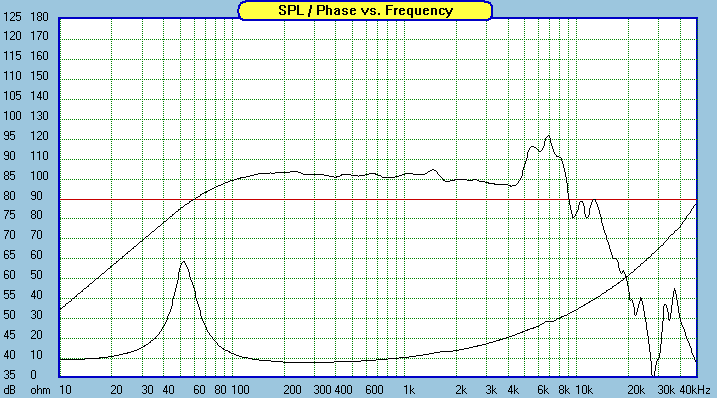

...do we believe the bass in this freq. response graph? As drawn, bass is MUCH better than the 5 - 5.5 inch drivers I have been seeing, yet, my speakers are not producing much bass. The previous woofers (blown) pumped out a lot more.
Perhaps for "real bass", I should be looking at another type of spec, not the 50-100hz area in a freq. response graph? Or, maybe this graph is just wrong?
To see what drivers are capable of you need to simulate with their T/S parameters in a suitable box design program. WinISD should be fine for this.
The silverflute driver that you have is the one that Zaph measured and used in his design.
It is easy to see why you are not happy as the driver has a massive peak close to where the crossover frequency is supposed to be.

If new boxes are to be built etc then building a proper kit would be the best advice I could give. If parts are available one of Zaph's cheap designs would be a good option.
Still I think using the FRD consortium xover designer tools would get you decent results if used correctly.
One has to look at this in terms of cost vs effect and so far we're talking cheap parts, so I doubt ultimate fidelity is of the order. However having said this all the available options do require the spending of some money. Both the scanspeak driver and the vifa one cost decent money, we're talking ~$140 for the pair and you're still a good crossover short. You could buy the Zaph audio 5.2 TM kit for $200 and put that into the cabinet, it's not perfect as the Zaph design isn't suited to the sloping baffle, nor is it suited for a 6.75" wide cabinet, but the design should work reasonably well and be a lot better then any badly put together design.
