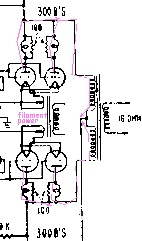

Didn't you guys check the original schematic instead starting the usual blah-blahing all over the place?? 🙄🙁😱
Please re-read the circuit. The transformer in the cathode is a power transformer to heat the filaments. The audio power comes out the plates to the audio transformer, just like 99% of all tube amps do.
The special advantage of class 2 (grid current) operation is Increased Current. There should then be no question "Why?" the load impedance was reduced.
Yes, the 300B is not specified for grid current; its special claim is high plate current without entering grid current operation. It might burn-up. At least too often for theater or home use, perhaps hours per day. However this application is Disk Cutting. Less than 20 minutes per side, much prep and post-work so maybe two sessions per day. If that day is billed at $1,000, and new 300Bs sold for $50 at the time, occasional trouble is affordable. (That's another reason to double-up: if a tube dies mid-side, the amp will "work" to finish cutting the side, and the part-power situation may not be noticed unless a MAX peak comes along.)
You are right PRR, I read it like the cathode windings are part of the output transformer.
