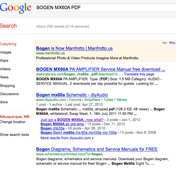

Anyone here got the owners manual? (thats my first order of business)
