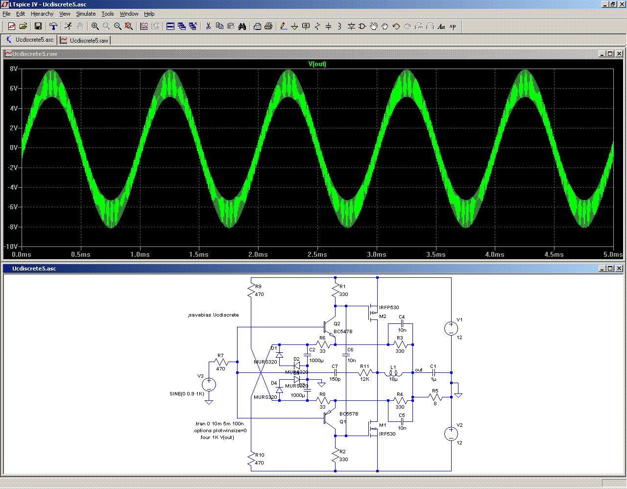

Just for fun: UcD on a shoestring
What is the role of R2 and R10?
They are pull up/down
The diodes as bias reference work fine:
