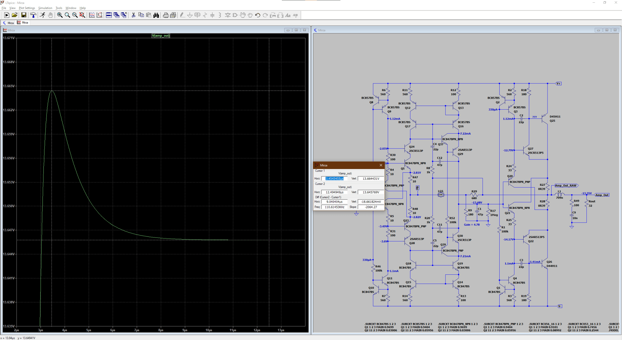

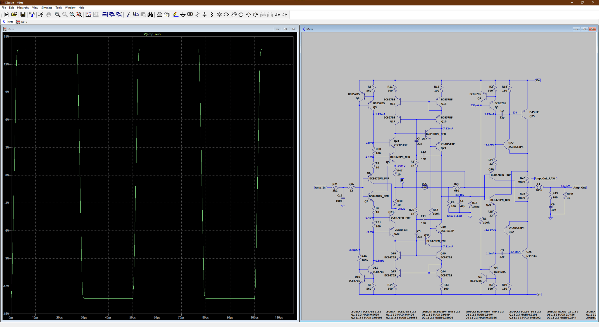

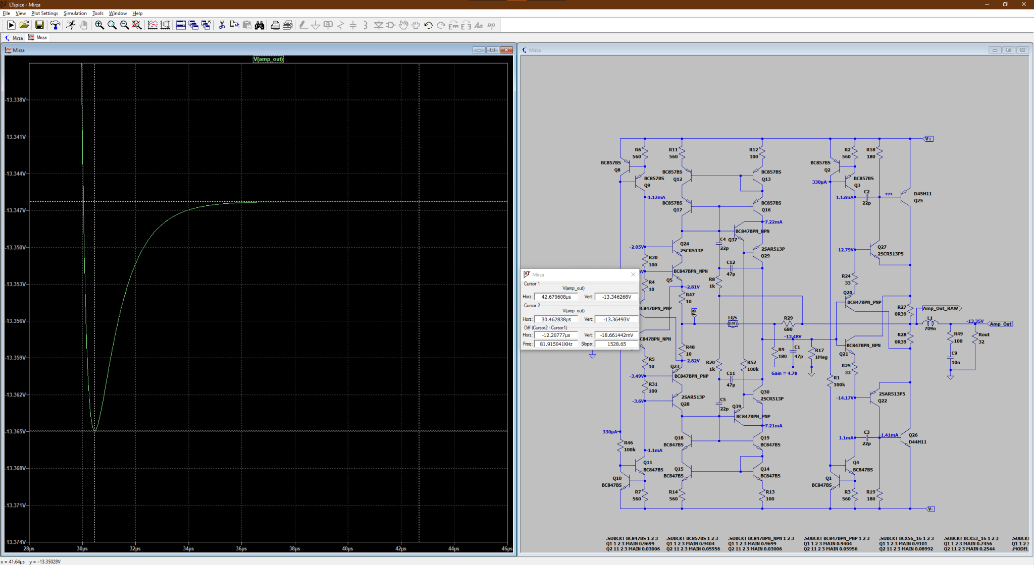

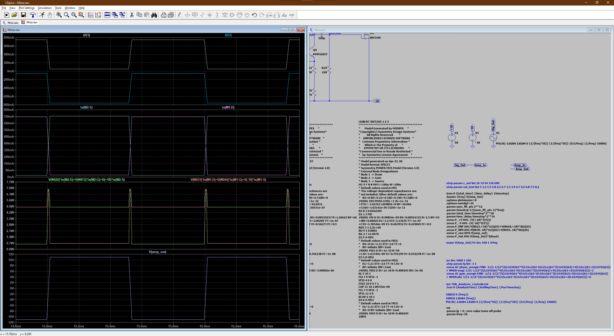

Also, square wave performance at 20kHz with 2u rise/fall times. There's ~19mV of overshoot but overall pretty well-behaved.

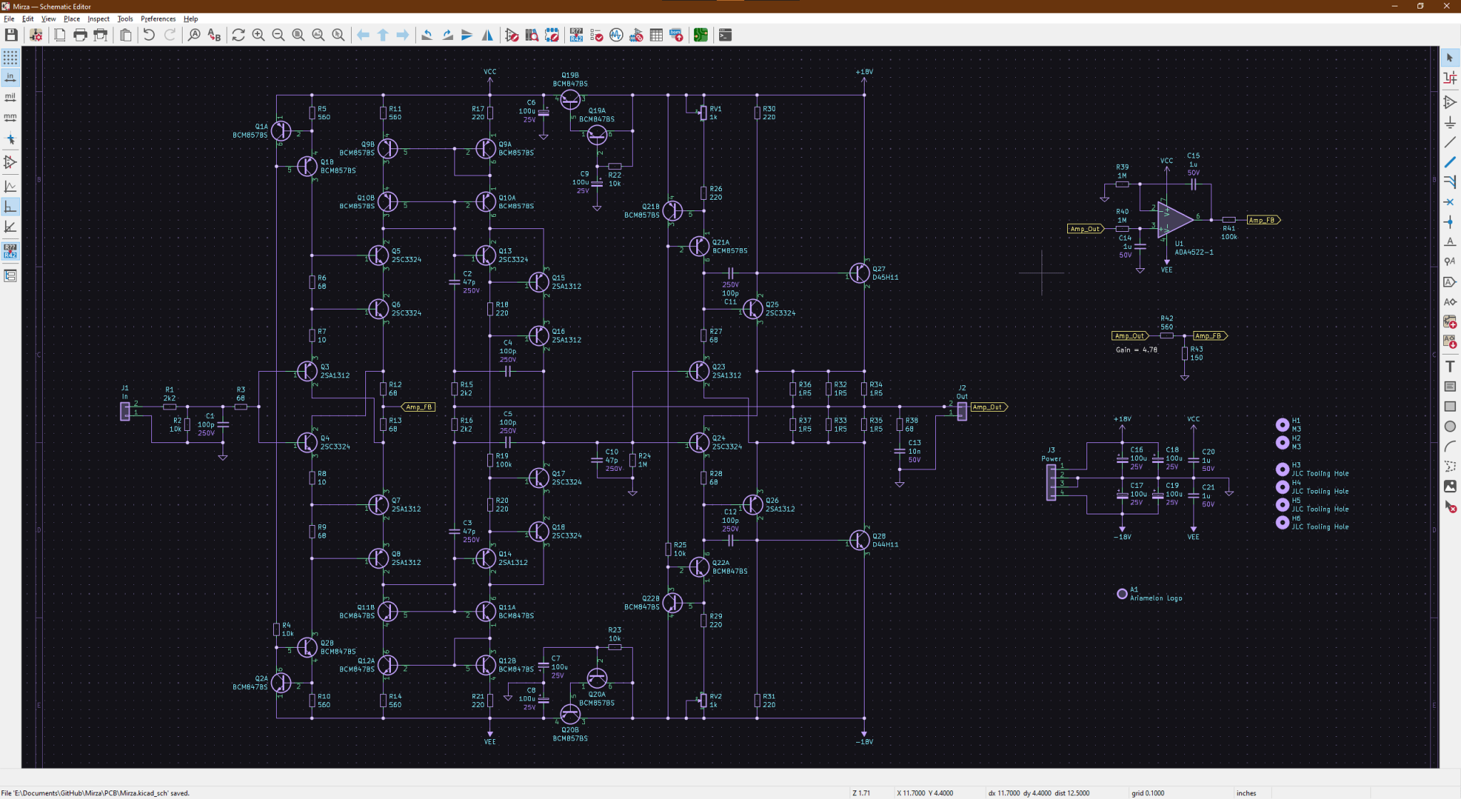

Thank you! I revised it as I'd actually accidentally flipped the symbol for the D45H11 in the schematic...

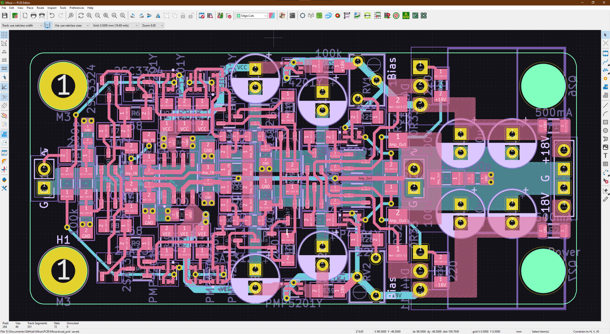

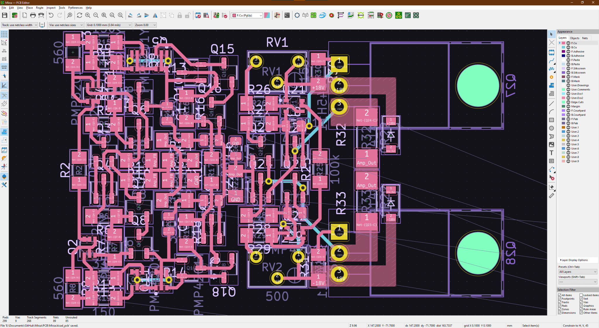

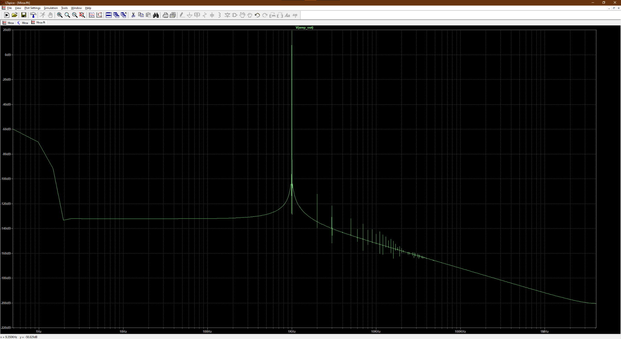

Should mention too that I separated the VAS and input stages from the output stage with a capacitance multiplier using one dual BJT per rail. Should give me lots of PSRR rejection! I also changed the DC servo opamp to an ADA4522-1.

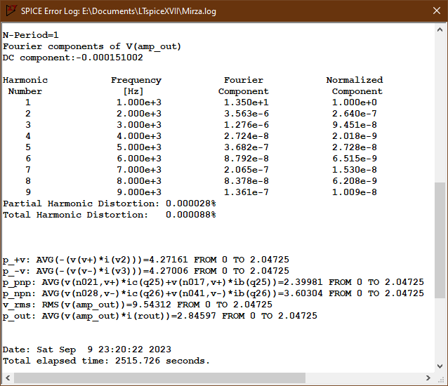

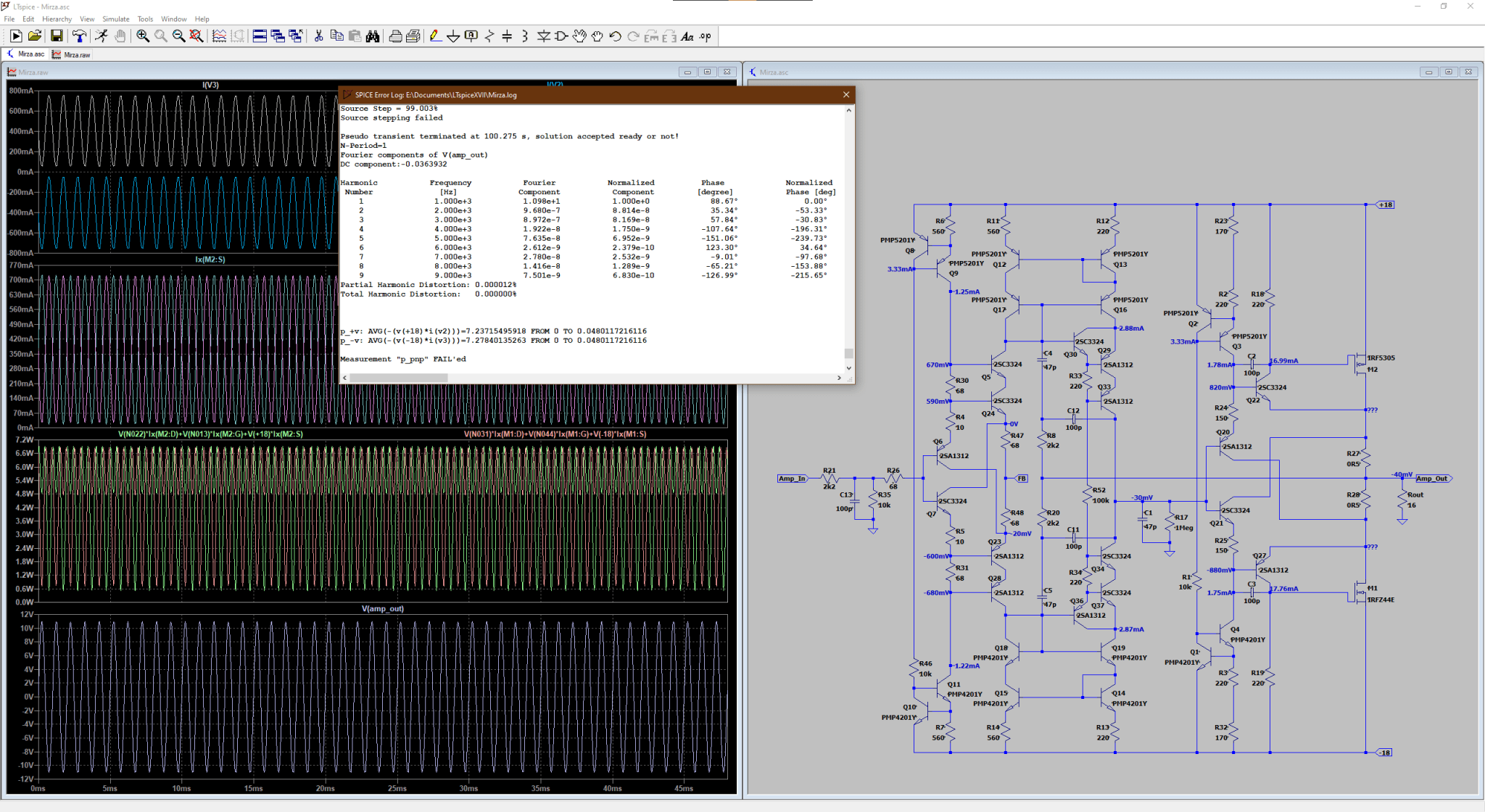

Also, the circuit works with mosfets too, at least in simulation. I'll definitely have to play around with the boards once I get the built, but SPICE shows no issues so far.

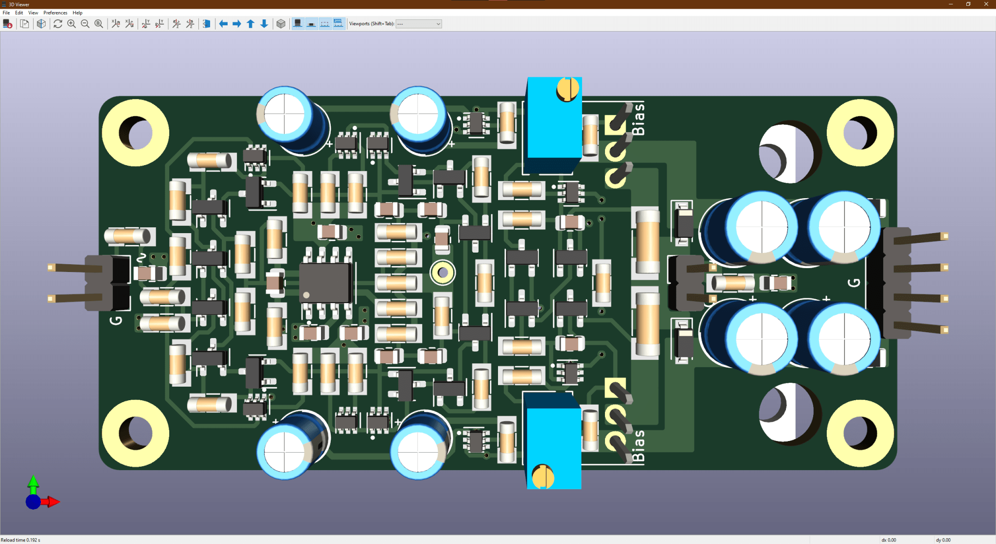

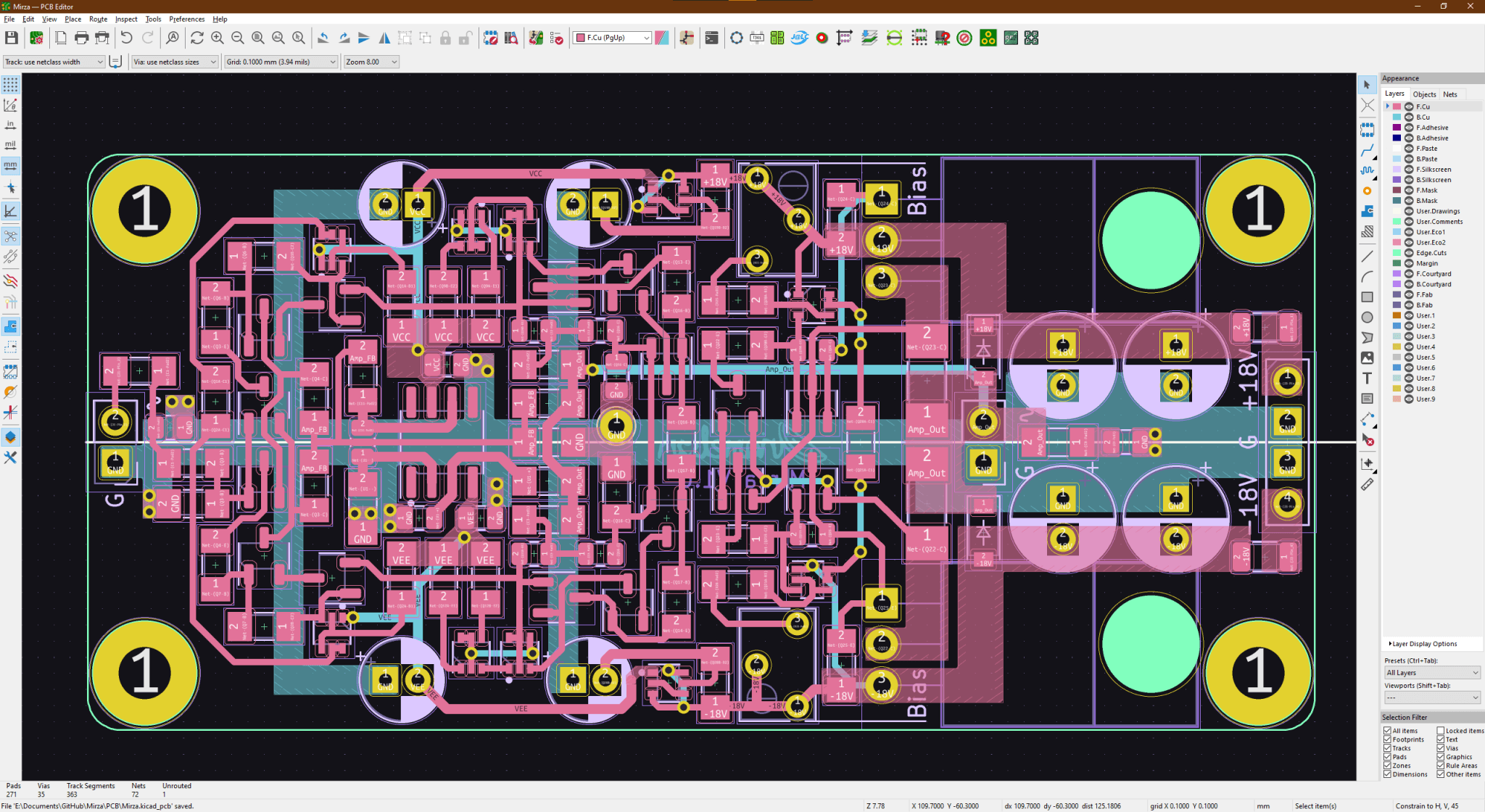

I got the boards sent to my home country to avoid VAT (along with the parts for it) but haven't received them as a result, I'm this close to just getting another set of boards done ahah
I originally designed it for BC8x7 so it'll work with some modifying of values
