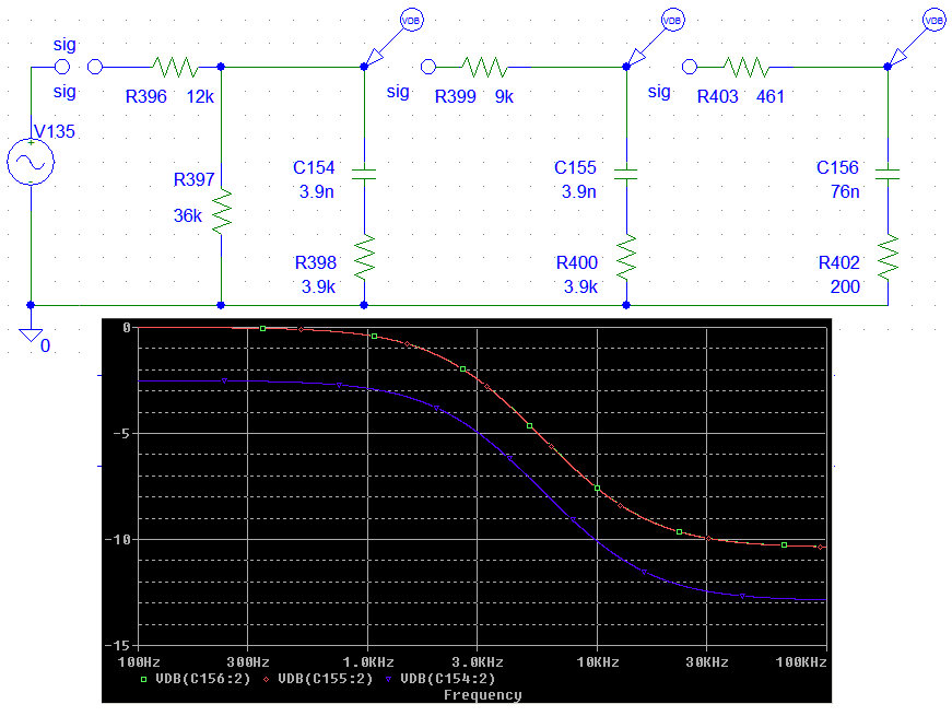

Two time-constants 50μS and 15μS. Ends up near -10.46dB

A lazy web-search turns up https://offset.skew.org/wiki/User:Mjb/Time-constant-based_EQ which leads to https://www.radonmaster.de/robernd/tAFILTER.html which seems to be an exact implementation. However the loss is non-zero and the impedance is high, so I re-scaled it.
Original, loss taken out, and Z scaled down.
Note that most CD players have some series resistance on the output, and for many popular-price boxes it may be 470Ω. IF so, you will be super close putting 76nFd and 200Ω across the output.

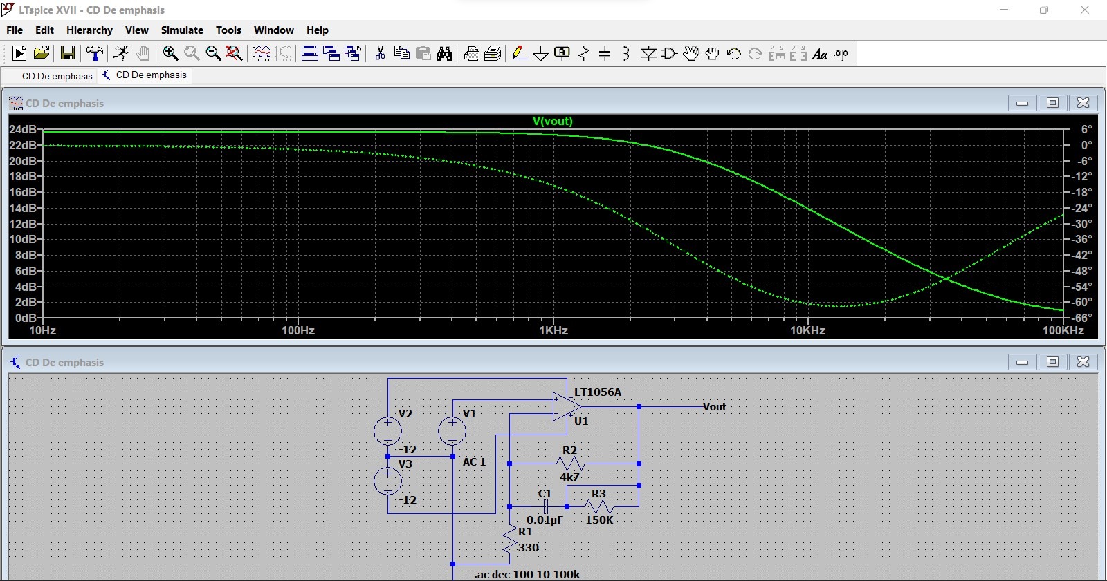

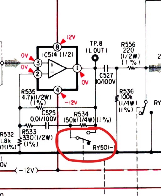

Why not look at some old service manuals to see how it was implemented. You could model (simulate) the circuit and then design your own to match if you wish. The inductors you mention may well be part of the early 'brickwall' filters that early players used to provide a steep cut beyond 20kHz.
This is from a CDP101 which should have it absolutely correct.
