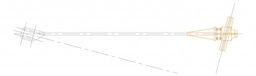

I have done the plinth in MDF/birch ply laminated. The very core will be Lexan, which I hope to back-light so the table 'glows' when it is on. Should look cool!
I am designing my main bearing now. Probably another 3-4 hours designing, and then I can cut material.
I have found a DC motor that I like WAY overkill for this use, but better too big than too small. Should be ordering that this week or next.
I am going to make my tonearm 14.2" long, so an off the shelf arm will not do much other than give mt specific dimensions and design ideas. BUT, I am still looking for any and all unwanted tonearms (in any condition!)
It is going slow, but it is going. I hope to have this done by the end of the summer.

Here's some pictures too!
First one is the first idea for the look. I cut some scrap material at 30 degrees back-angle to have the lexan recessed into the plinth. It looks cool, but the resultant sharp top edges seem too fragile, and will end up breaking off over time.
So, I have a new design I will mock up tonight.
Second photo is just the 20 X 20 pieces ready for additional work...

I have found and read more on turntable and tonearm design considerations than any human should have to endure. BUT, I have finalized the drawings of my (scratch built) tonearm- Version three- and I'm having parts made now (well, when he has time anyway). The arm will be carbon and OFC. It should look pretty nice!
The platen bearing was also scrapped in favor of a complete redesign (yet to be done). I want to use an inverted bearing, but recently learned quite a bit about proper platen design and intend to follow that. I also want it to be an oil-bathed inverted bearing, and making all that happen is a bit difficult with gravity being what it is and all (damn physics!)
So that's the update. Not much of one really, but I easily have 60-80 (part time) hours into the tonearm design, with a few components left to design.

Jim, the engineering required to do a good "oil pump" type inverted bearing is not trivial (I know you didn't suggest that it was). For a start I'd suggest using a salvaged bearing/platter to get you going. Then if you like take the time to do a prototype, knowing that it may need to re-worked, or re-designed.
You may consider purchasing a unit that is pre-built, such as seen here. $115 + freight...
There may be others, but this seems like a pretty reasonable price.

Thanks Stew, both for the marital advice and the bearing link.
I was initially going to use that very bearing (and the platter they offer- they also sell a decent motor package as well, making the project rather 'easy') but have learned that I would feel better if I made it rather than simply assembling it (I have no such ambitions when it comes to electronics, however).
So, an inverted bearing such as that is OK; however there is a great deal of surface area on the sides which allow the 'pump' to work. And, that pumping causes additional drag (above and beyond the increased surface area), which will slow the platter. And the better the pump works, the worse the drag, because the oil is pushed up, but is dead-ended. In fact, the oil could potentially trap an air bubble and then you'd have the disadvantage of oil drag without the advantage of oil! (but I doubt that would happen) plus how long does it have to run dry before oil finds its way between the bearing and thrust plate?
We need an inverted bearing, with the pivot just above the center of gravity of the platter, and bathed in oil. At the bottom of the bearing, the smallest 'guide' possible to keep the bearing straight. Like I eluded to earlier- the more I learn, the more I need to know...
Oh, and we need an opposing force opposite the drive motor (in the case of a belt drive) to offset the force of the drive belt. I have a unique idea for that that I have to attempt to implement (I've never seen my particular idea for this before). This also adds additional drag on the platter... And so it goes...

well you could always make a rim drive and then it doesn't matter.
One thing that lots of folks usually don't take into consideration is the drag caused by the oil, a point well stated. And surface area is a critical as well.
I like the idea that Roksan used in the Xerxes: a long, thin bearing at a quite small diameter. And they also addressed tension in the belt, allowing the motor to rotate , but held at a constant force by a spring.
One way I've thought that could be implemented would be to use an idler pulley (much like an automotive belt tensioner, where the tension can be adjusted and that it will keep it constant based on using a spring attached to the tensioner arm.
Regarding the tonearm, how about a Nanook 219? Cheap and (methinks) quite good.
I am not familiar with that tonearm... Mine is 14.215 effective length. I found one German company making a 14" arm, but that was the only one I found... (and I have no hope to ever afford it either)
Uni-pivots....
yup a uni. Dumb stupid and simple. It competes with my SME309 easily. Same league, different presentation.
Have a look at this thread for details.
Not trying to discourage you, if you have the resources to get your arm machined, great. My "219" requires no outside machine work.
