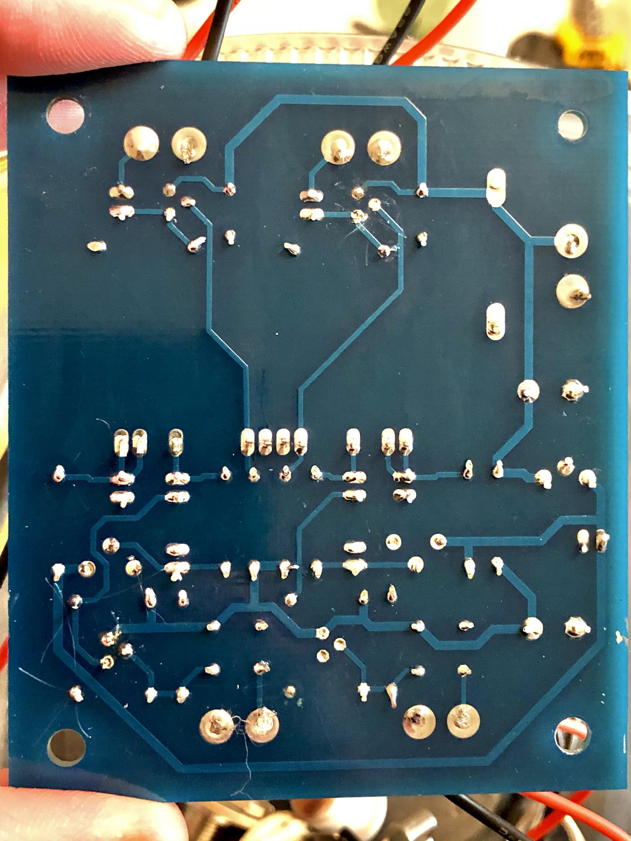

While I can see the schematic and the populated board before I commit myself I would like to see the actual copper runs on the reverse side .
At a guess and its a guess going by the components positions then the LEFT handside of =R8 & R9 when looking at the unpopulated picture and the diagram after that R8 is jumpered to the PLUS of C1 and R9 is jumpered to the PLUS of C8.
I hope you realise the consequences of the change of impedance by bypassing the fets used for impedance conversion to a much lower impedance output for driving a low impedance.
In other words what you are connecting the output to must have a higher INPUT impedance than the output impedance of the 6P1.
The buffers also help to isolate any fault condition from the tube but if that is what you want --so be it.

Hi Duncan,
To follow up from your request yesterday, here's a hi-res photo of the tracers on the back...

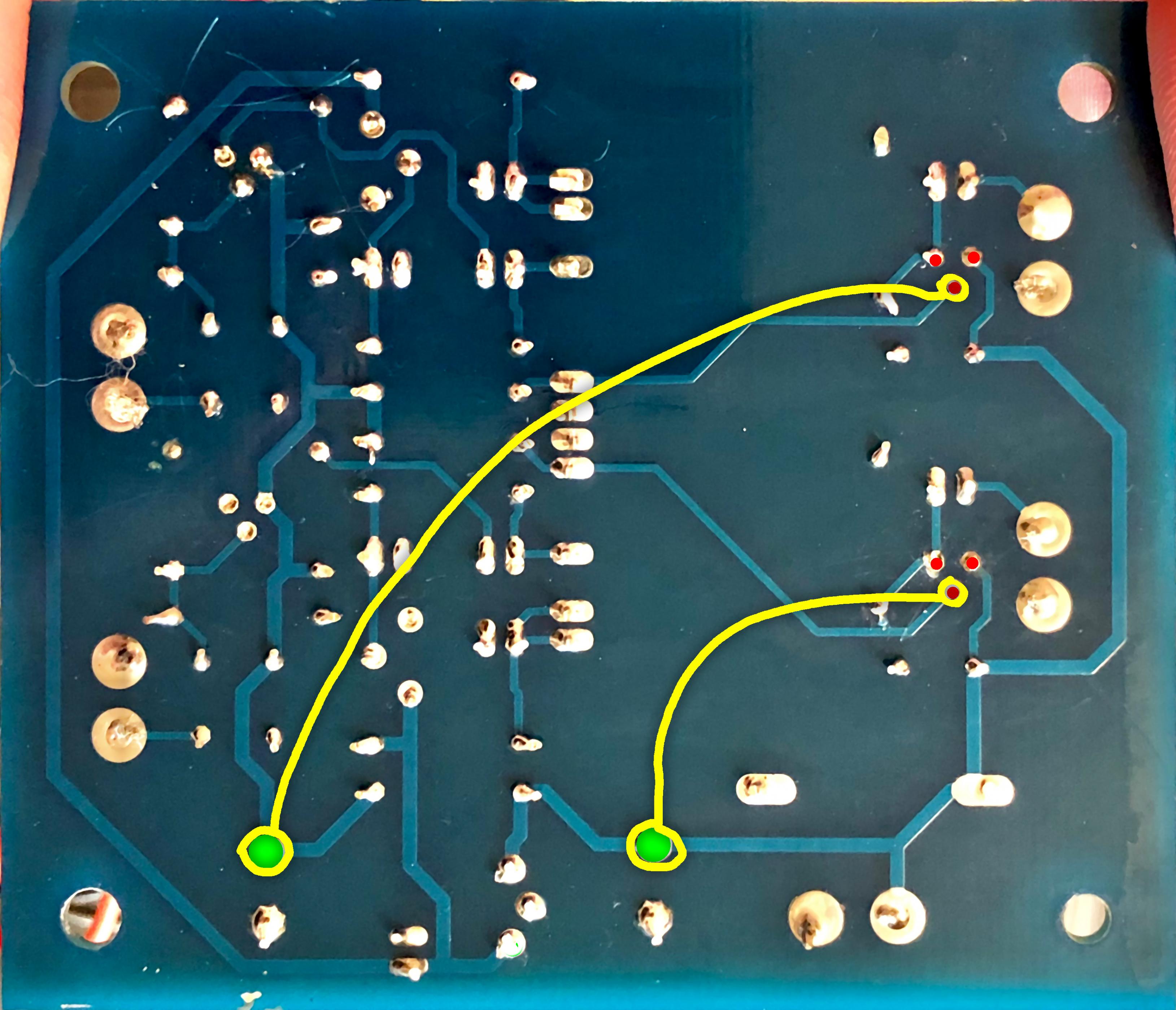

Yes Greatmagnet exactly as I said the two thin tracers going to the gates of the fets jumper them to the positives of each output capacitor .
Okay so I might be too dumb to know which pin on the fets are the gate pins (guessing middle), and I'm also guessing that the big electrolytics are the output caps specifically?
Check out my drawing below and tell me if the yellow lines are the right places to put the jumpers...
