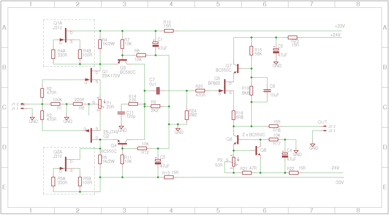

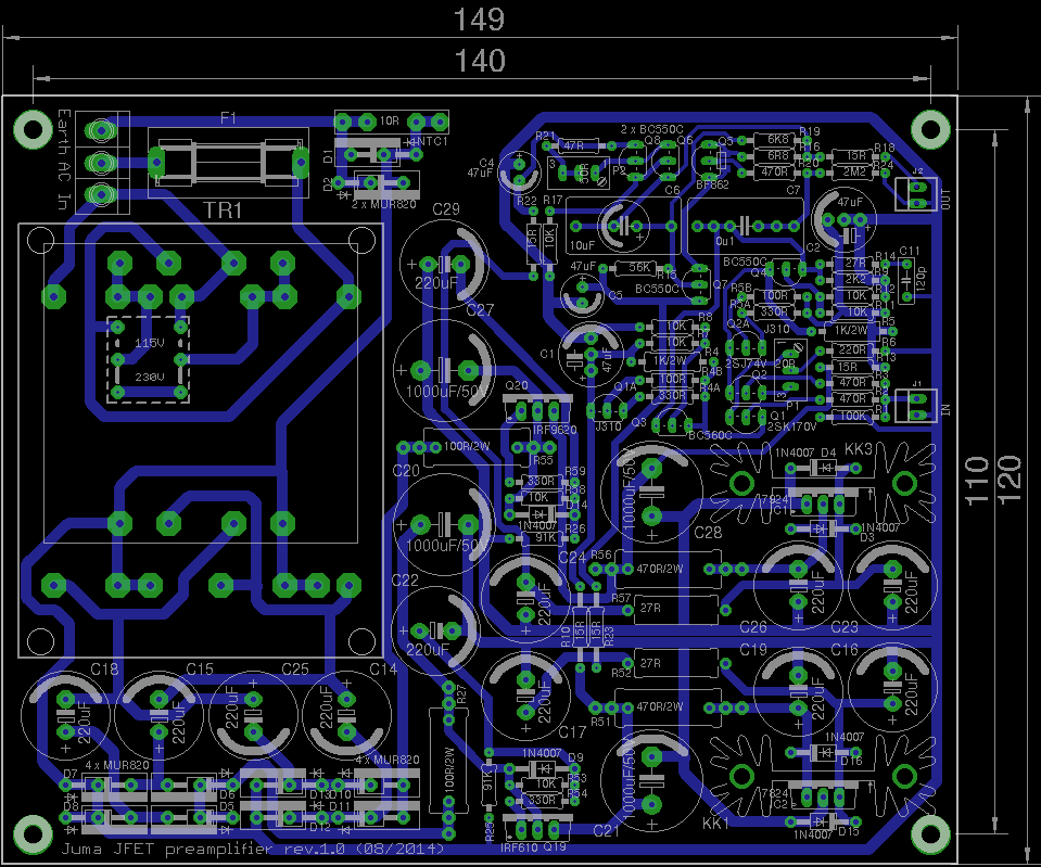

Please find in attachment suggestion for a new single channel PCB with PS and transformer included. It's just a little bit larger than the dual channel PCB and this one include pinout for Hammond 20VA transformer.

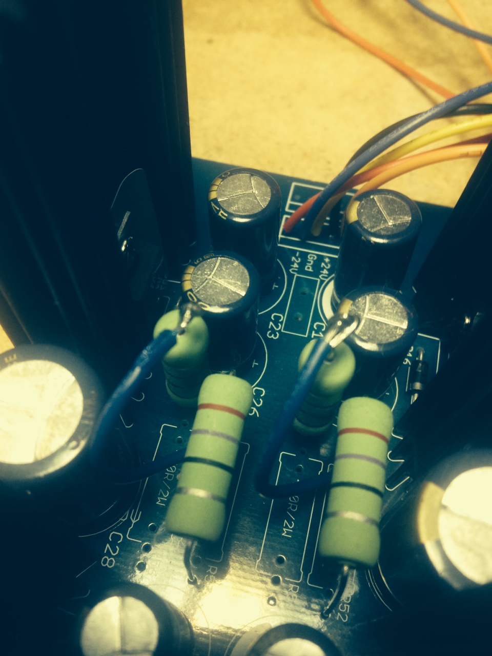

Folks:
I've run into a problem and feel like an idiot, and am wondering how others building the LSK have dealt with it. I purchased Block FL18/18 encapsulated transformers for my project, not recognizing that the 18 VAC secondaries would never be able to generate the +/-33 VDC required by the LSK preamp. Stoopid.
I'm now looking at swapping out the transformers and am considering Block's FL18/24 (18 watts, 24 VAC secondaries). The next higher voltage available is 30 VAC, which I suspect will be too high.
Has anyone come up with a better solution? I'm using Prasimix's boards.

Hm, that's strange since due to voltage doubler I had initially problem to be within a range of +/-37V that 7924 and 7824 regulators accept on input. The problem was fixed with adding an extra resistor as described in #217 in this thread. So no reason to feel like an idiot 🙂 Just check once again everything it should works fine as Juma promised and I can confirm.

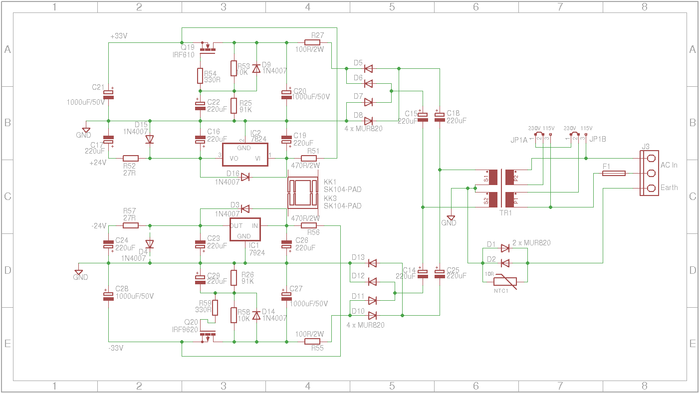

Folks:
Sorry for being so slow -- voltage doublers are new to me and I'm struggling to understand how they work and how adjust them. I am getting +/-23 to 24 VDC for the buffer stage on both single power supply boards, but roughly +/- 55 VDC for the input stage on both boards. These readings are with no load. The transformer is the Block FL 18/18 (18 VAC secondaries).
I don't understand why the input stage readings are so far off, when the buffer stage readings are on target. Is AndrewT's suggestion in post #211 (and prasimix's example in post #217) above the correct way to lower the input stage voltages down to the +/-33 VDC range?

Voltage doublers (and triplers, etc) are difficult for me too.
I have to look at the sch/diag to work out where the parts go, it's not in my head.
But a voltage doubler does not perform as well as a bridge rectifier. Using the same component values you will find that the voltage drop as current flows is very much higher.
eg.
an 18Vac transformer feeding a bridge followed by 2200uF (for 1Adc output) will drop from an open circuit ~26Vdc to ~23Vdc
A doubler with the same 2200uF and supplying 1A will drop from an open circuit ~52Vdc to 30Vdc to 40Vdc accompanied by at least double the ripple voltage. Even reducing the output current to 500mAdc will not get you back to 46Vdc (double the ~23Vdc).
Due to the very high ripple voltage on the output of the doubler, you must look at the minimum voltage at the bottom of the ripple @ the output current you plan to use.
You need an oscilloscope to do this.
If the regulator or multiplier drops out due to the extreme ripple, then you will get a drop out (short period, ~1ms to 3ms, drop in voltage) that repeats every cycle of the mains. This will seriously affect the performance of the front end of the amplifier (or whatever audio circuit is being supplied).

Folks:
More confusion at my end. I modified one of my LSK power supply pcbs as recommended by AndrewT and prasimix but got unexpected results. The modifications involved repositioning R51 and R56 and adding 91K one watt resistors across C22 and C29 (see the photos). Following the modification, the input stage readings remain at about +/-54VDC while the buffer stage readings dropped from +/-24VDC to 0VDC. I'm clearly headed in the wrong direction.
Can you help me pinpoint my mistake?

Try to leave R51 and R55 (100 ohm) to the original position but keep 91K resistors and see if that will improve the situation.
Are you referring back to the group of posts 208 to 219?
Are you modifying to match sch in post241?
Why 91k 1W?
P = V²/R
for 40V p=18mW
for 50V p=27mW
for 60V p=40mW
Why 91k 1W?
P = V²/R
for 40V p=18mW
for 50V p=27mW
for 60V p=40mW
prasimix:
R51 and R56 (both 470R 2W) were returned to their original positions and the buffer stage is back to +/-23 to 24VDC. Thank you!
Andrew:
I'm modifying to match posts 211 (yours) and 217 (prasimix). The reason for using 1 watt resistors is simple: I didn't have any 91k resistors on hand. A domestic source was selling inexpensive 1 watt versions. Low price, quick delivery -- who would complain?
All:
The input stage is still in the +/-54VDC range. Yes, the 91k resistors are in place across C22 and C29. How do you recommend getting the voltage down to +/-33 VDC?

prasimix:
All of the parts were sourced from Mouser and Allied Electronics, so I trust they're legitimate.
Q19 is an IRF610. Voltage readings to ground:
G = 54.5 vDC
D = 60.7 vDC
S = 51.7 vDC
Q20 is an IRF 9620. Voltage readings to ground:
G = 54.4 vDC
D = 60.6 vDC
S = 51.7 vDC
I verified the values and orientation of the following parts:
R27 & R55 (100R 2W)
C20 & C27 (1000uF 50v)
D9 & D14 (1N4007)
R53 & R58 (10k 0.6W)
R54 & R59 (330R 0.6W)
C22 & C29 (220uF 50v)
What readings would help diagnose this problem?
