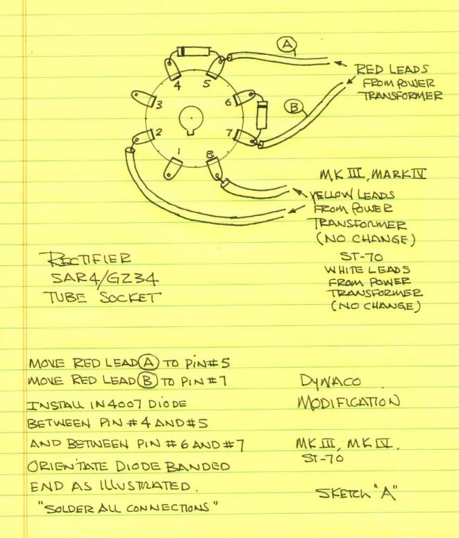

Post-choke capacitors don't cause the surge current in the rectifier tube, just the first one.
Adding the series 1N4007 diodes increases the tube's reverse breakdown voltage,
and prevents internal arcing.
If your capacitors are rated at under 525VDC, they will have very shortened lifetimes,
especially for the input capacitor. Bear in mind that sometimes the DC voltage will go
even higher, due to the AC line voltage surging.
I'm at a loss to understand what the added diodes do. They are rectifiers in series with the two rectifier sections in the tube. It looks like all the tube does is give a slow warm up. That could be implemented with a resistor-time-delay relay setup more reliably & cheaply.
Adding the series 1N4007 diodes increases the tube's effective reverse breakdown voltage,
and prevents internal arcing. They don't change the controlled warm-up time of the 5AR4,
nor do they reduce the DC voltage drop across the 5AR4 when it is conducting. They only
increase the reverse voltage capability of the circuit. These diodes were not necessary for
5AR4 tubes of 50 years ago like Mullards etc, but they seem to be necessary for many now.

I'll check the voltage ratings of the cap.
As for adding the diodes - it's can't hurt!

Thanks for the help Rayma. I added the diodes. The B+ is actually 450V. It's only 500V when there are no tubes in it. My bad.
If the rectifier fails in such a way that it shorts the AC voltage to the cathode, you have a problem. I believe this may have happened in my case since I lost at least one output tube. With the diode in place, however, that can't happen. I read somewhere that (theoretically) the rectifier can fail and you can keep on playing....
