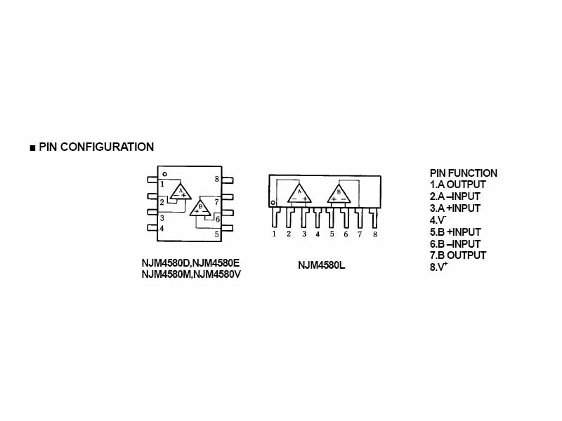

I have this Project audio mm/mc preamp that uses JRC 4580D opamps. Are they pin compatible with NE5532, OPA 2134 etc? I suspect so but could not find a spec sheet somewhere. I want to upgrade its sound. Which well known opamp pin out the 4580D follows?

Hi salas
Here's a datasheet from the 4580D.
http://www.njr.co.jp/pdf/ae/ae04056.pdf
here for the NE5532:
http://www.semiconductors.philips.com/acrobat/datasheets/NE_SE5532_A_SA5532_3.pdf
and here for the OPA2134:
http://www-s.ti.com/sc/ds/opa2134.pdf

Essentially all 8 pin dual opamps are pin compatible with each other. MC33078, NE5532, LM833 are some suitable replacements.
