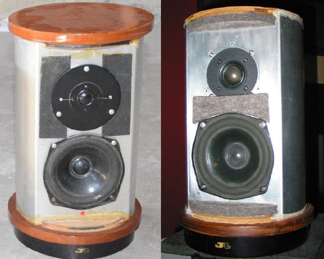

Hi Folks,
A different thread got onto the topic of the JR149, a vintage speaker meant to compete with the LS3/5A.
I modified a pair and thought I'd share the outcome and design process here, attached. It was a tough design journey, the B110 being an enigma of sorts.
It was an interesting trip, and made me really appreciate the challenges faced by designers of yesteryear working with suspicious drivers and scant CAD at their disposal. It helped me respect their accomplishments that much more.

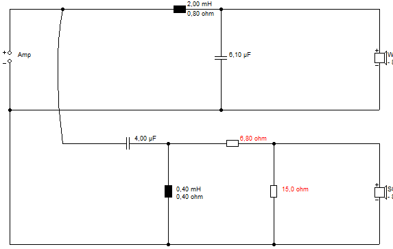

Very nice PDF articles on fitting the JR 149 with Scanspeak D2905-9300 tweeter, Dave. Enjoyed reading that. Much simpler filter. :)
There were two 5" bextrene KEF bass drivers, the original KEF B110A SP1003 used in the LS3/5A, and later smoother B110B SP1057 used in the KEF CS1. Not quite the same.
Thanks system7. The TS params were so off spec I couldn't tell which variant these used. :)
There were also two different versions of the JR crossover, the first with a parallel trap on the woofer (LS3/5A used one as well), and the "V2" crossover which made well enough without the trap.
I tried a few iterations of a trap based crossover as well, none provides a sense of accuracy and ease I had hoped for.
Sorry about the (lack of) schematic, I knew I'd get called out for that. :)

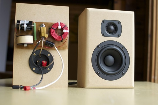

Regarding the W4-1720, I very much like that driver. Very detailed for a cone not made from metal. I just updated my design spec for another small two-way, this one using the W4-1720, at
http://www.diyaudio.com/forums/mult...y-punches-above-its-weight-4.html#post4218347
Hi freddi, I've designed allot of other stuff over the years but don't generally publish. It's a miracle to find time to publish these two designs. :)
I'm very equivocal about sophisticated filtering with difficult drivers. It's OK on paper, but I wonder how well it works with significant non-linearities. :confused:
Your Napoleons look fun:
I notice I made a complete *** of myself in saying the Tang Band W4-1720 4" Underhung Midbass Driver was a polycone. It's paper.
Your idea is not unlike Eekels' Mini
If you don't mind a slight lack of bass, this is a nice idea. Certainly a great midrange for vocals.
Thanks, they were fun, and the xovers were much simpler to get right than the JRs.
Mini? 4.8L, that's huuuge! ;) Actually, they look to me to have a somewhat different application. the napoleons were made for on wall and shelf application. The Mini has that rear port and long front/back application that's not well suited for that use.
The modest bass was a design parameter, it allows me to work in the evening at decent listening levels without someone pounding the floor above me. For daytime, a flick of the subwoofer switch takes me down to 30Hz.
They also respond very well to some gentle bass boost equalization (digital or analog) to provide some decent mid bass as that woofer can take a beating and not complain.

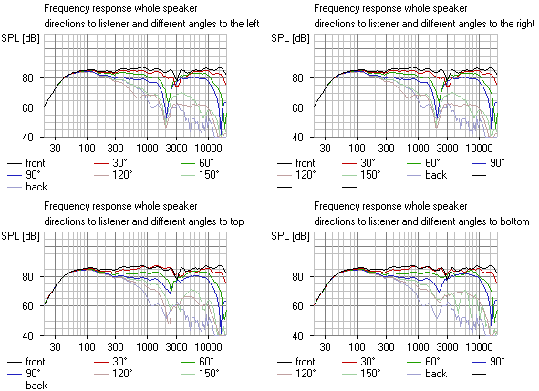

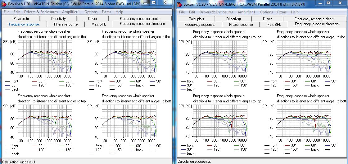

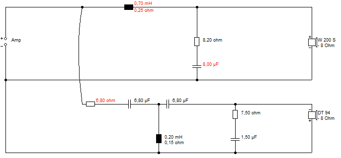

I still have fun with those old cone tweeters. Rather musical IMO. Here's the BW3 versus LR4 graph I should have posted originally. Look, no null above and below axis! :cool:

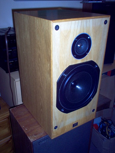

No flak from me, I totally get why a BW3 can sound better! Do you add some extra distance between the high and low pass frequencies to get it so flat? That works gangbusters IME. Get the good on axis and less of the weird upper woofer suck out of an LR type.
Ooh, whoops. I mislead you there. The dispersion is more with a Visaton DT-94 1" mylar tweeter IIRC. A cone isn't so wide at high frequency. This one I think:
8" bass and tweeter just happens to align nicely on phase if you wire the tweeter negative polarity on BW3. Which maybe why KEF and the BBC had such good fortune with it. One of my interests is what makes a tweeter sound good. I'd consider a cone, metal dome or an XT25 type ring radiator amongst the good common devices. Soft-domes just don't work above 7kHz IMO.
