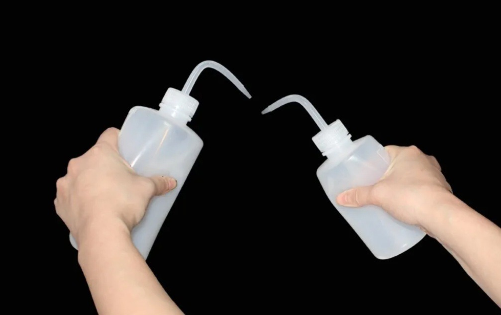

I've had fantastic results cleaning using 99% Isop. and a cheap ultrasonic toothbrush. I use a lot of Isopropyl to "wash" away the redisue after scubbing with the toothbrush. I put the alcohol I'm going to use for that cleaning session (usually quite a bit, say 4-5 oz) in a safety bottle so I can get some spray action going. Works really well. I use Kimwipes if needed, but usually a scrub and spray a few times over makes it all shinny and new looking.
[Edited: be sure you have good ventilation as that Isop is strong]
https://www.amazon.com/gp/aw/d/B07D6KZZQL?psc=1&ref=ppx_pop_mob_b_asin_title
I don't double fist though, maybe I should 😀
https://www.amazon.com/gp/aw/d/B097RFPPYT?psc=1&ref=ppx_pop_mob_b_asin_title
