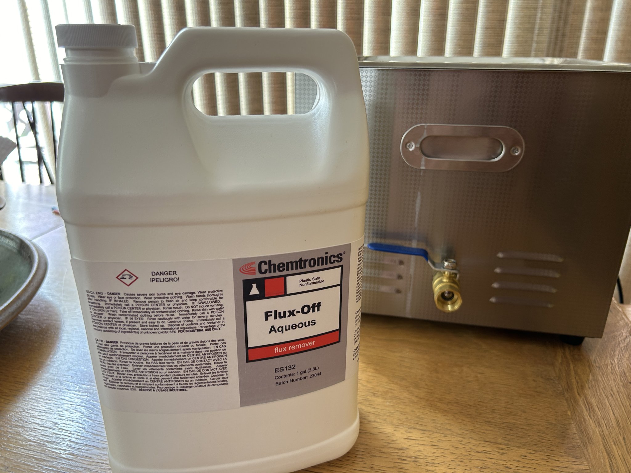

I've been using 99.9% IPA. Manual brush and a kids electric toothbrush (Paw Patrol!) and compressed air. And I have an ultrasonic cleaner when I really mean it, and feeling ambitious..

^ I like this method A LOT...I've been using 99.9% IPA. Manual brush and a kids electric toothbrush (Paw Patrol!) and compressed air. And I have an ultrasonic cleaner when I really mean it, and feeling ambitious..

"And I have an ultrasonic cleaner when I really mean it, and feeling ambitious..."
I've found this stuff particularly wonderful.... FWIW...
