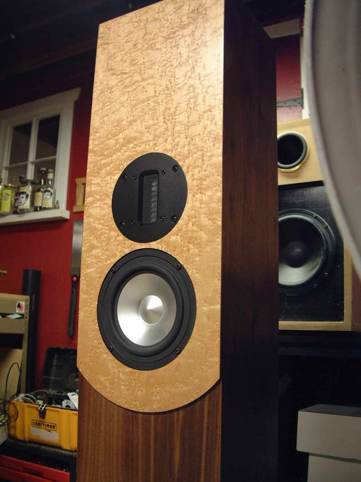

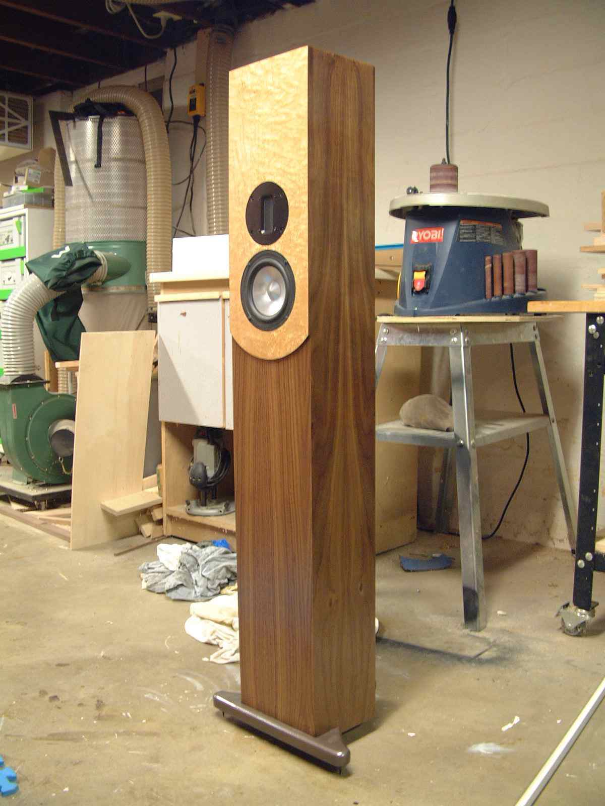

I’ve used my JX92S drivers in Jim’s minimonitor, GM’s 48” MLTL and added a ribbon using Jim’s xover. I built the MLTL with pentagonal cabinets which look good and have a clean sound due to lack of parallel sides. All have sounded great, but I sometimes long for a bit more air to be moving, - a little more weight on orchestral music.
After reading the JordanUSA site, I thought about the JX125s to replace my JX92s, but then remembered Jim’s bipole design for the FR125S plus WR125S., and I saw the other bipole designs by Planet 10 and others. I wondered if it it might be possible to integrate the JX125 into the JX92 MLTL. Because of the pentagonal shape it would be possible to have the125 firing into a corner (or even upwards.)
Is this a non-starter because of the differences beween the drivers?
Can I simply double the CSA of the MLTL since both drivers use the same CSA in the MJK worksheets on the JordanUSA site?
How much leeway do I have in the height in the MLTL at which I fit the JX125 given the height of the JX92 and the ribbon cannot be altered?
I am keen to keep the pentagonal shape and rebuild the cabinets since they sound and look nice, have a reasonable WAF, can be increased in CSA without looking too enormous and, lastly, I know what mistakes I made first time out and this time can get it all done to a better standard in half the time.
